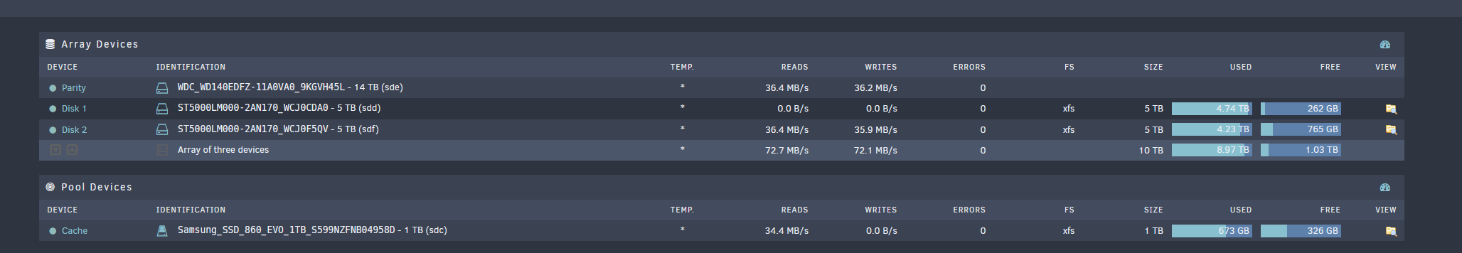

Mover is working extremely slow (30-35 MB/s)
Title says it all, but heres a picture.  I dont recall it doing this last week.  Ive done alot to my server tho so no idea whats going on?

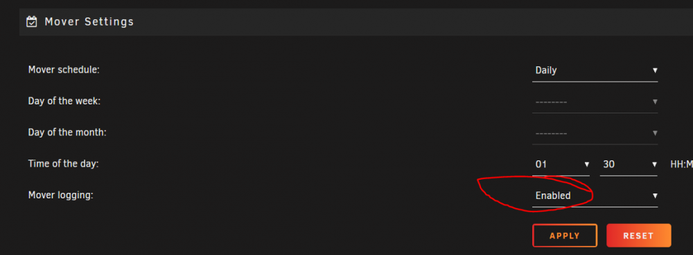

Ive read online other threads and people say to enable mover logging first, but where do I do that?
What kind/size of files are you moving ?

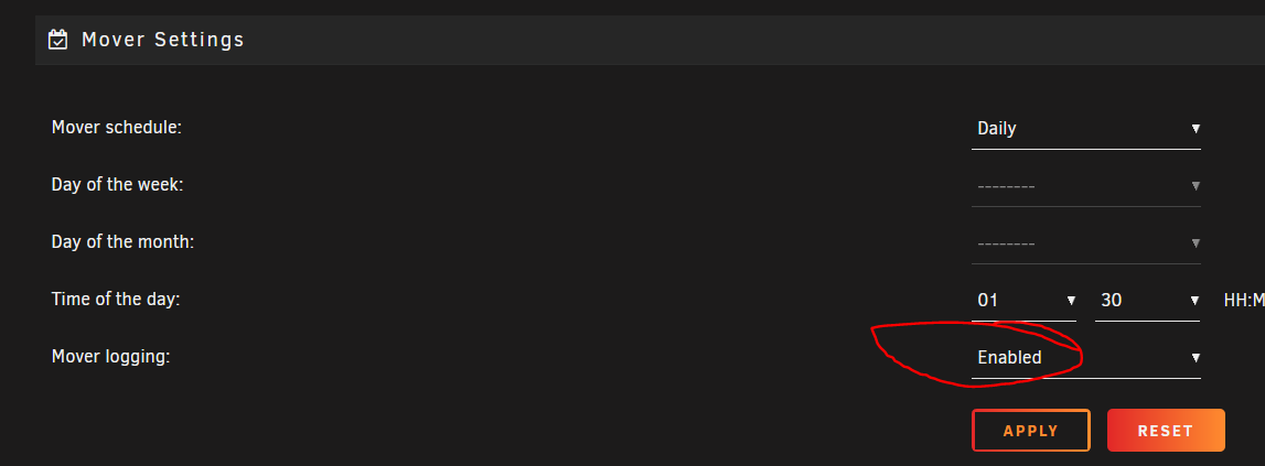

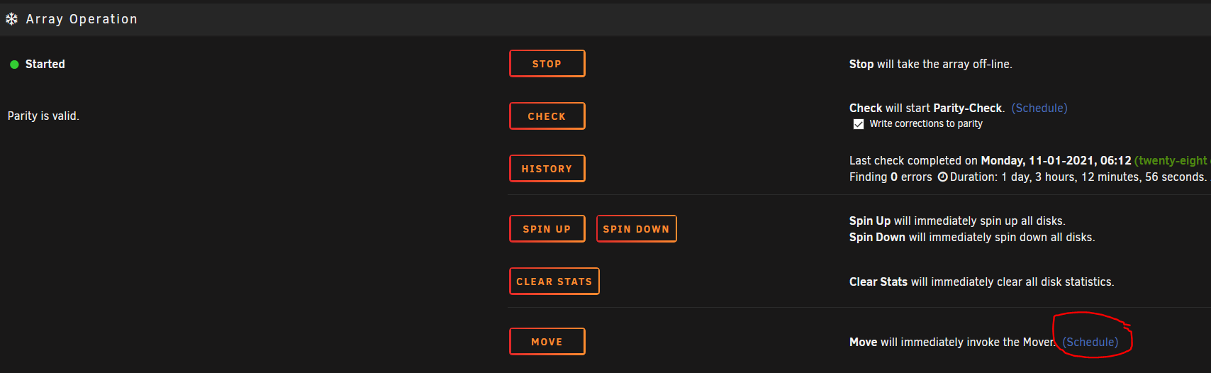

You can activate the Mover loging through the Scheduler.
Thanks I enabled the mover logging.  Not sure where to find the mover logs however?

Do you have Turbo write enabled?   If not then 30-35 MB/s is not that atypical for writing files to the parity protected array.
