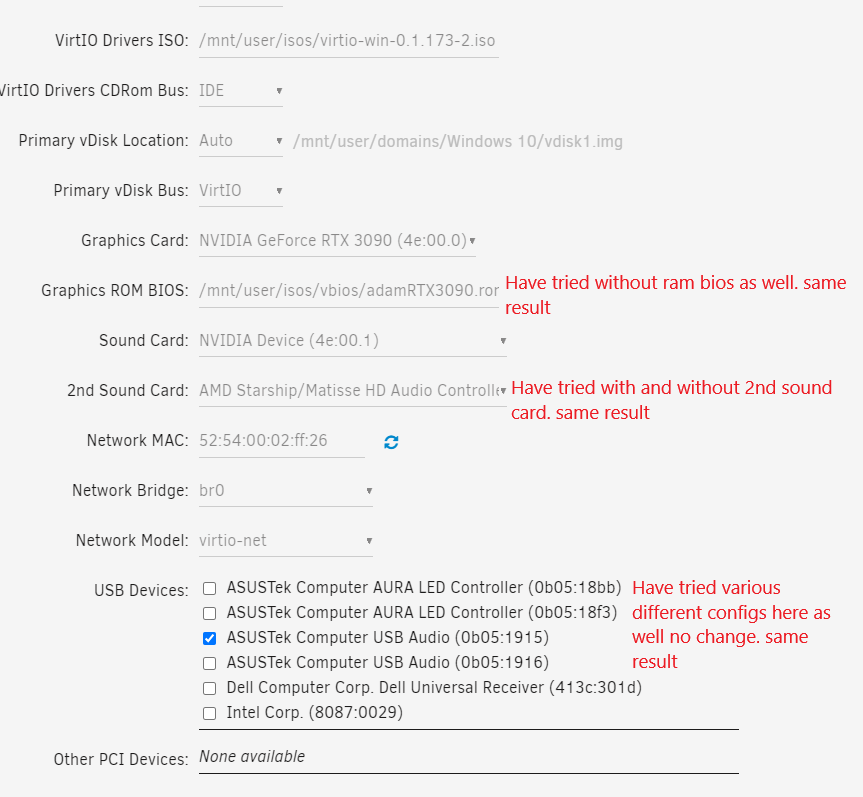

Having some issues i could use some help with.  I have created a win10 VM using spaceinvader's tutorial and it works perfectly using VNC  as the graphics card.   Then following his next tutorial i am attempting to passthrough my 3090 (which is my secondary card p2200 in first slot) but cannot get it to work. When i try and passthrough the 3090 the VM does not appear to actually boot - i cannot access it on splashtop and nothing displays on my monitor hooked to the 3090. When i start the VM with the 3090 passed through the logo on the 3090 will flash once and then stay lit - the monitor will flicker and stay on a black screen.  I have tried messing around with various settings but nothing seems to do the trick.  For Reference I am on 6.9.0-rc2 and i had installed the nvidia driver plugin to pass the p2200 through to plex (i have since deleted the plugin and am not passing through the p2200 to see if that would fix the vm issue, which it has not) . I wasnt sure what all would be needed to diagnose this so i thought i'd upload anything that might be of assistance.  Here is the XML of the VNC - VM that will work flawlessly VNC-VM-XML.txt  and the XML after i have passed through the 3090 3090-VM-XML.txt lastly here is a snipped of the GUI when i am attempting to passthrough the 3090.

I knew i was forgetting something when passing the GPU through again.  Watched the video and edited the XML - Still no luck. Nothing shows on attached monitor and cannot connect remotely.   Here is my current XML:
