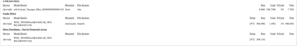

Smart report on my cache drive - the only drive to return any errors. I'm suspicious of this drive.

Thanks for your help. Off to work right now so I'll continue on the testing tonight. I did post a syslog from unMENU in my OP, but I was confused as to how useful they'd be, given they begin at "Feb  9 18:27:50 SERVER syslogd 1.4.1: restart.".

I've attached a screenshot of my unMenu main screen - I was confused by the sda and sda1 that exists there for the cache drive. Is this normal?
Yes, it is normal.
The three letter designation is the name of the device used to access the entire drive, including the master boot record.
The same three letter name with the number at the end is the name of the device used to access that partition (partition 1 in your case for sda1)  unRAID creates one partition on each of its drives.  Other systems might create more than one partition, in which case you would see /dev/sda1, /dev/sda2, etc...
Joe L.
Ok thanks.
