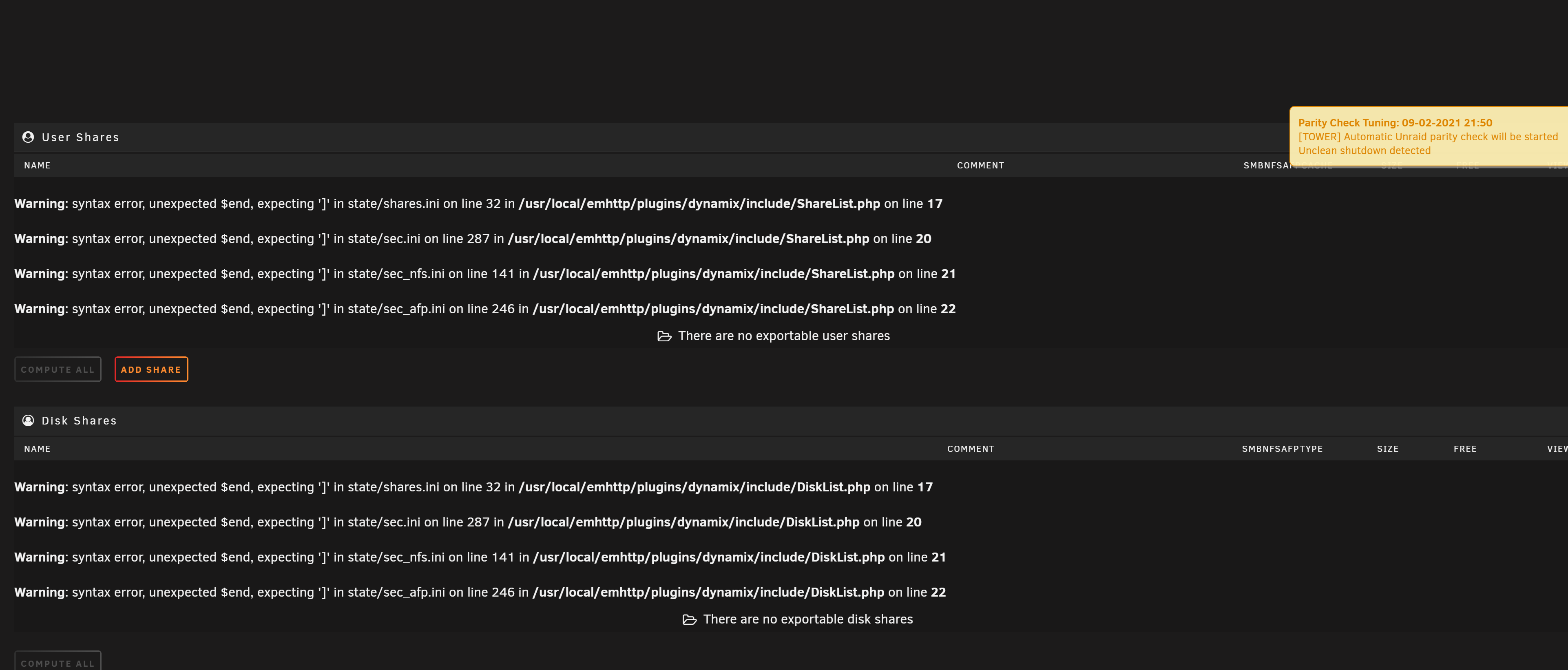

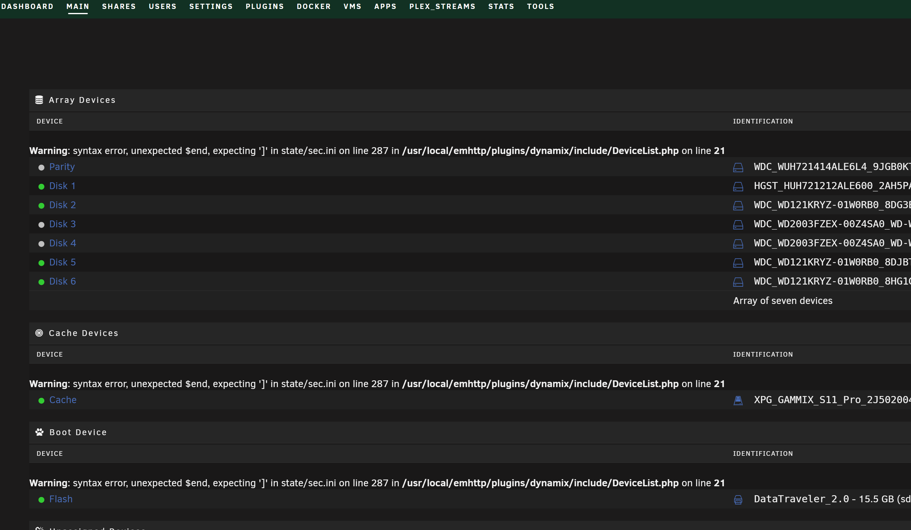

and then when i went to VMs    it was now broken
i get this error
Warning: syntax error, unexpected $end, expecting ']' in state/sec_afp.ini on line 246 in /usr/local/emhttp/plugins/dynamix/template.php on line 31

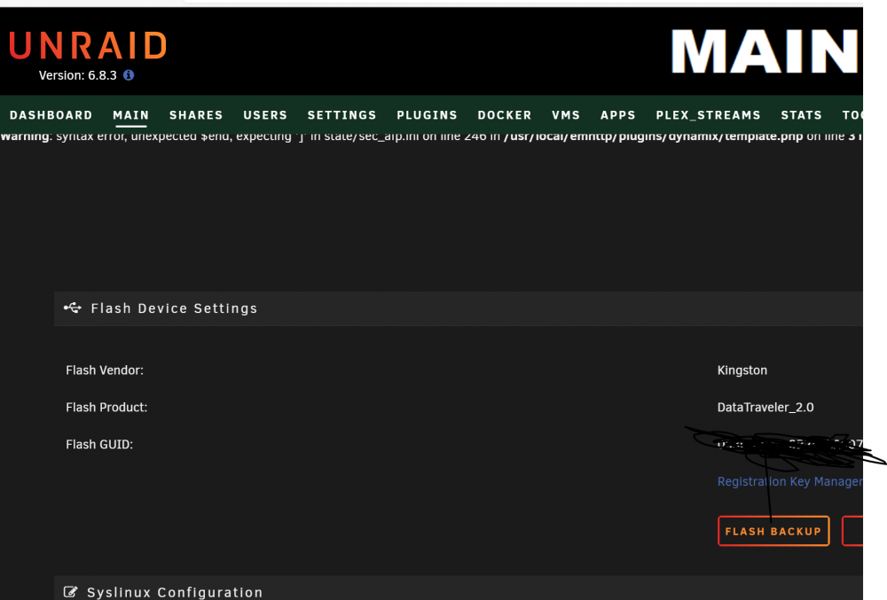

at bottom  Start Services  is flashing
i can not add a VM  i cant even do  Diagnostic  Zip file..  those icons show but un clickable

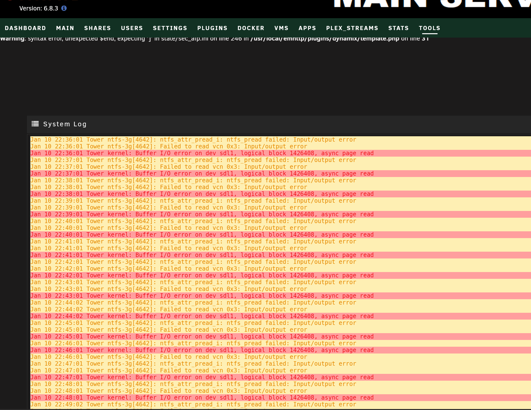

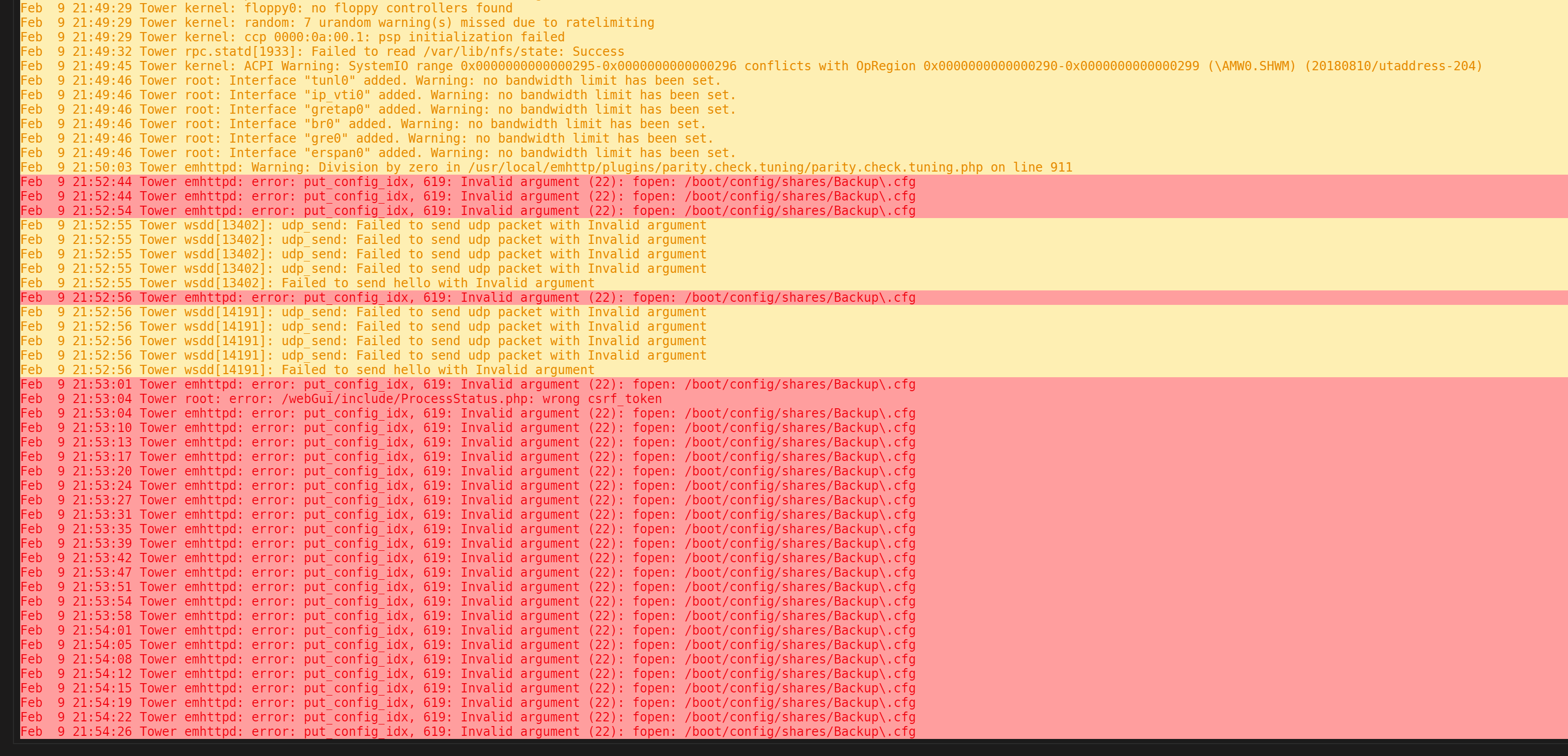

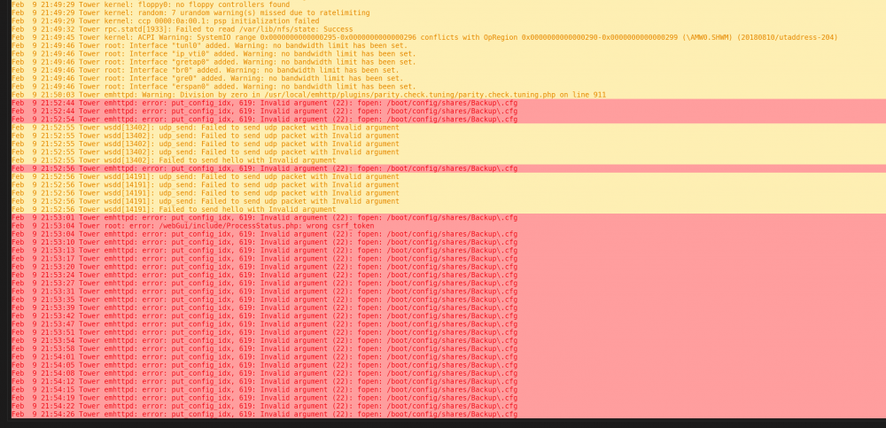

i was able to get a way to get a diagnostic file
i and syslog i see  of red and yellow  i guessing thats due to the UPS failing because its cold
but maybe you can see whats wrong
i made sure not to shut down  unraid till u guys say something...  is it the USB  faild i skimmed it  SDA1 SDA2 ?? what are those ones

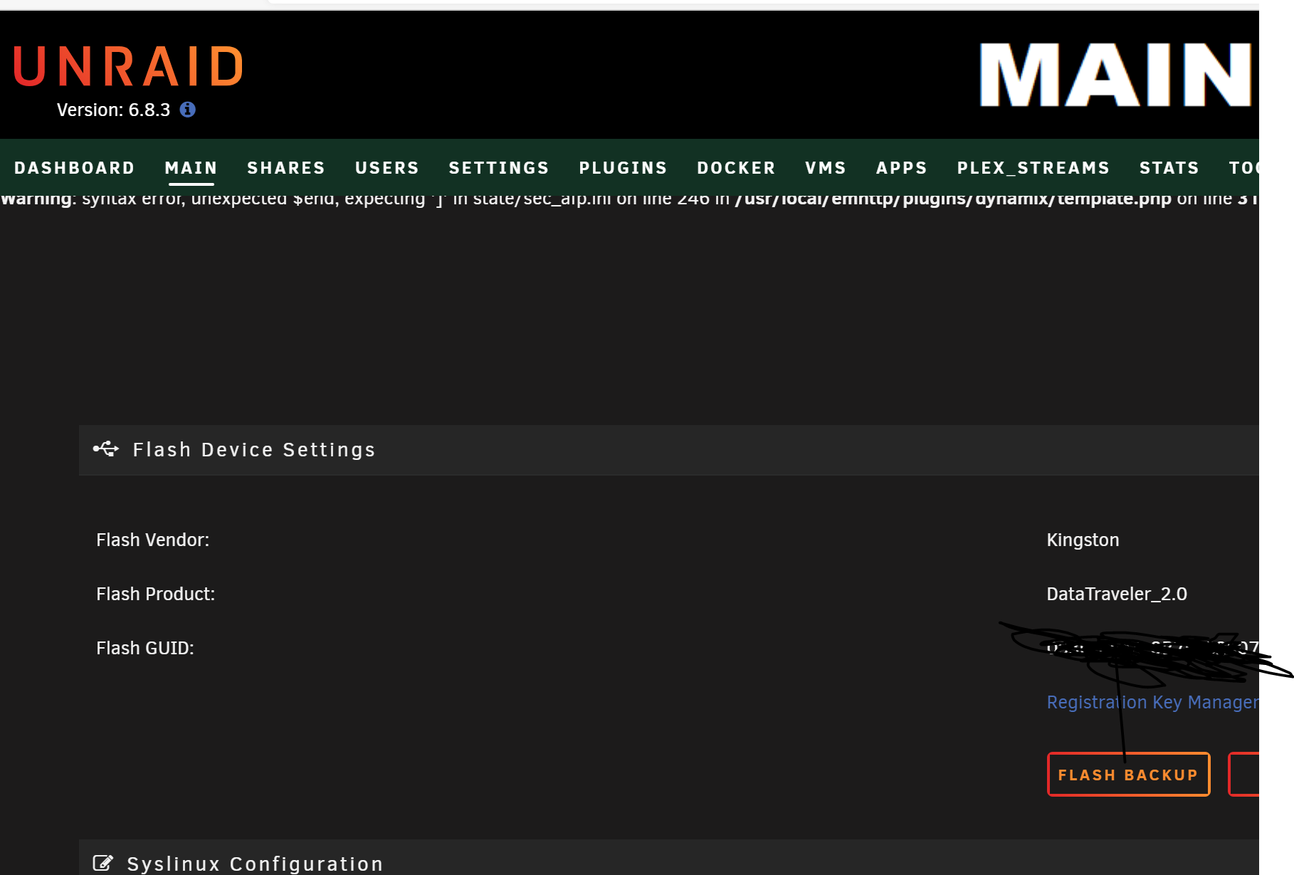

backing up flash Drive button is non clickable
