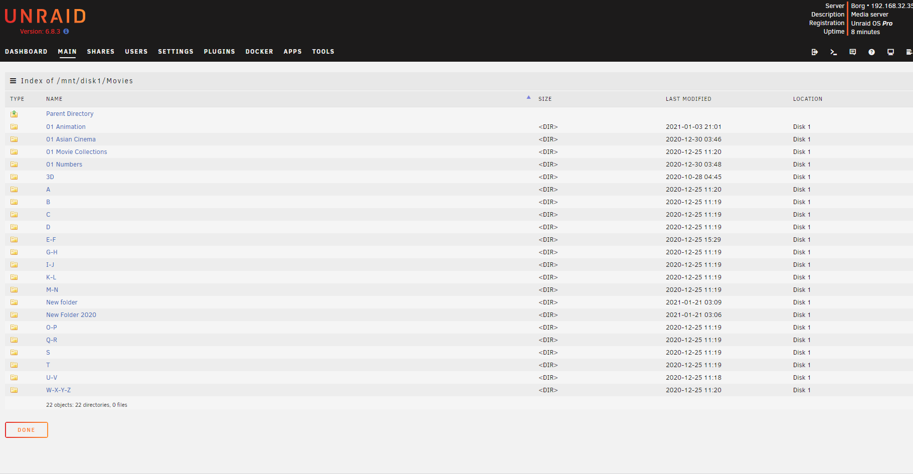

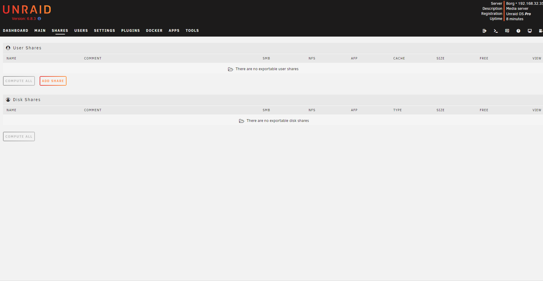

Hi there, as a start, I'm  total novice unraid. The kind that watch youtube videos, and jumped in the deep end. The server itself is made from old pc parts i have around with some new drives. For the past few months i've been having a few problems with drives disconnecting or Device is disabled, contents emulated error, but i just read and learn but lost quite a few files already. The problem occurred when one of my parity drive wend down along with another drive, and the power went out when i was rebuilding. I lost the contents of the drive. So did the procedure and rebuilt the array when i noticed all the shares are gone. I waited for the Parity-Check and rebuild to finish and did most of the solutions in the forum but none seem to work.
I know the files are there. When i check the drives, folders and files are present, but its not showing up in the user shares. I have rebooted a few times already and still nothing. Cant add a share, it gets deleted immediately. Ive removed the recycle bin app. whitelisted it on the ad blocker and virus scanner and firewall. and i know i get a metadata corruption error when i look at the screen when the server reboots.

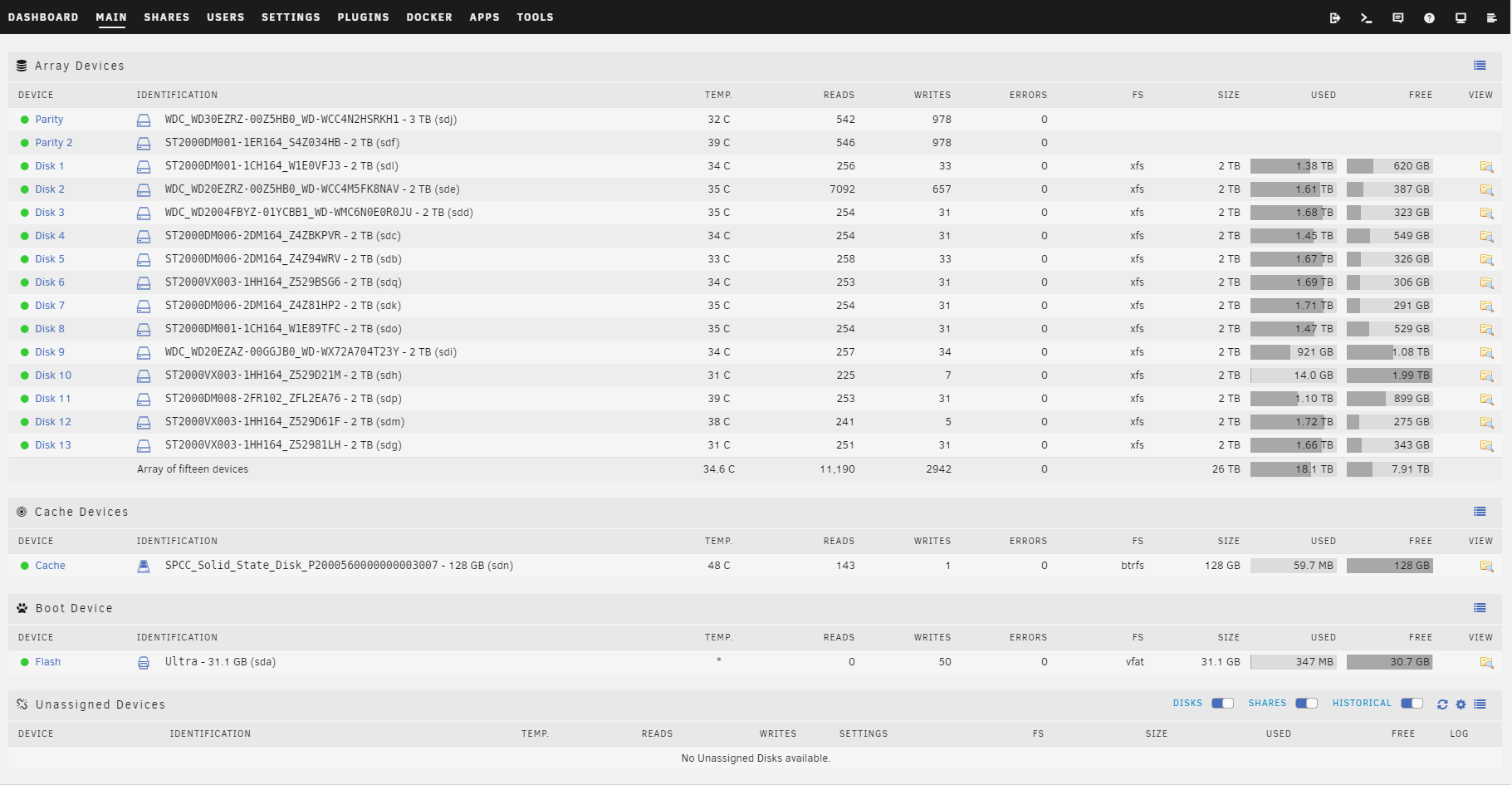

According to the syslog in the diagnostics you have file system level corruption on disk12.  You should run a file system check/repair on the drive.

I went to the link and tried to follow the guide but its a little hard for me to understand but i got that there is an error on my drive 12 and needed to run XFS_repair. Looked for guides to use it and was able to fix the drive. This helps a lot with the constant 'disabled' drives i keep getting.
