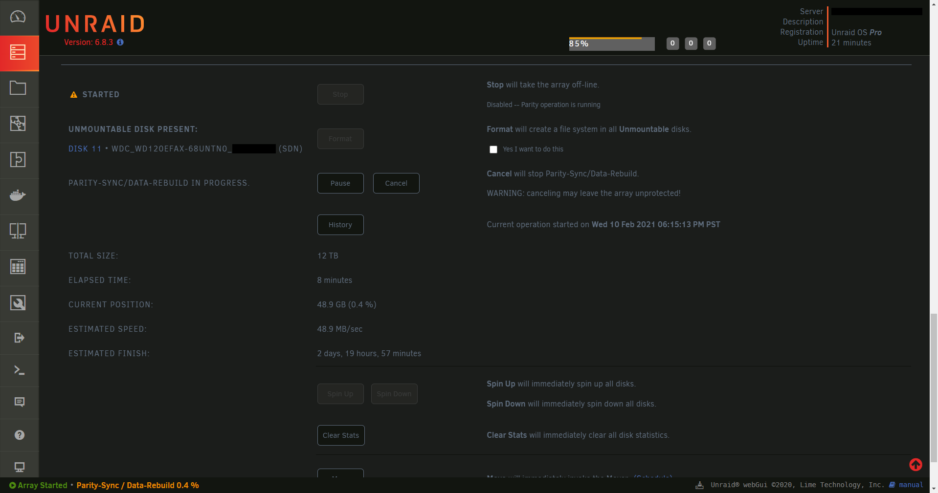

Go to Tools - Diagnostics and attach the complete Diagnostics ZIP file to your NEXT post in this thread.
Both disks dropped offline are reconnected with a different identifier, this is usually a connection/power problem, could also be controller/expander related.
So I need to troubleshoot all of my connections and maybe even my power supply. That said, it sounds like it may also be okay as is.
How would I reset the red X without replacing the drive that UnRaid disabled?
You can rebuild on top, if, and only if, the emulated disk is mounting and data looks correct, or do a new config and re-sync parity.
So I have two paths: Trust the disk's data (new config/re-sync parity) or trust the drive's condition (rebuild on top).
Regardless of which option I go with, if another drive goes bad during either operation, I will lose the contents of both drives.
If I go with rebuilding on top, would it be better to preclear the disk first? Is there any other way to validate the drive's condition?
Third option, rebuild on a totally different drive and keep the dropped drive intact.
True, but if you use a new drive to rebuild on, at least you still have some hope of possible recovery from the excluded drive.

I'm confused now. I chose to pull the drive that had the write error and replace it with my hot spare.
When I started the array, as the drives were mounting, the new drive came up as Unmountable, though the rebuild is still happening.
I haven't done anything with the original drive that had the read error.
I have a bad feeling that the rebuild will result in an empty drive. Can you help me find out what's going on? Do I still have an opportunity to save that data?
  • elecgnosis changed the title to One Drive Write/Read Errors, One Drive Read Errors, One Parity Drive
I was able to mount the drive with the write error as an unassigned device. I am still able to access its files.
I'm looking at this similar topic, and I think I understand the problem better: While there may not have been any mechanical failure or damage in the drive, its BTRFS filesystem was somehow corrupted?
So, even after rebuilding, I will need to repair the file system on the new drive by using the Scrub command?
post new diagnostics
Filesystem on the emulated disk is corrupt, best bet is to resync parity with all the original drives.
I put the original disk 11 back in the array. I set a new config with the same drive assignments. I started the array.
Disk 11 still comes up as unmountable/no file system even though when I had it mounted in unassigned devices, all of the data was there.
Not sure what to do now. Am I hosed?
diagnostics-20210211-0101.zip
I had physically removed the original disk 11, but I didn't reassign it to the disk 11 slot. The hot spare was still in its slot when I did the new config.
I reassigned it to slot 11, did another new config, and started up the array. Parity is resyncing. Everything seems to be fine now.
