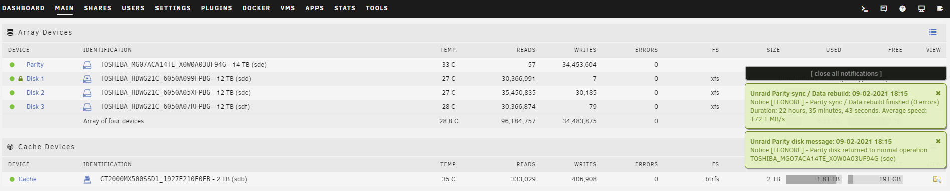

Screenshot below is an old Chrome window that was still open, where you can see the writes on the Parity and the message parity/the system came up with.

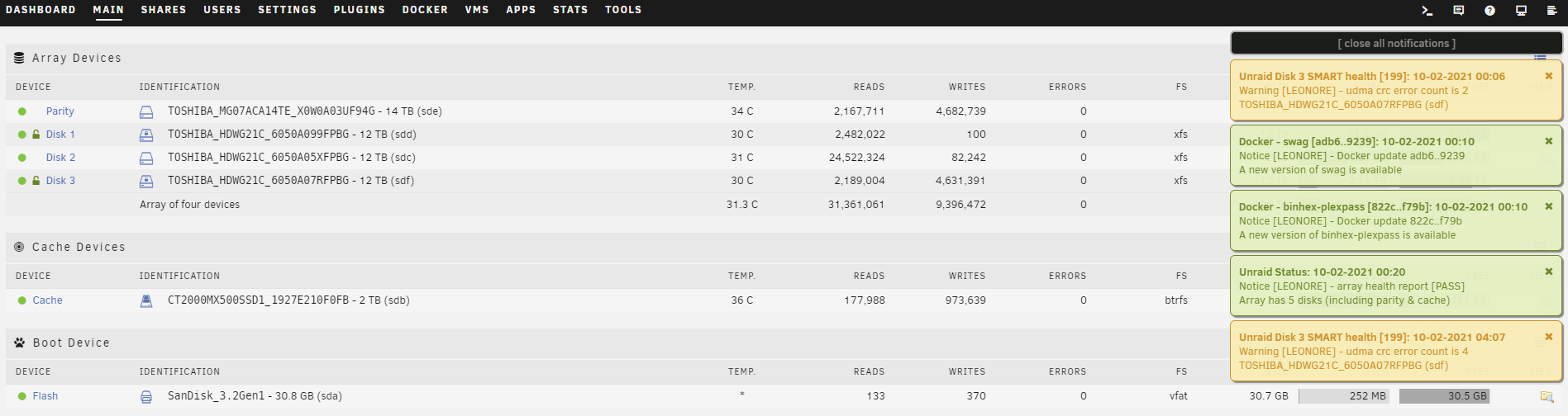

This is the screen right now : - not sure what the warning messages are though.
