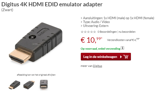

Update: Found a dongle that works!
Brand: Digitus
Type: RDVZ0O
Worked out off the box, but also has the ability to clone the EDID from an existing screen/TV/Projector ...
