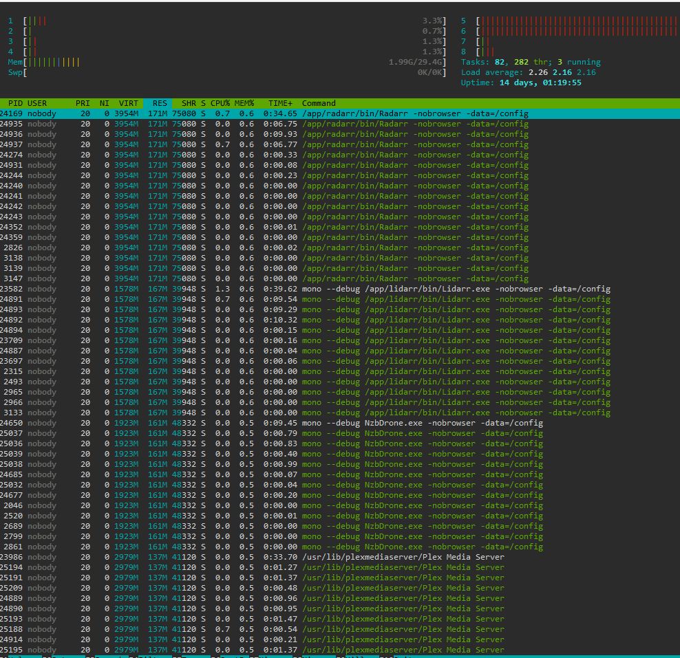

Since updating the motherboard (MSI mortar) and CPU (AMD Ryzen 5 3200) I have constant 100% usage on two cores, I have tried htop and top on terminal but I am not experienced enough to tell what is going on.
Even with no dockers running and no VMs running two cores or threads 100% - I am really stuck and have been for months and am considering hiring somebody to sort this for me as its puching me over the edge.

What system on your network has IP address ending in 222?  I see nginx is rate limiting that client from connecting for some reason.  Curious if you have a rogue machine on the network just hammering your server.
Hi
Thanks for reply, that is my current PC, from which I access dashboard and watch content sometime.

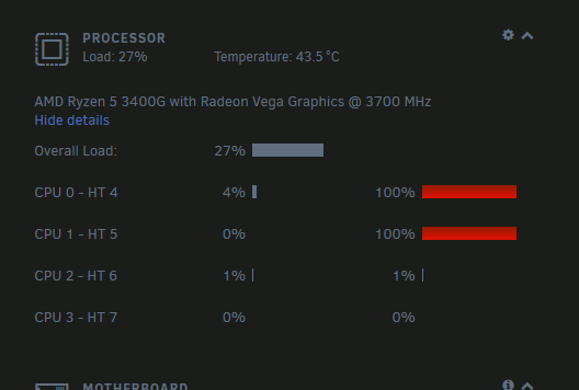

Are your CPU cores still pinned @ 100% if the array is stopped?
Hi
Thank you for your help, yes they are.

What does htop look like when array is stopped ?
It sounds like a similar issue to the bug report I posted, especially as you are on 6.9 also.

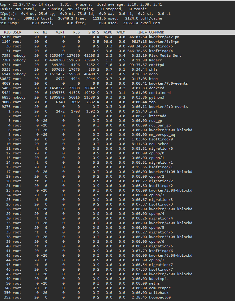

Looking in HTOP and logs I can see that system is trying to run a lidarr.exe file from appdata not sure if this is it but not sure how to stop that.

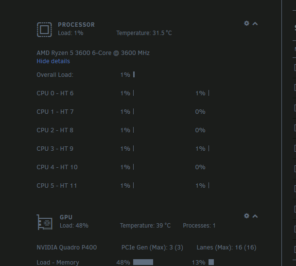

*update* bought new CPU and everything back to the way it should be. I am guessing that because previous CPU was a G model (can use on board graphics) and this one is not then that must have been the issue, although happy to be corrected.
Thanks
K
Edited by keymaster
added pic

I'm having this same problem with my 3400g right now. I'm assuming that it's not a coincidence. I could switch it out for a 2600x but I'd hope it would just get fixed.
Hi
Switch it out and issue will be gone 100%
