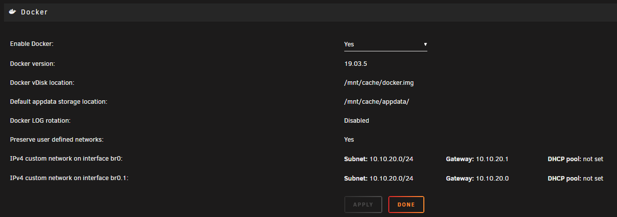

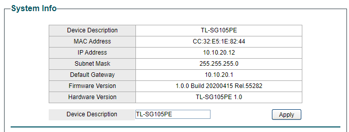

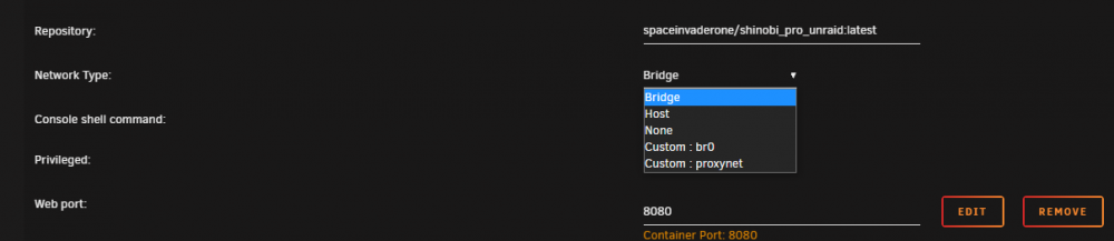

I'm following Space Invader's guide on setting up Shinobi. I have a TP-Link TL-SG105PE 5 port managed POE switch installed between my router/modem combo and my Unraid server. I have one PoE camera connected to that switch. I enabled VLAN on the switch (VLAN #1), added the VLAN in Unraid network settings, enabled it in Docker settings, but when the VLAN doesn't show up in the Network Type field in the Docker config. I'm not sure what I'm doing wrong.
Network Settings:
Config:

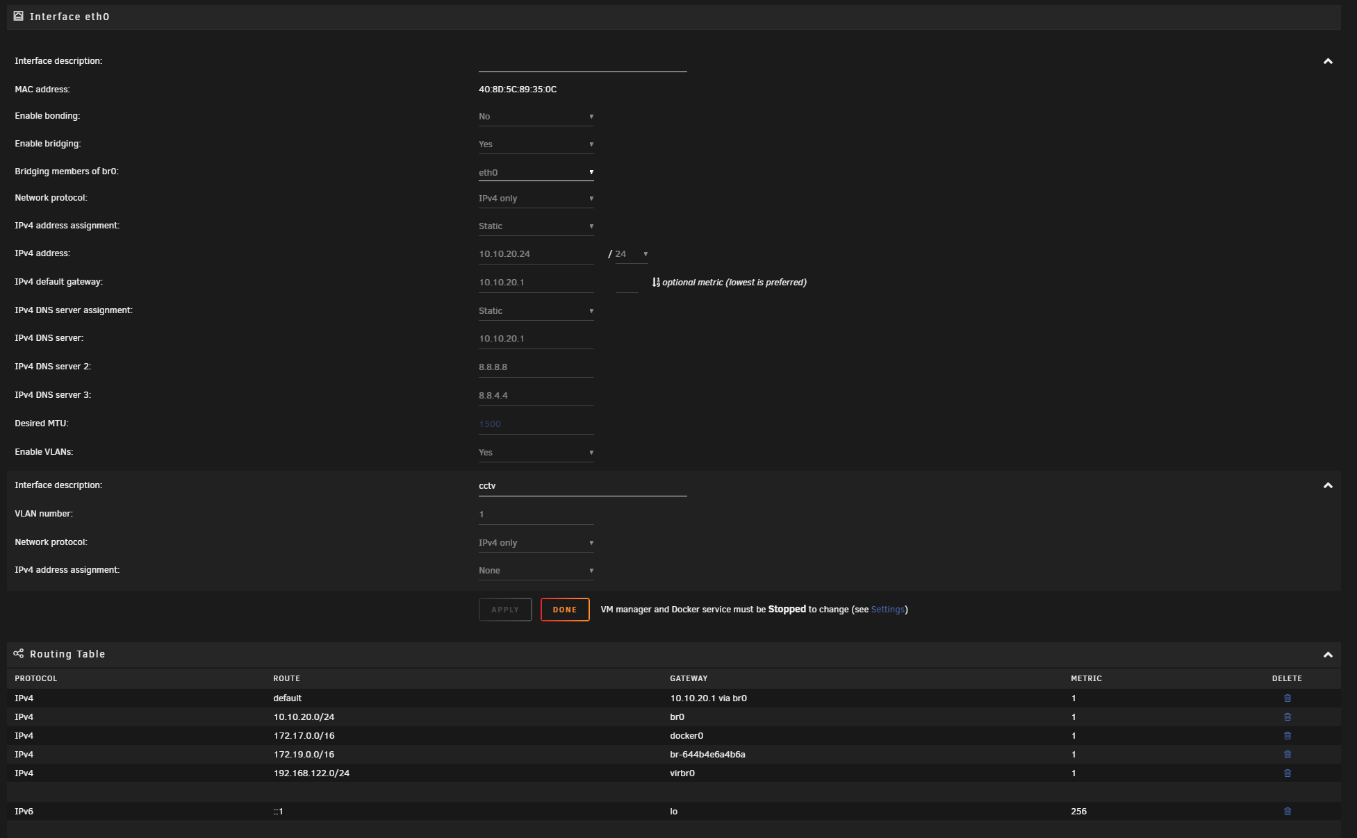

This is what I have right now.
modem -> router -> managed poe switch
   ->VLAN 1 ports: 1(unraid) + 2(router) +3-9(rest of home network)
   ->VLAN 2 ports: 1(unrad) + 10, 11, 12, 13, 14, 15(cctv)

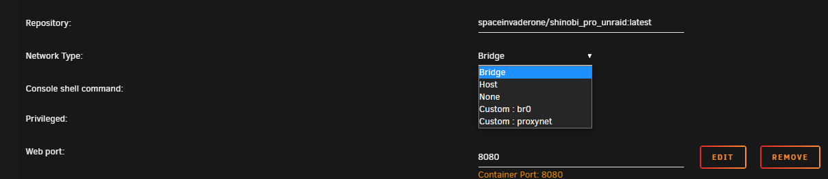

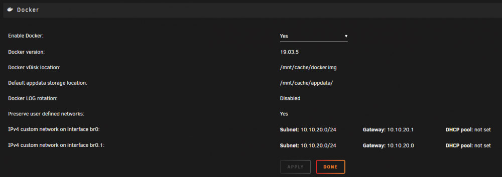

I have two ethernet ports on motherboard on unraid. only using eth0, however I Could run a seperate ethernet connection to the switch on vlan 2 and remove unraid from vlan 2 if that is easier. Right now I have enabled vlan on eth0 in network settings and set it to VLAN 2, not sure if should be ip assignment none, automatic, or static? When set to none bro.2 appears in shinobi docker however can never connect to webgui when shinobi is running on this network type.
