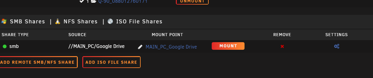

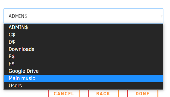

Hi @Cpt. Chaz following our discussion on your excellent you tube video on remote share with google drive. Here is a little more info, i can see the shares
But wont mount
Any suggestions

Hi @coblck! Thanks for your kind words. As for your issue, now that I can see a little more, my first idea for troubleshooting this would be to see if you can mount one of the other folders listed on that same machine ie Downloads. If you can map it and mount it, that at least narrows the problem down specifically to the google drive folder.
if you cannot mount one of the other folders, that would tell us it’s a broader networking issue. Hopefully doing this will make the answer more clear to us, and if we still hit a wall we can link over to the UAD support thread with your logs and let dlandon take a look. Keep us posted!

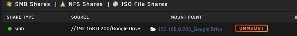

Hi ive tried mounting all shares and none work 😒, but ive managed to get it to work if i put in ip address on my pc and share mounts ok then.  Ive followed the rest of the video and rsync backup fine, im backing up the plex data as shown from your other video to my G drive now as well so i have an off site copy.

Nothing wrong with using the IP address! Glad you got it working and are enjoying the videos. Cheers!
I have same problem when I add smb share NAME of  my main comp, then unraid can't mount it (can't find the adress of this name) only working when IP adress inserted instead of name.
