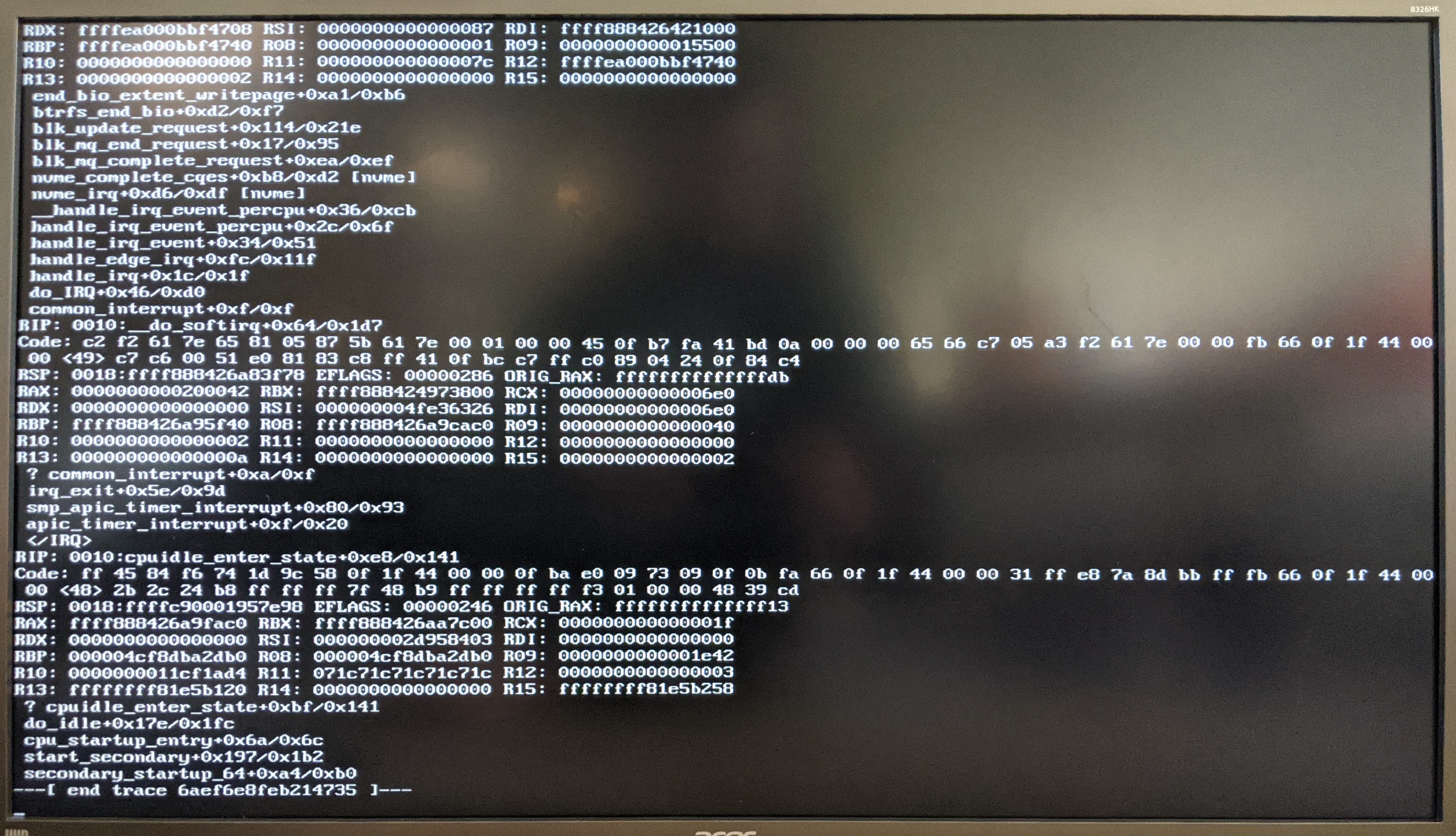

Based on other threads I've seen for other issues I've tried plugging a monitor + KB into the server afterwards to try and reboot via command prompt, however nothing comes up ever comes up (blank screen with no signal).  After having the same issue 3-4 times with the same result I finally had the thought to plug the monitor in before I boot up to see if for some reason that made a difference.  Recently when the network went down, I plugged my monitor back in and found that there was some code displayed, but the server was unresponsive to keyboard input.  I've attached a photo of what was visible.
I'm on with my network issue, but I'm totally at a loss of what might be happening with unraid.  Is this just normal behavior?  Are there settings I could check?  Even if someone can give me guidance on what to search for to find answers I'll happily continue my research on my own.  I really appreciate any guidance anyone could provide!

I had not tried upgrading because the server was crashing, and I was on the hunt for a flash drive that I finally found to run the memtest.  First pass looks like I have a bad stick of RAM which is both a bummer and a relief.  I'm letting the test run for awhile longer to be sure that was the only issue, but when I ran it initially it stopped the test early because of the volume of errors (10k+) which feels like a likely smoking gun?  Not sure what caused it to degrade so quickly, and I have no idea if that would attribute to my original issue, but fingers crossed.
