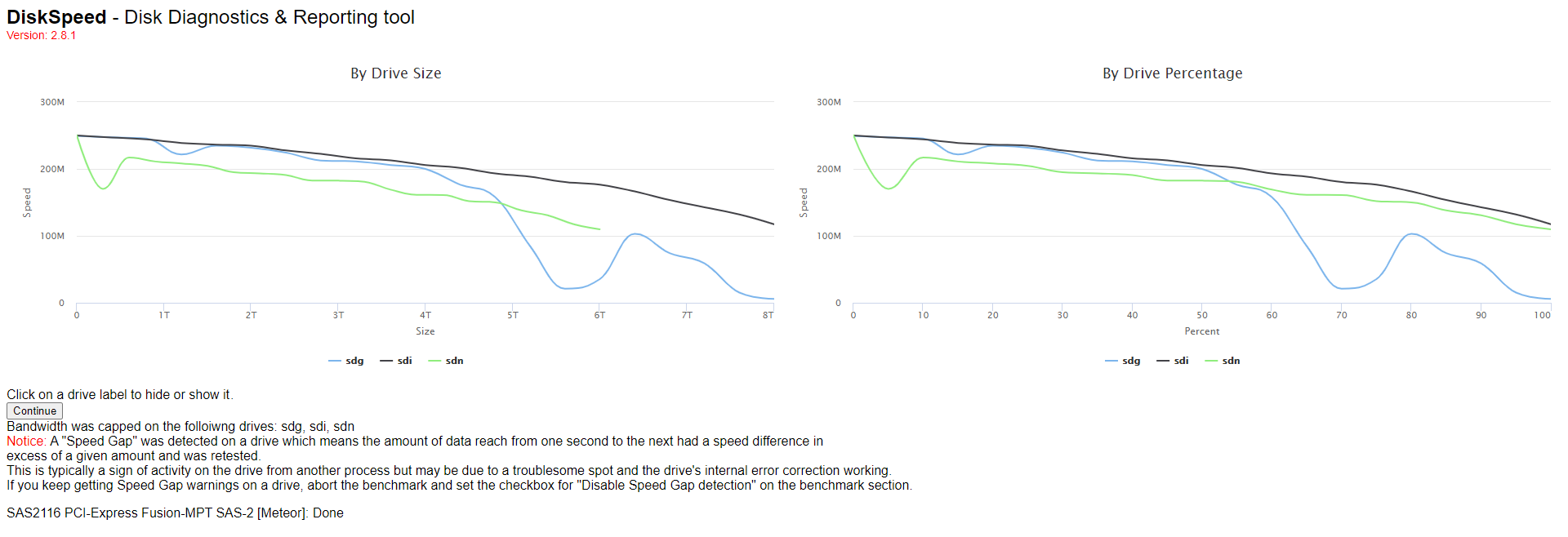

After the preclear is done run the diskspeed docker.
SDG and SDI are identical disks both brand new 8TB drives
sgd has issues, doesn't mean it's going to fail soon but it's not performing normally, also more likely that in time those slow sector will result in bad sectors, if you can return and get a new one I would.
Ok, no worries. They're still under warranty so will contact manufacturer to arrange a replacement.
