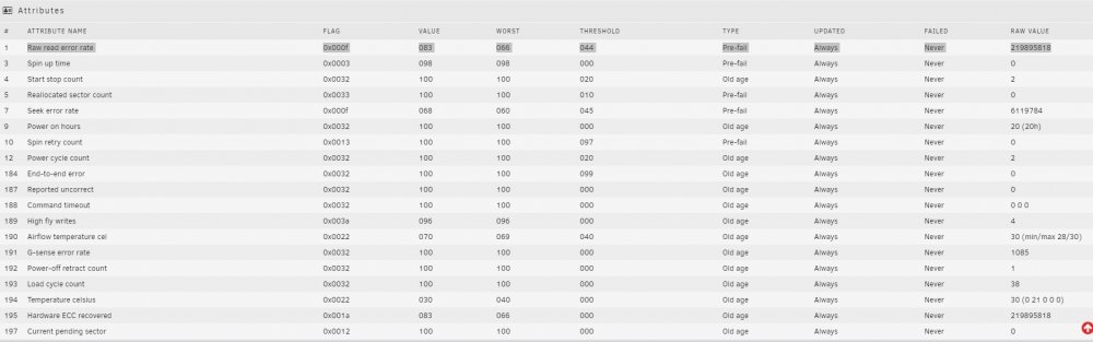

very high raw read rate error common in reconstruction?
Is a very high raw read rate error common in reconstruction? I haven't been here after a failure so any help would be awesome.
thank loads,
Ice
mediaserver1-syslog-20210212-2004.zip
Edited by icedragonslair
You should post your complete diagnostics.zip file, not just the syslog
BUT, presumably from having to tear through the syslog your screenshot is from the parity drive, in which case that particular attribute is normal on a Seagate drive since it reports it differently than your data drives (WD)

Seagates report Raw Error Rate differently than WD, and a non zero (and very high) number in there is quite normal.
