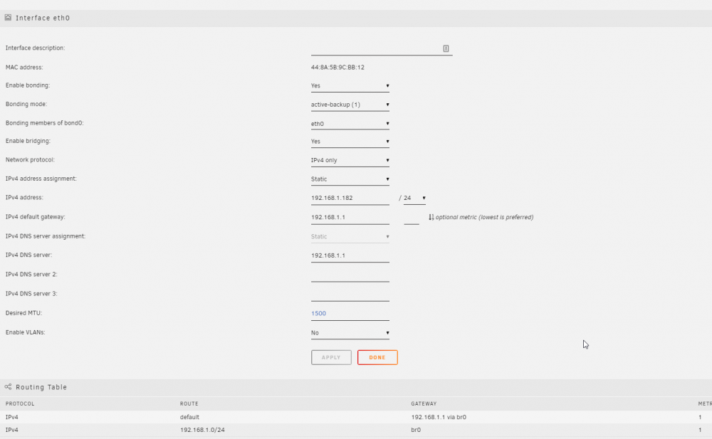

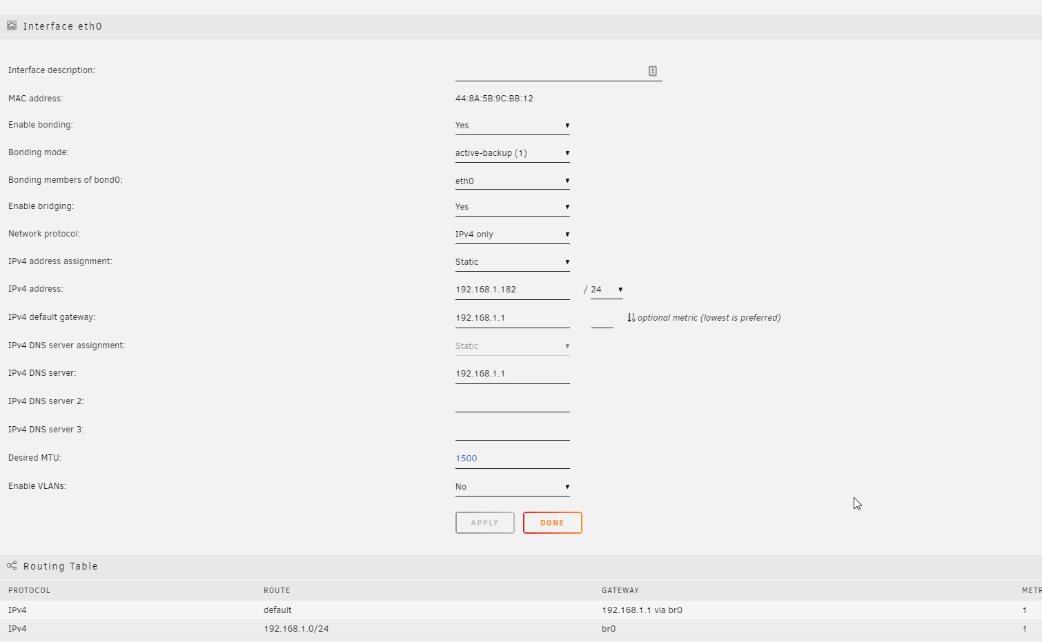

Same thing. It was set static in the past before the IP change.image.thumb.png.45b8b7bdc448a5500f456004eda36507.pngimage.png.1de9076a42baa179172032d172a97642.png
Try setting the DNS server 1 to 1.1.1.1 ,server 2 to 1.0.0.1 and server 3 to 192.168.1.1
Nothing, same result.
