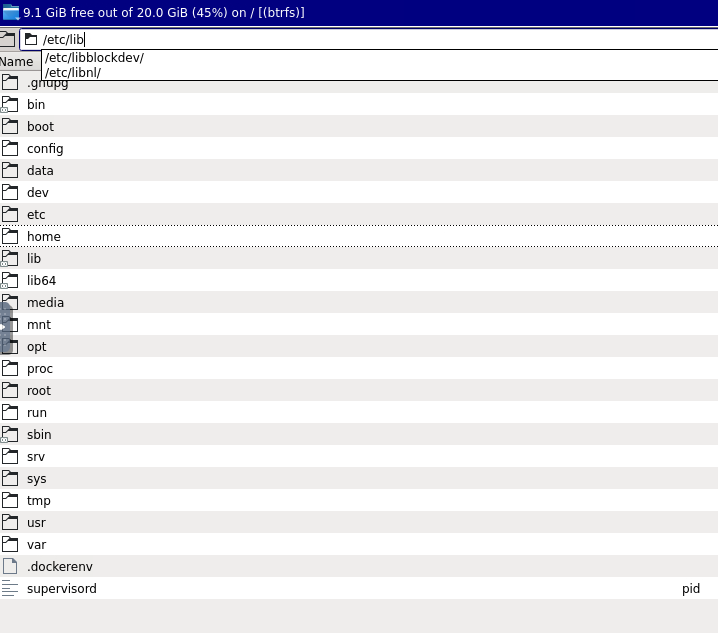

I read that the files I want are mounted in /etc/libvirt/qemu but I guess that happens if you enable VMs because I don't see that path using komander.

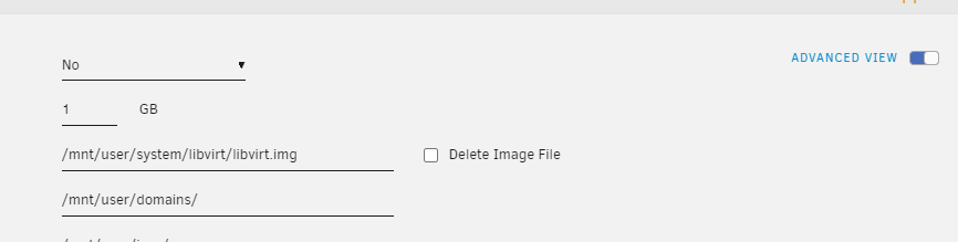

Sigh I can't believe I missed this: image.png.294d0f3ea4aa0a79a4085ace4afdf1d7.png
Problem fixed!
