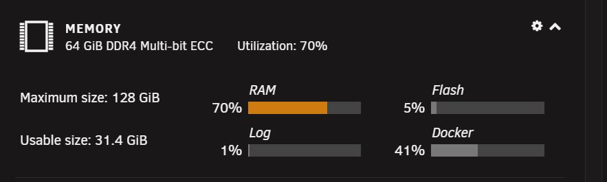

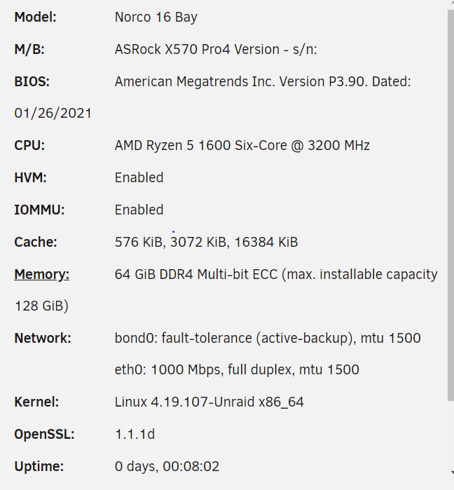

I have 4 x 16GB Crucial ECC RAM inside my Asrock Pro4 board, all detected fine inside the BIOS and showing inside the info section of unraid

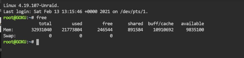

However, the usable RAM seems to only be 32GB, and i can't work out why
I am on the latest BIOS and the RAM is supported on the board by Asrock.  No onboard video consuming RAM, its got a discrete card
The RAM is seated correctly (or wouldn't show in the BIOS)

Hmm, ran memtest and only showing 32GB.... i need to see wtf is going on here
OK tried every stick of RAM one at a time, and all good and detected in memtest.  However, i can't get more than 2 sticks of RAM to show in memtest, despite all four showing in the BIOS.  Memory is set to auto speed (2666) with default settings.  Very confused
