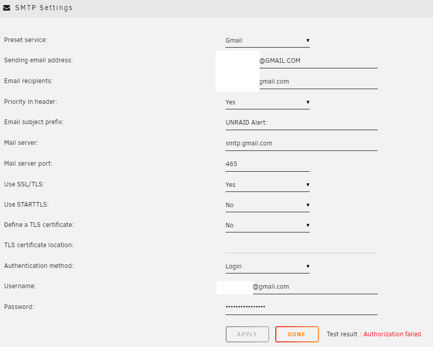

February 14, 20215 yr I'm using literally the same settings as I am using in bitwarden, and bitwarden is working fine. I am using an account without 2FA and using the allow insecure apps option in gmail. All I am getting is Test result: Authorization failed

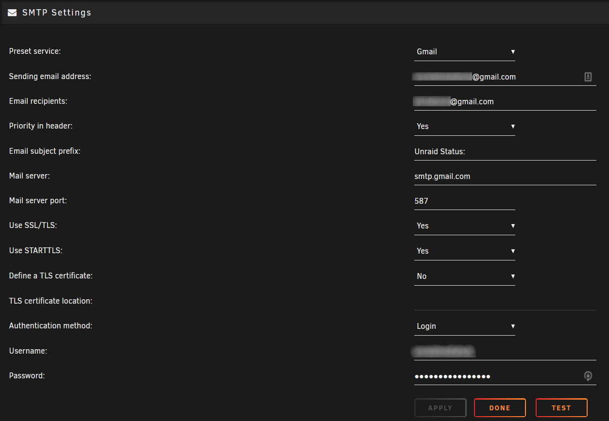

February 14, 20215 yr I can confirm that these settings work for me. How do these compare to the settings you're using? Maybe post a screenshot?

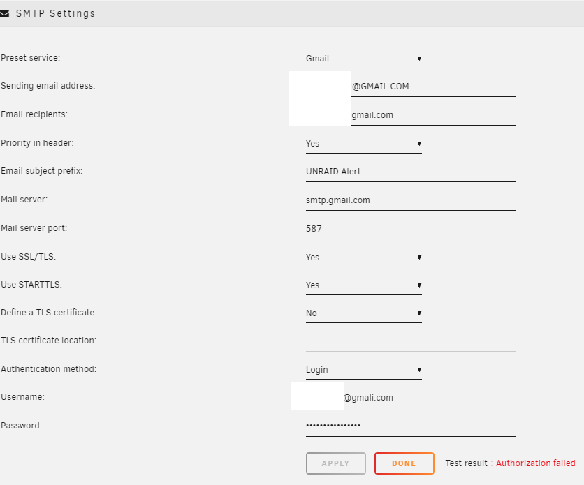

February 14, 20215 yr Author I've already tried both of those... also I did finally just turn on 2FA on gmail and assign app tokens to my smtp clients. Once again Bitwarden is working with it, but unraid is not. Edited February 14, 20215 yr by SimplifyAndAddCoffee
