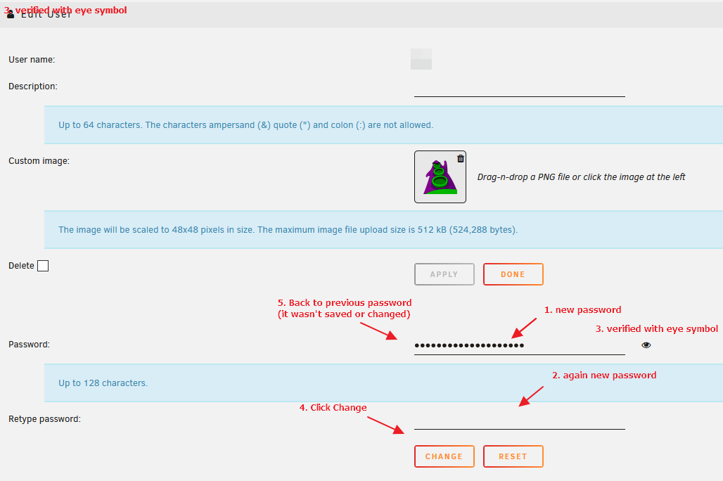

Hello,
I can't change the password for any user than the root user in the webGUI. It returns always to the root users password. I've fixed it while open the terminal and sudo passwd username and change it via the terminal.
The login with the change password works but even now, in the webgui the password is still shown as the root users password.
Im on 6.9.0 rc2
thanks

I think  there is a misunderstanding. I logged into the Webui as root and wanted to change a non root users login.  therefore I type the new password twice into the password fields. I verified with the eye symbol. After clickung change the password has changed back to the old users password.
Changing a password just doens't work apparently.
