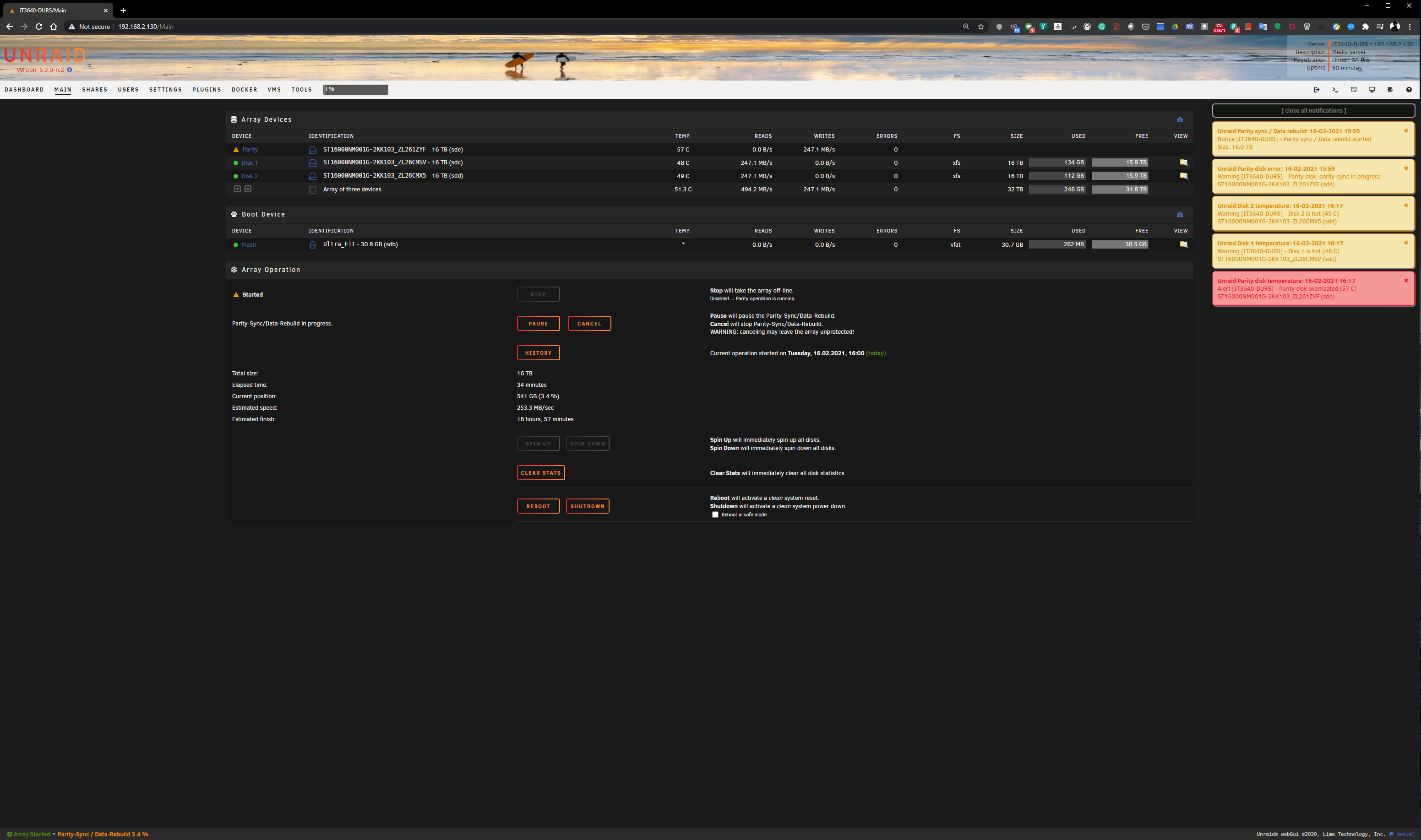

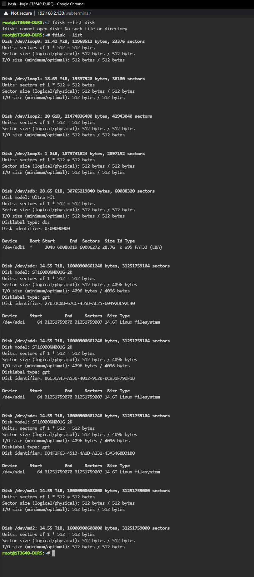

Feb 16 15:44:29 iT3640-DURS kernel: ahci 0000:00:17.0: Found 1 remapped NVMe devices.
Feb 16 15:44:29 iT3640-DURS kernel: ahci 0000:00:17.0: Switch your BIOS from RAID to AHCI mode to use them.
Hello! Jorge, Thank You! That worked for me!!
Appreciate your prompt response!
Cheers'
