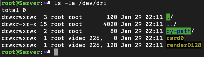

Can you do a "ls -la /dev/dri" on the host console and post the output here?

I passed through using /dev/dri in the docker options.
I also ran the command :
"mkdir /boot/config/modprobe.d
touch /boot/config/modprobe.d/amdgpu.conf"
And rebooted.

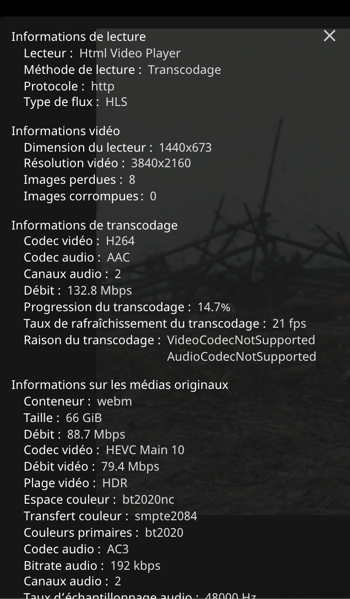

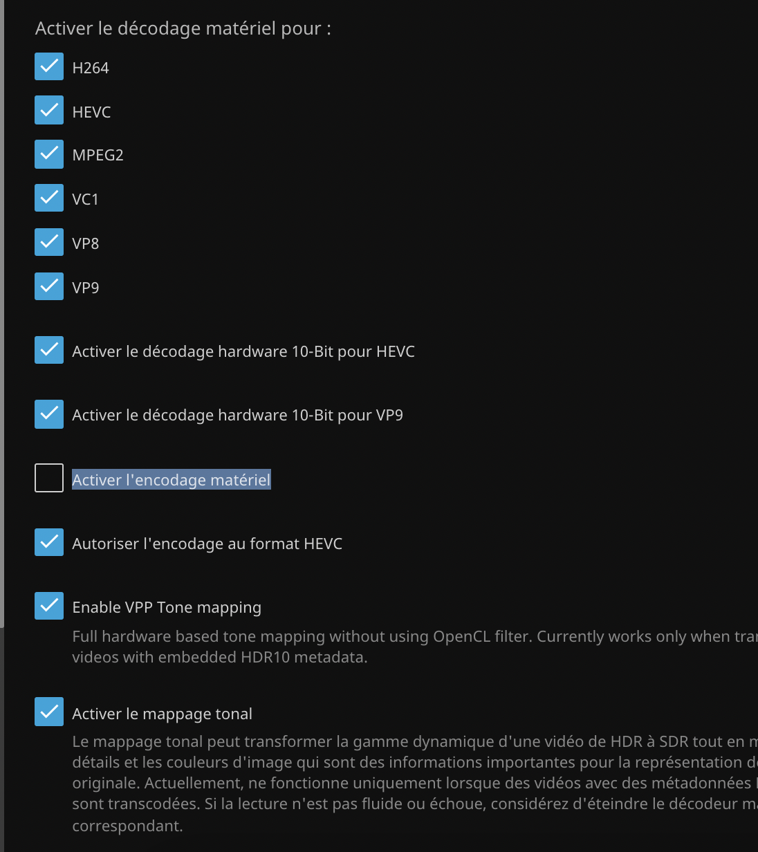

On the playback page, everything is ticked outside "10bits HEVC decoding".
I tried ticking one by one, checking if playback worked each time.
Ticking this one gives me the message :
"This client is not compatible with the media and the server is not sending a compatible format."

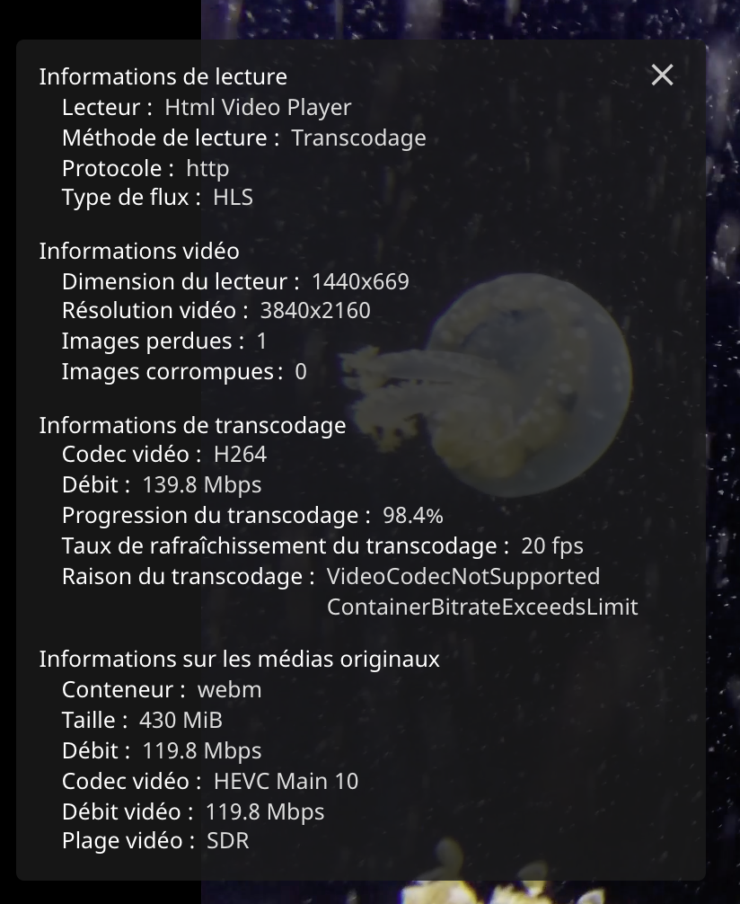

I get around 60-70% CPU usage without the "activating HEVC 10 bits decoding", when playing back a HEVC 10bits file.
While getting around 35% with it ticked.

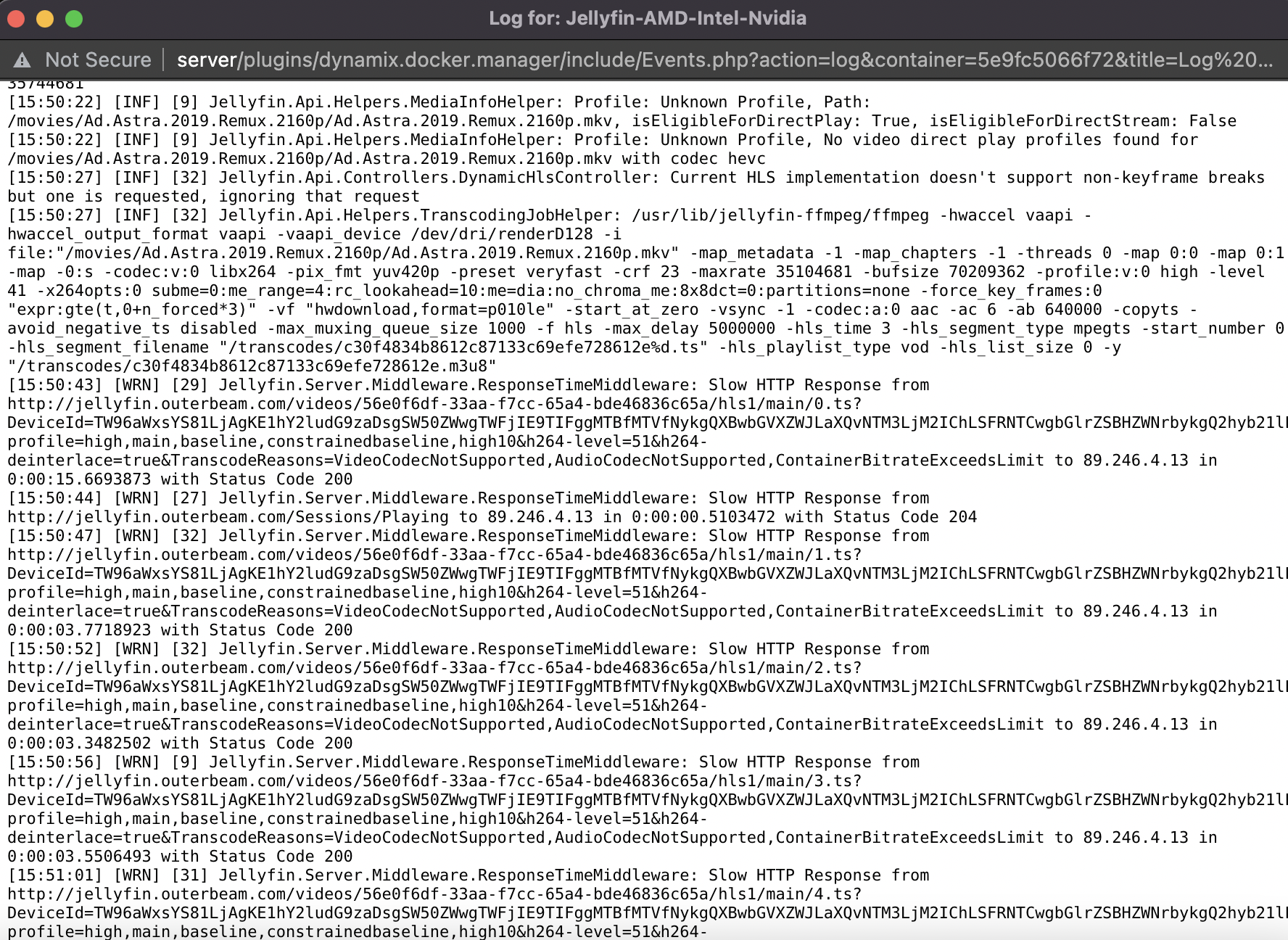

I joined :
- A capture during HEVC playback.
- The output of "lsmod".
- Output of "ls -la /dev/dri".
lsmod.rtf
Edited by dboris
What path is set in the Transcoding section from Jellyfin, sadly enough the screenshot doesn't show it.
Can you try a file that is not HDR?
This means usually that the CPU or iGPU is not supported.
So is it then working I think?

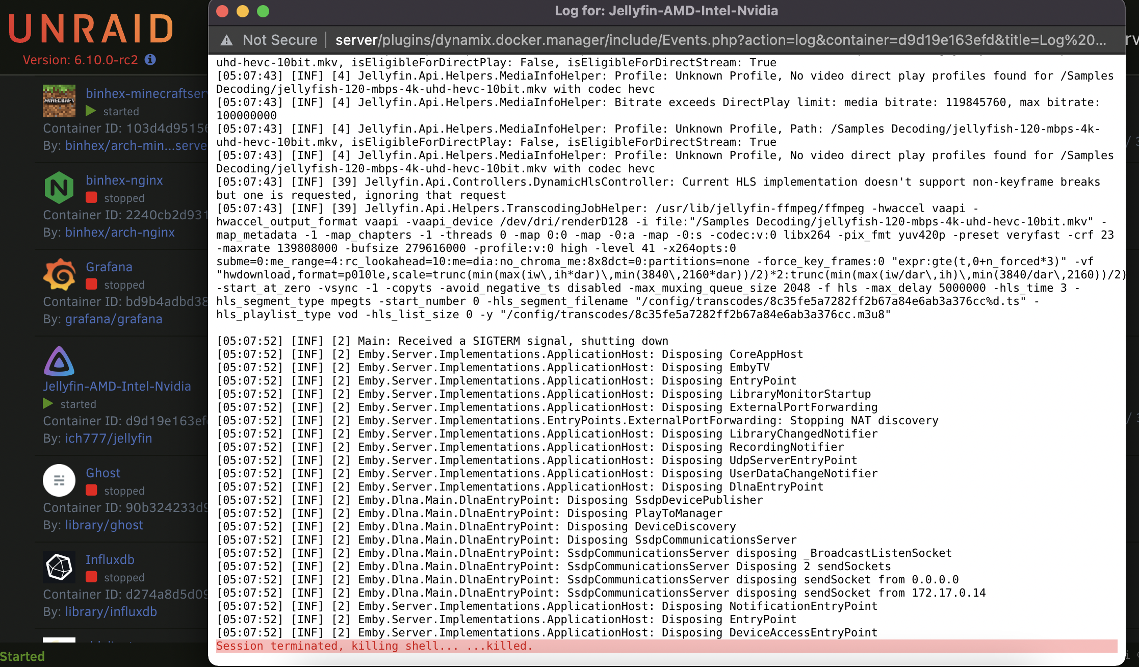

Previously it took me time to answer because I had an issue :
Jellyfish container was responding H264 was playing back, but no H265.
Couldn't restart the container.
It was always displayed as turned on, on unraid GUI.
The log was showing that the contained was killed (capture included).
Previously I thought it was a random issue.
But I encoutered that bug again.

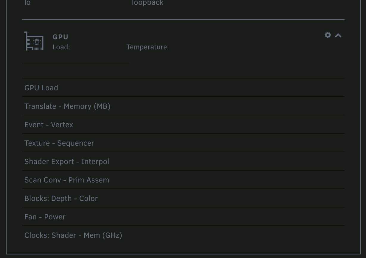

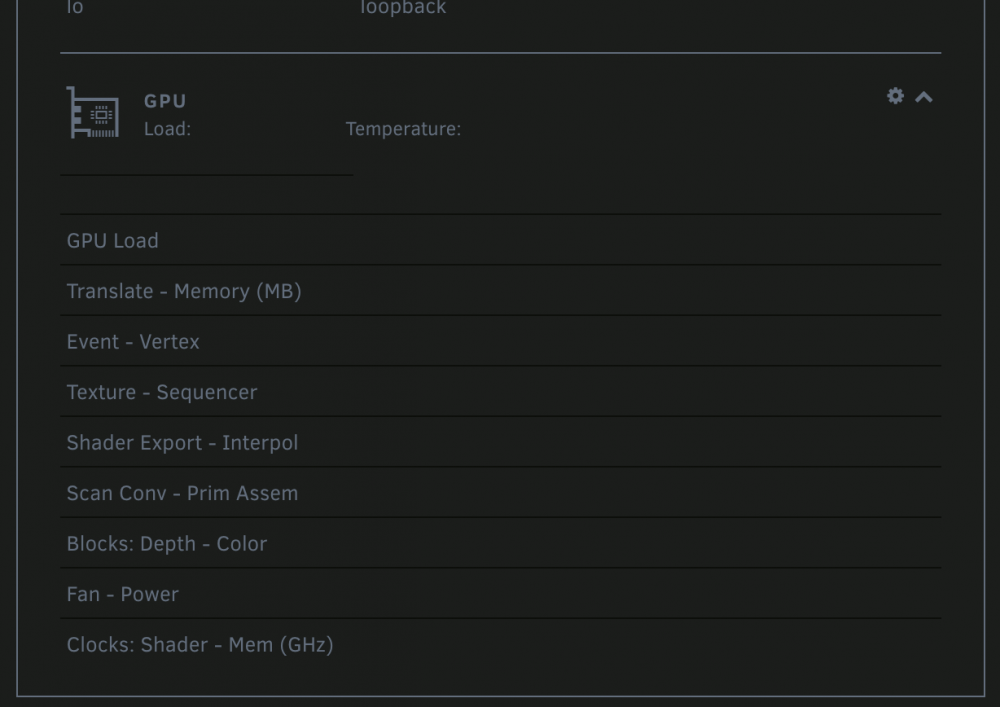

It seems the GPU crashed.
The GPU info, when crashed, displayed nothing, and sometimes "100%" usage (capture included).
I tried disabling docker instead of restarting. But was stuck with "Please wait... starting up containers".
So I restarted the unraid server.
Both time it triggered a rebuild of the array so it doesn't look like a clean shutdown.

For the non-HDR content, see the included screenshot using the jellyfish samples listed above :
I get 20% GPU and 25% CPU with non-HDR HEVC.
Same results than with HDR.
_______

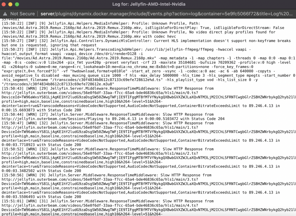

I see no CPU/GPU/drive overload when stutters happens.
As you can see there's still the "codec exceed limit" and "codec not supported" messages.
I shared a screenshot of the log.
When launching a video with HW decoding enabled, I see a spike of usage of the GPU before getting the error message.
Probably it's trying to playback before crashing, driver issue? Making wild guesses.

Takes 10s to load for each clic through jellyfin.
I tried hosting the movies from a hard drive connected directly to my macbook M1.
Still get stutters...
What the.
I feel I lost a considerable amount of time trying to fix something that is originally broken.
_______
Tried jellyfin on a intel 8700K with 1080Ti.
No issues, playback works much better, even when streaming content over wifi with a bad wifi card.
It seems that CPU-only decoding is a very bad idea.
I also took the time to test the performance when disabling the "GPU encoding" option.
Well, disabling it gives noticably less playback performance, and increase considerably the lag/delay when moving in the video files.
Considering that this option doesn't work with my 4750U - I can't playback files with it enabled -, it can possibly explain all the issues I'm facing !
Maybe later drivers updates will make it work for me?
It looks like other users don't have such issues with desktop amd CPU.
Edited by dboris
