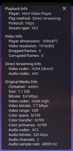

I had a server crash and in the process of fixing all of it. Before the crash Jellyfin and video transcode through my nvidia 1080i was working perfectly. Now when i have transcoding turned on, by video is distorted. Everything i have tested so far is h264, which is checked marked in my jellyfin settings. I have tripple checked all of my settings, and everything seems to be correct. If i turn off transcoding, the videos play without any distorting. I am not having the same issues with plex. Any thoughts or ideas?
I just found a HEVC that is doing the same thing. im pretty sure this is h265?
You can find out what kind of media it is by starting the playback, click on the little gear icon on the bottom right hand corner and clicking on "Playback Data", this will bring up something like:
Is your media HDR too?
Also please try to set the "Max muxing queue size" in the Jellyfin admin settings at "Playback" to 4096 and try if the same is happening again.

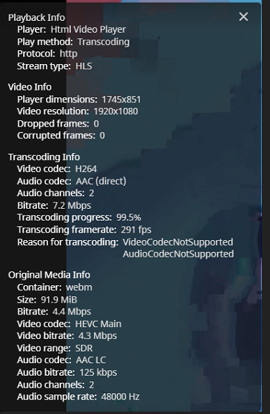

I changed it to 4096 and still the same issue. Here is a screen shot of my playback info
Edited by Macleod76
Oops. sorry for the picture location.
I changed it to 4096, same problem. You can see my playback info. You can also see some of the distorted video. These videos were playing just fine a couple days ago. My granddaughter watched them every day lol.
This is really strange... have to look into this if I actually can reproduce this behavior on my server.

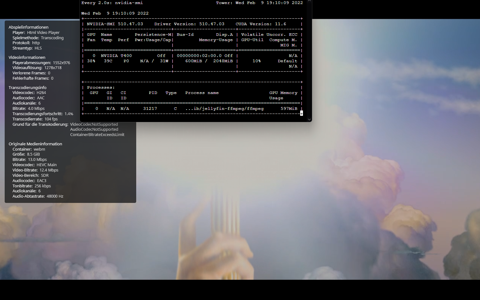

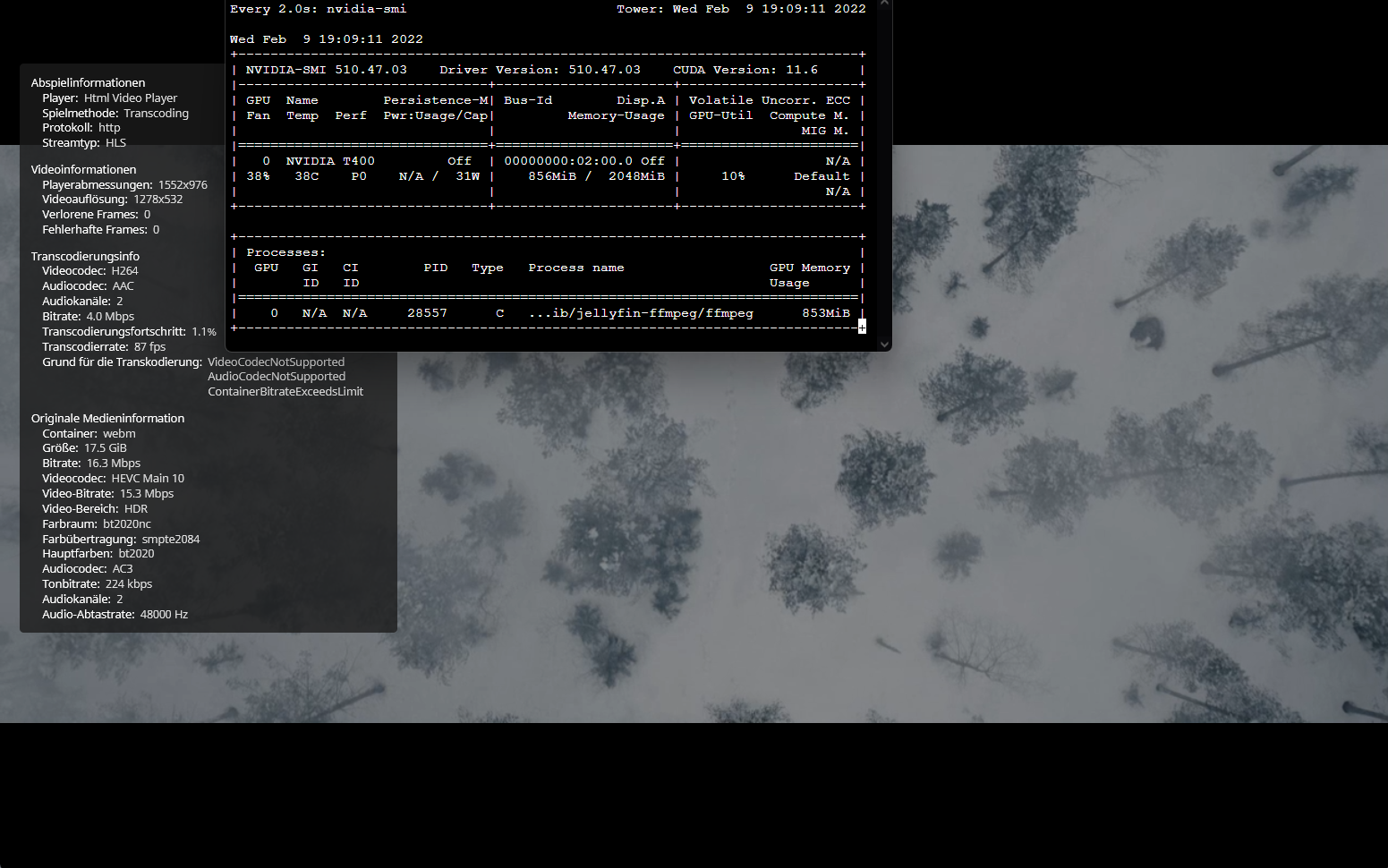

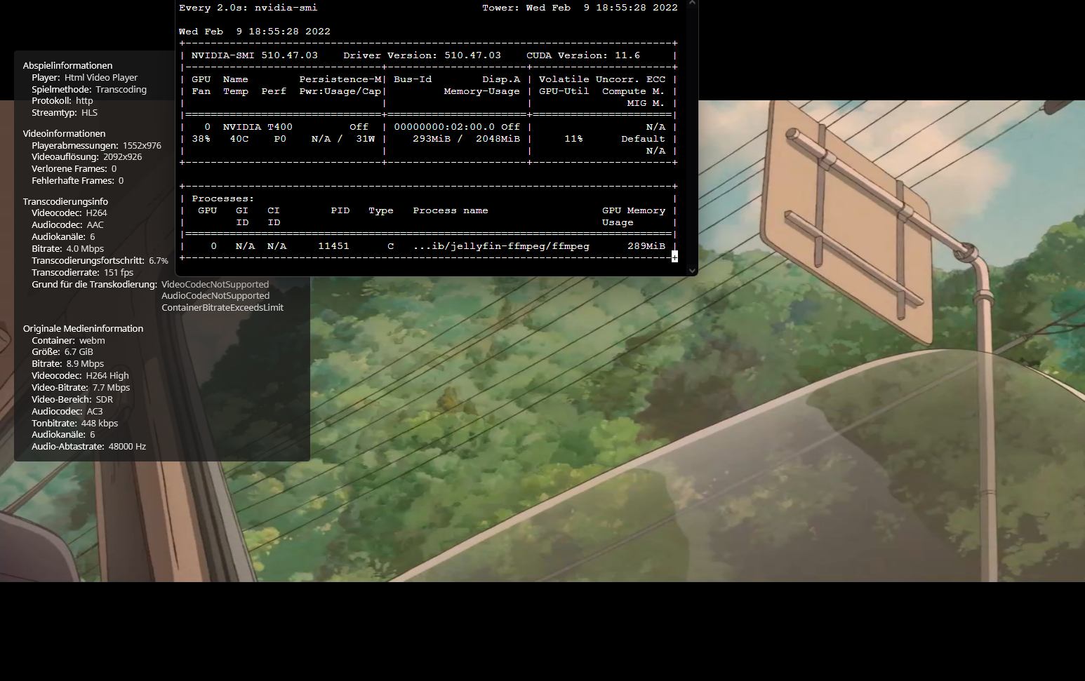

I've now tried it with h264, h265 & h265 HDR -> see screenshots below.
I really can't tell why it's not working on your machine, are you on unRAID 6.9.2 and what driver version have you selected?
I'm on 6.10.0-rc2, the latest production branch v510.47.03 from the Nvidia Driver and I started the playback on Firefox.
I also can't think of a driver issue since it works in Plex, have you also yet tried another browser or if the same happens on the mobile apps if you change the quality?
Also maybe try to wipe the complete cache folder for Jellyfin.
h264:
h265:
h265 HDR:
