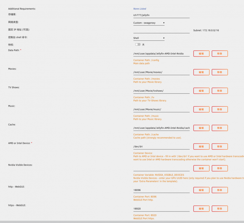

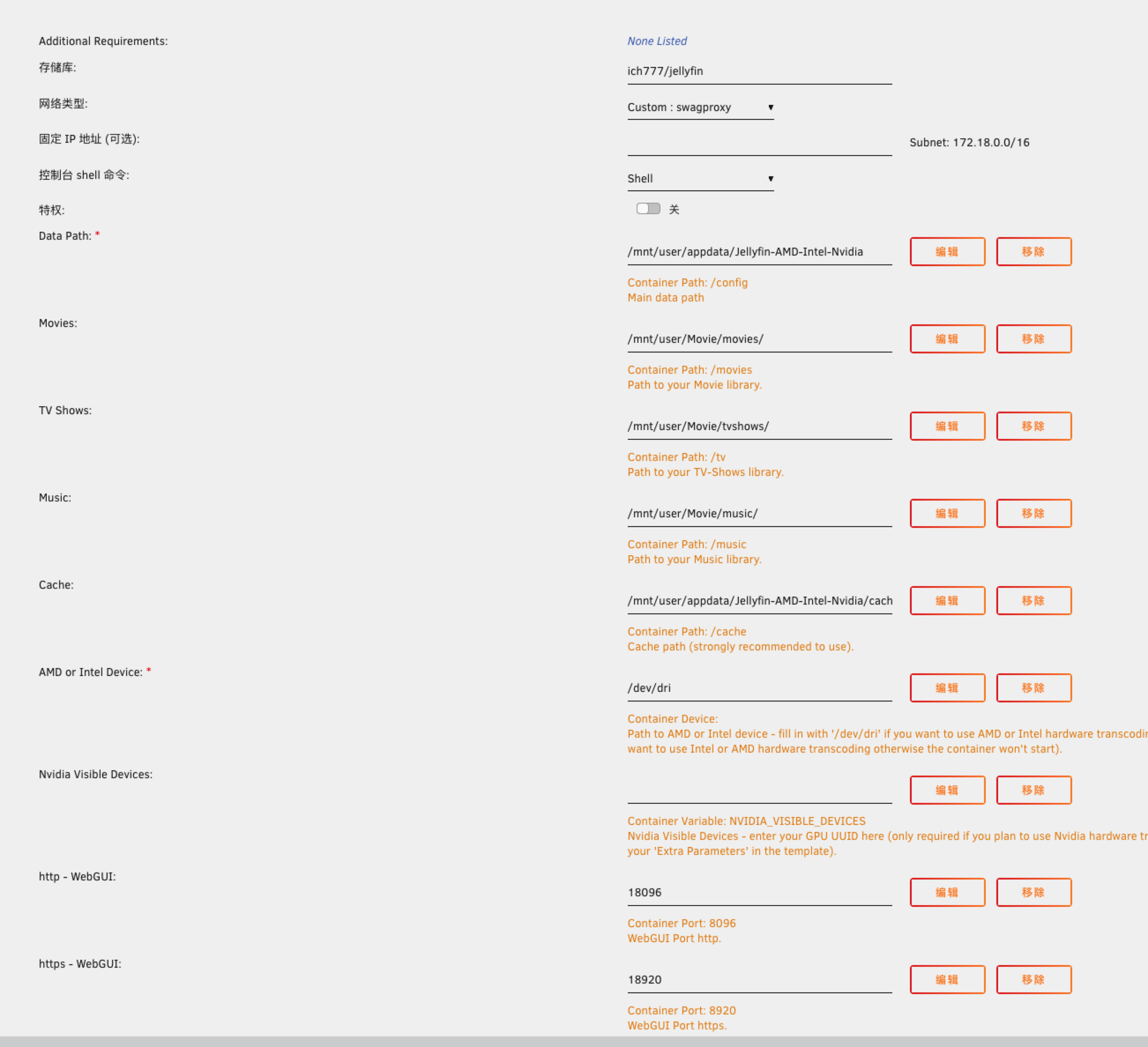

3 minutes ago, ich777 said:
Can you send a screenshot from your template
5 minutes ago, ich777 said:
Looks like you are transcoding to RAM.
Can you send a screenshot from your template? Have you changed anything in the config or the template?

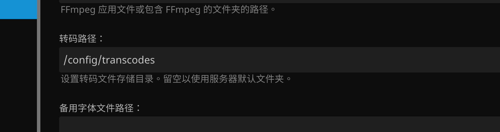

Can you go to the Jellyfin settings at Playback and can you look what transcoding path is set?
If you get a Out of Memory error something must be written to RAM and fill up your entire RAM.

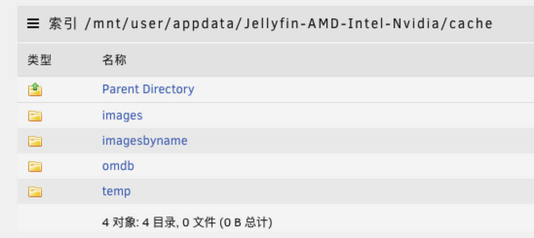

Can you double check if the directory /mnt/user/appdata/Jellyfin-AMD-Intel-Nvidia/cache exists on Unraid?
It looks a bit suspicious to me why you are are running out of memory when you are transcoding.
You can try to start a transcode with a way lower resolution and at a lower bitrate, in the web player click on the gear Icon on the bottom right, at Quality select something really low like 480p 1.5Mbit/s and look if your RAM fills up again…
As said abive throttling is not working in Jellyfin so your GPU usage should be 100% again but as said above Jellyfin transcodes at full blast without any throttling.
yes, exist

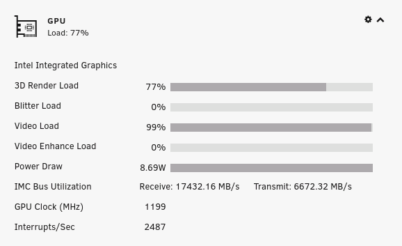

As said above it would not harm your system when you GPU goes up to 100% here is it what it looks like on my system:
Of course I'm using a Intel iGPU and not a APU from AMD but that should make no difference (please look at the Video load which is also at 100%).
If you get a OOM error (please tell me where you got that message) there is most certain a different reason for this.
Other users are using my container with a AMD APU without any issues, regardless of the GPU usage.

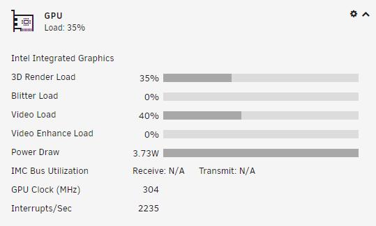

2 hours ago, Peelson said:
When I started transcoding, my GPU usage went like this, and my unraid system froze,i can do nothing.
I got logs here, are there helpful?

I see nothing suspicious in there, I only see that it uses this path in the container to put the transcoding files to:
/config/transcodes/...
Where it should be /cache/transcodes/...
But that is only a minor thing since both paths should exist.
