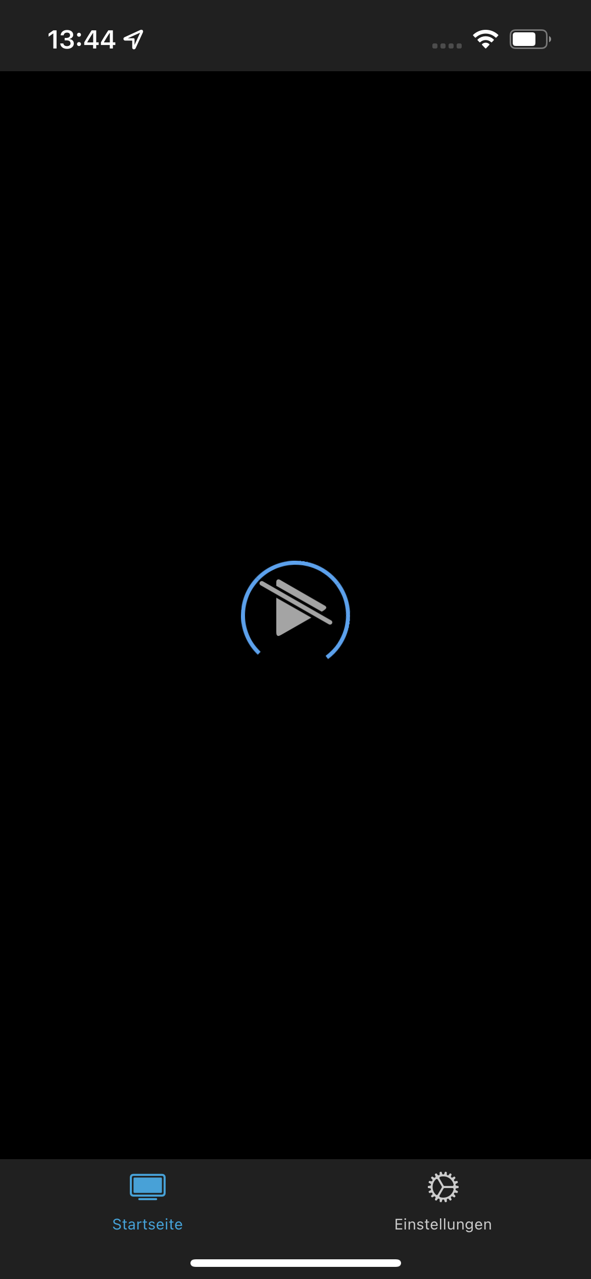

Hi togheter,
the docker image is running perfect with hardware transcoding (in my server is a NVIDIA Quadro P620).
Thanks a lot @ich777👍
I have only one problem in the ios app (Jellyfin)....
My "old" iPad 2018 and my iphone 13 can not display a 4K movie (don´t know why is not working on my iphone...), so, normaly transcode the P620 it (automatic?) to the correct
highest format, that can play the ipad or the iphone?
Or must i changed anything in the settings?!
Only this image, in attached, is showed me on my iphone and my iPad (iphone is a iphone 13)...
Have anyone a tip?
PS: The "Beta" Video Player i have tested, but this is not working.
When the "ring" is showed in the ios app, i see in unraid in the GPU that Jellyfin is a "Active Apps", Load memory 37%, etc.. etc..
Don´t know, why is not playing the movie..
PSPS: 🙂 1080p no Problem on Iphone and Ipad... only 4K is not working...
Thanks a lot! ✌️

Sry... i don´t wont a double post, but i have found a solution in another forum, for the iphone....
"Try pressing person icon in top right corner for settings. The select playback from nav menu and enable "Prefer fMP4-HLS Media Container""
This works for the iphone, but not for the "old" ipad 2018
So is this issue resolved now?
Can you try to open it in Safari and see if it is working?
I think this is more dependent on the client than on the server side...
in Safari the same issue...
Is not working... The server and the other clients works fine.... maybe i must order a new ipad.. 😕
Thanks for your great support 👍👍✌️
Hmmmm, this is really strange, but I think a iPad from 2018 should be able to handle the format...
This is really the last thing that I would do but maybe try to factory reset the iPad and see if this helps.
short replay ore information about is it running or not... 😕
Factory Reset => nope
https config via reverse proxy (nginx) => nope
new config with Jellyfin app and with/without "Prefer" option... (Beta player is not working) => nope
any other browser (Chrome, Safari, Edge, Firefox) => nope....
on the fire hd 10 no problems...
hmm... i think i must say goodby to my good old ipad.. 😪
