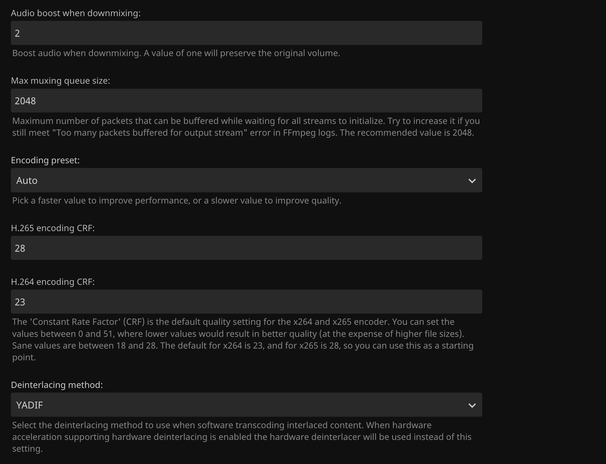

With before i mean that i watched the same files/episodes a few weeks ago and after i got the errors on newer episodes i tried older ones that i certainly knew worked before and got the same error.
in the screenshot are my settings:

Please also post a screenshot from your Jellyfin Playback section.

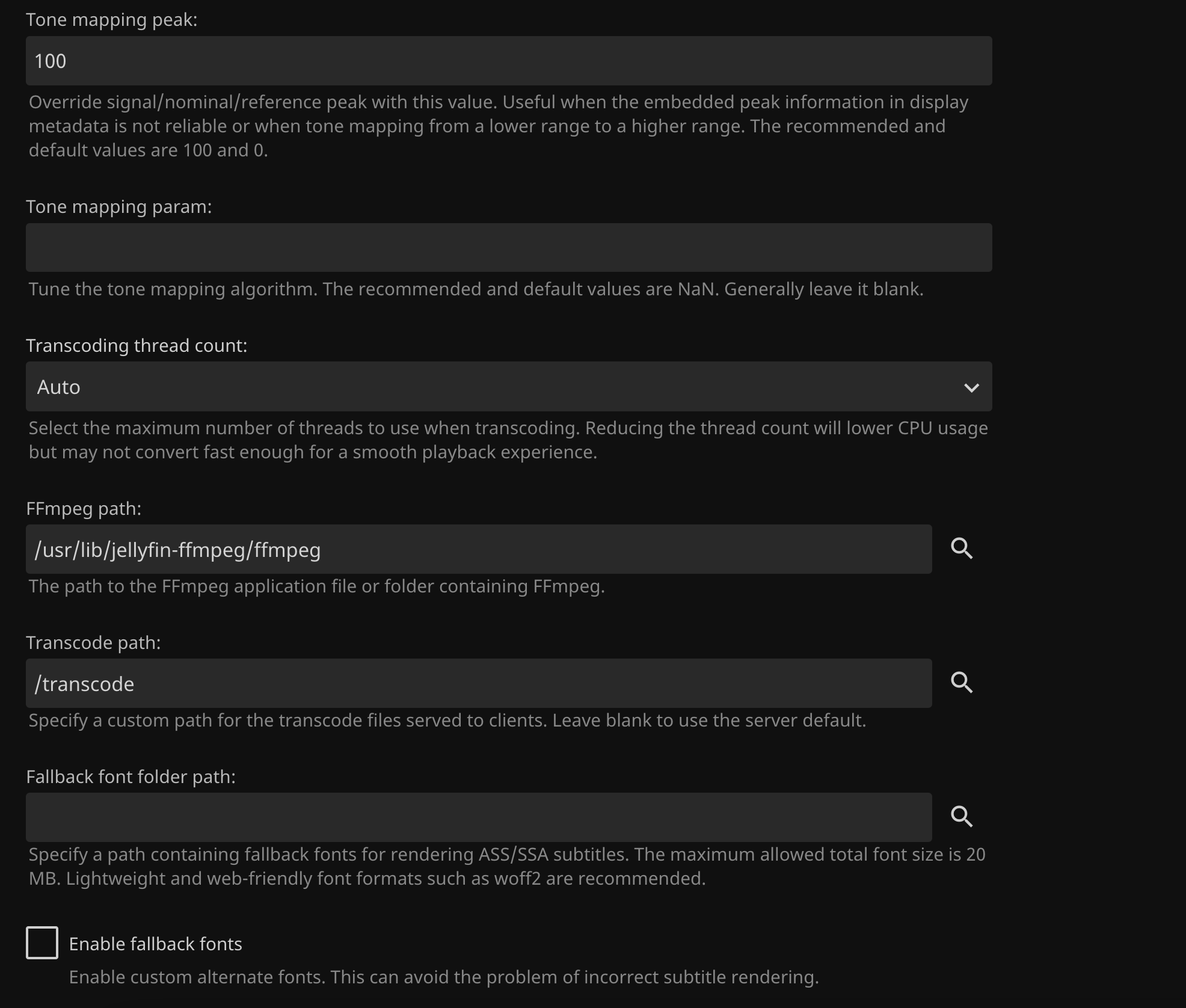

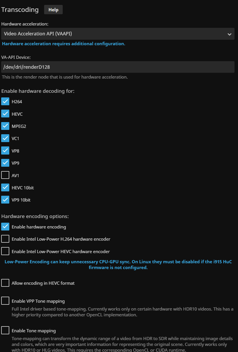

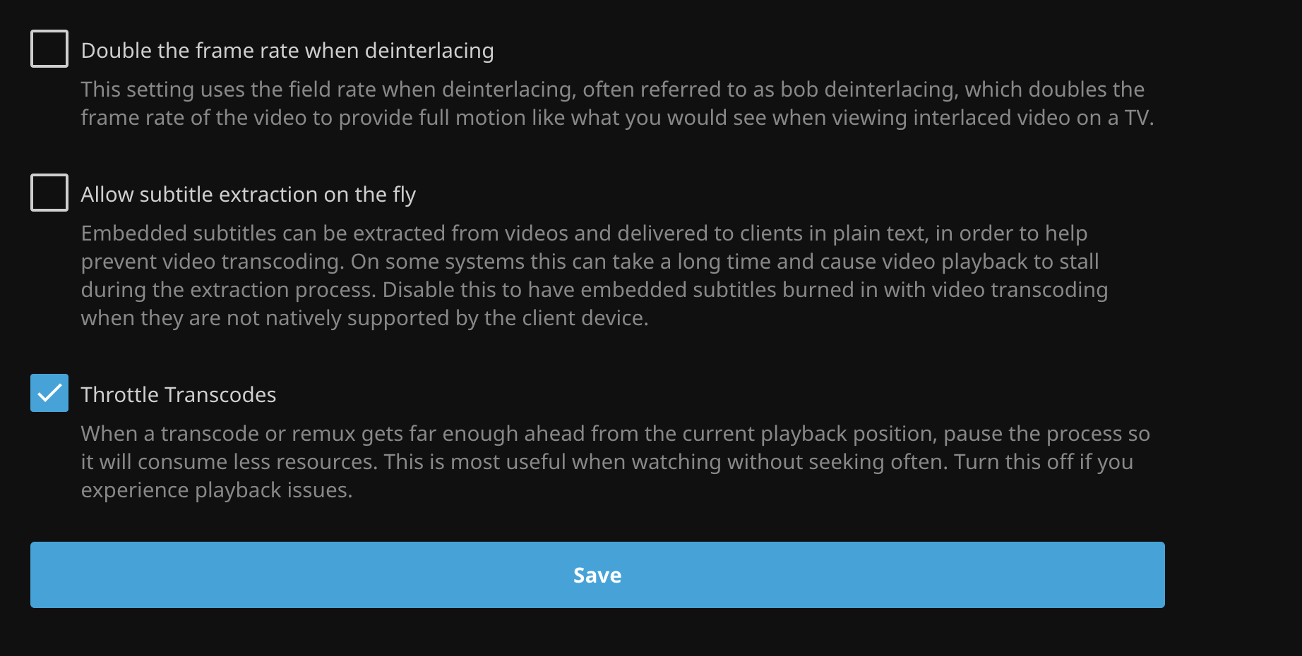

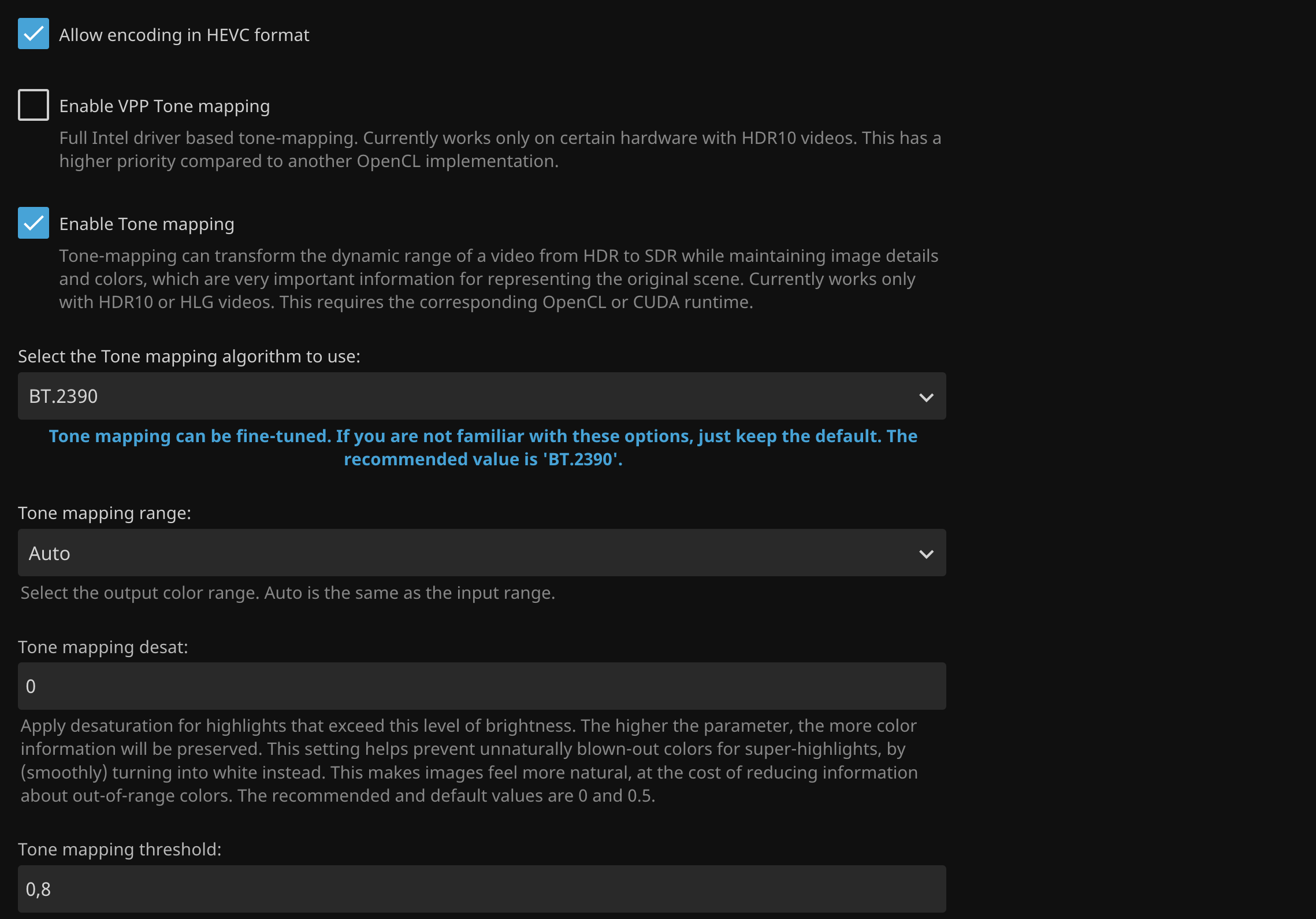

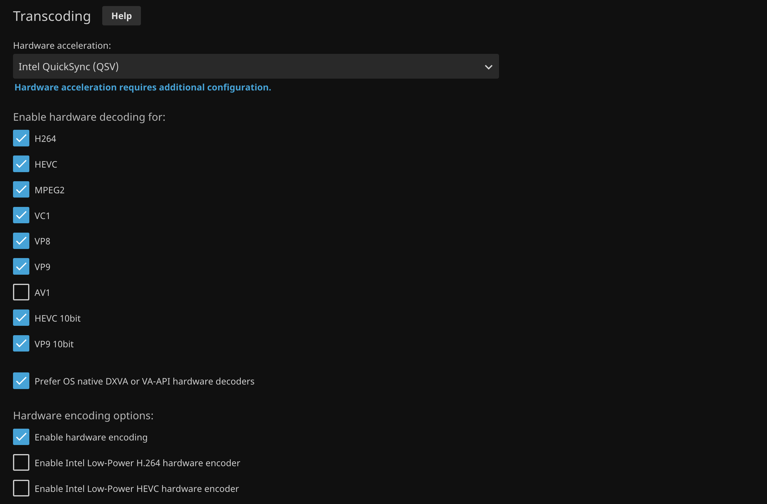

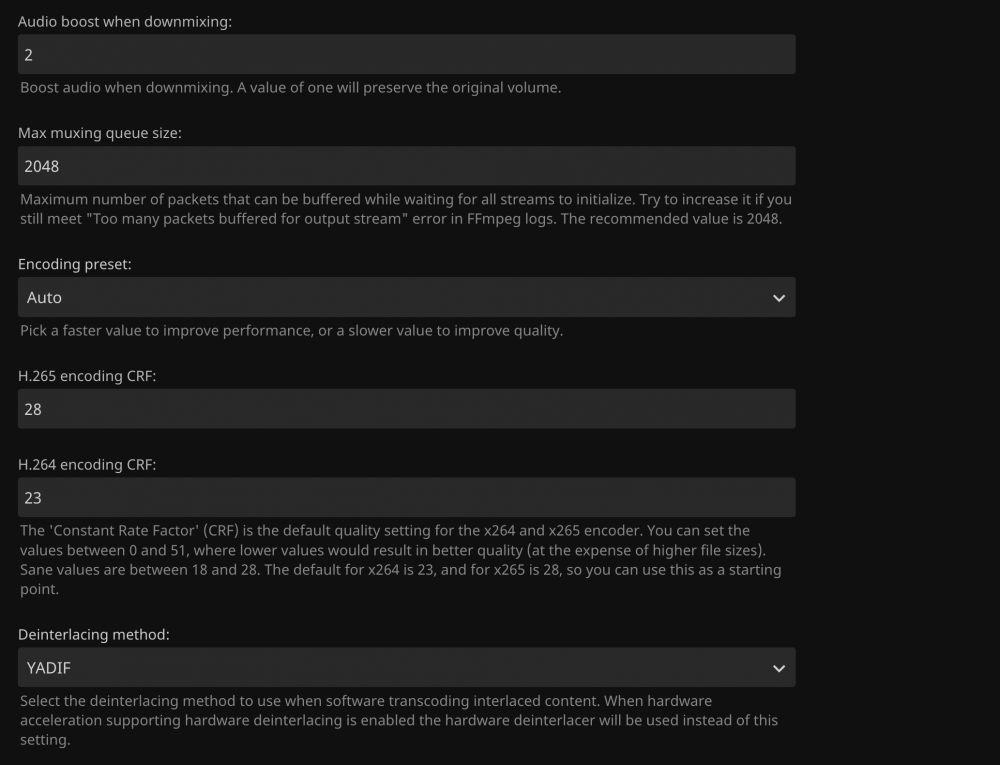

Thanks for the suggestions! I've removed the line from the go file and upgraded Unraid but that did not affect my problem, which is still there. Here are the screenshots of the playback section (I've already tried changing the tone mapping algorithm and disabling encoding to HEVC).
Please switch from QSV to VA-API and disable "Allow encoding in HEVC format".
