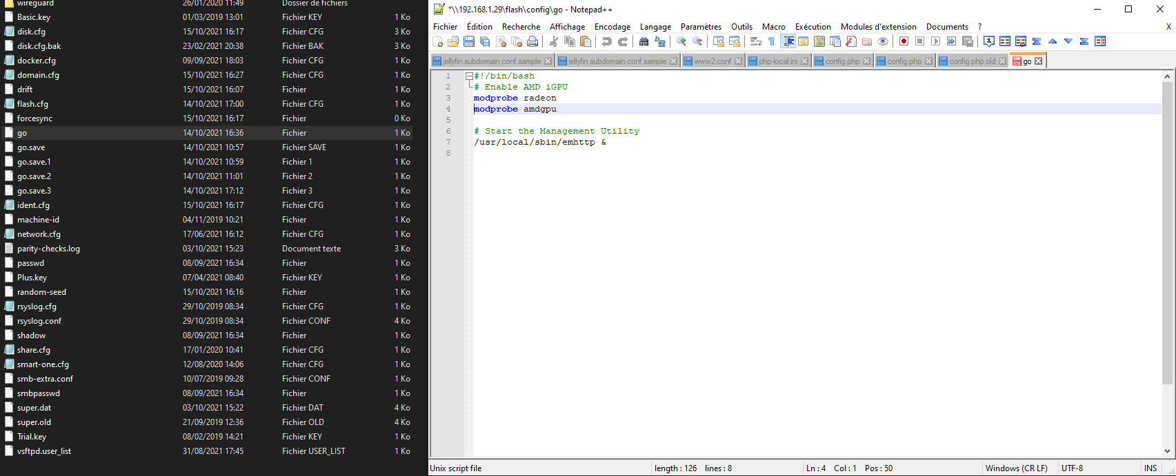

I tried through the unraid console, without success. I edited the file with notepad ++, added the line, but unfortunately it doesn't work
Remove the line 'modprobe amdgpu'
I would also recommend to remove the other "backup" go files.
After you've removed the line reboot unRAID and and try if it works, if not please post the output from:
lsmod

Hi, Sorry for the late reply.
i just deleted the modprobe amdgpu line from the go file and deleted the go.save. Unfortunately I always have an error after restarting the server when launching your Jellyfin docker.
But it does not matter, my CG not decoding the HECV codec, I wait to succeed in buying a 6800xt to replace my GTX1660 that I would put in my server at this time. I think this is the best thing to do :)

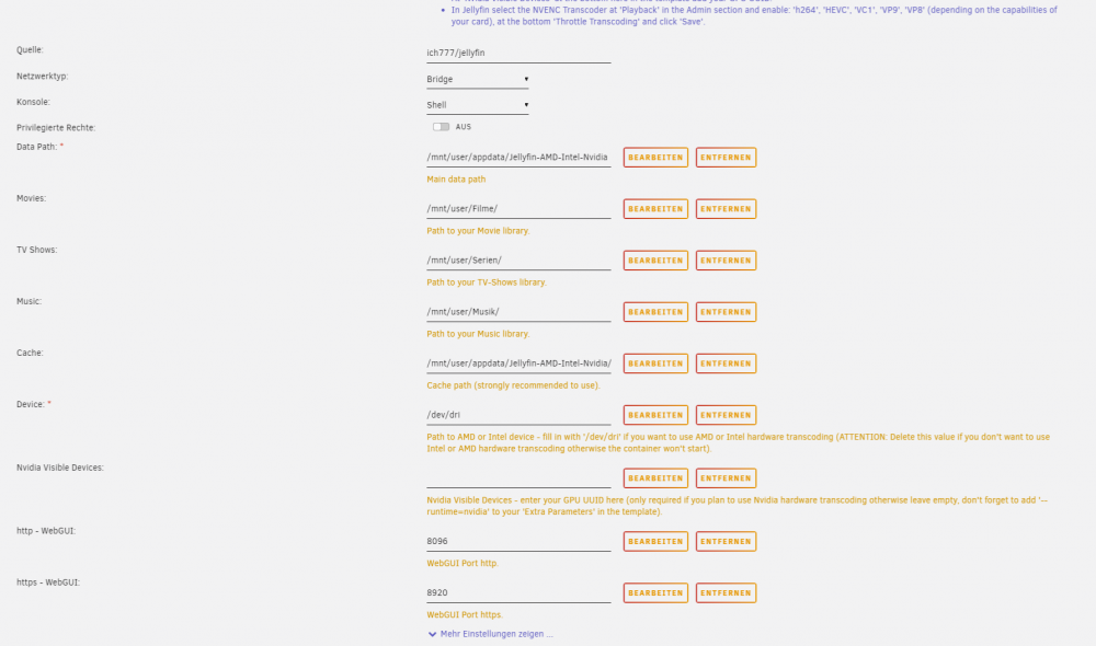

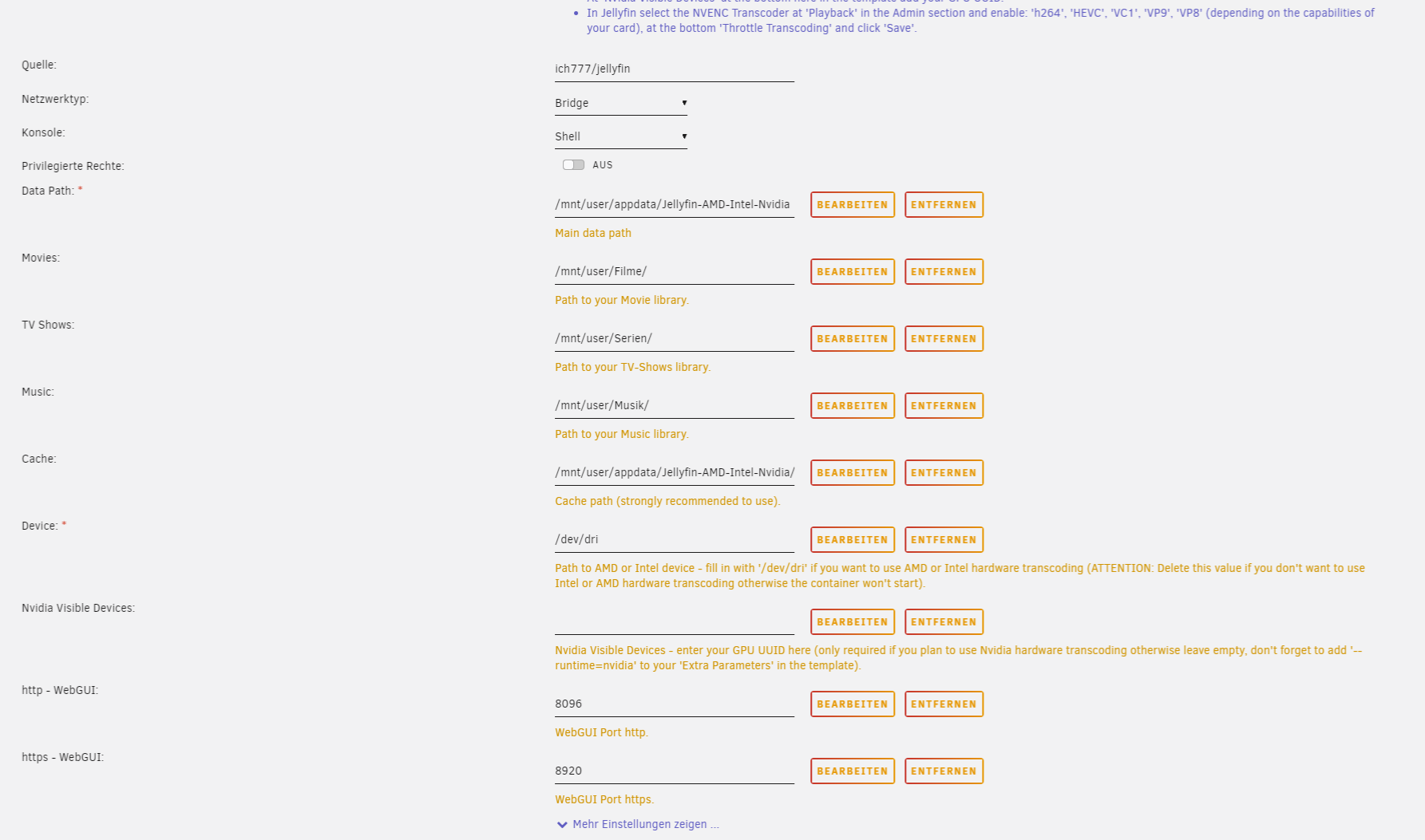

Please post a picture from your Docker template.
Have you installed a Cache drive?
Is your Video library gone too or just the Admin settings?
I'll be using the Container without a problem.
Screenshot attached.
Cache drive is installed (1TB Kingston SA2000 NVME). Library is still available and it is possible to run movies. Just the admin settings are gone and i am not able to change any settings.

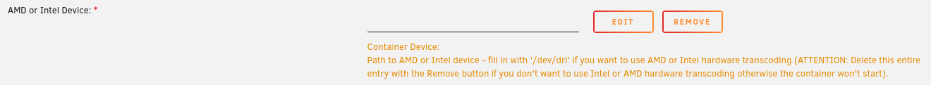

Also be more clear what to type into this area if Im using a Nvidia GPU
EDITREMOVE
Path to AMD or Intel device - fill in with '/dev/dri' if you want to use AMD or Intel hardware transcoding (ATTENTION: Delete this value if you don't want to use Intel or AMD hardware transcoding otherwise the container won't start).
News flash buddy I have to put something into that spot to get the container to work!! but you don't say what so im using /dev/dri with nvidia. Thats not cool, it should probably have a different name or you should tell people what to put in the spot with the red asterix. We cant just leave it blank!!!! Im so sick of u guys messing my shit up no more updates to hell with it I'm running it the way it is.
EDITREMOVE
Now that I read it again it makes sense that I should edit the description a little bit. ;)
Delete the whole entry then the container can start. :)
Hope that's appropriate and thank you for the suggestion:
See answer above, already edited it, but it will take a few hours that users can see the new description text (you can't leave a "Device" entry in the template blank, this will prevent the start from the container and lead to an error message at the "docker run" command that users usually don't read. The asterisk is actually there so that users read what this is and if they need it).
The description only says that this is for Intel or AMD, for Nvidia you have to put in your GPU UUID.
