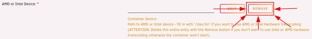

10 hours ago, RYZEN5000 said:
I cant chose a different container because I just bought a nvidia 1050ti and this is the only container with the guid input to use it.
That's not true, you can also use @binhex or @linuxserver.io container, they both support Nvidia transcoding, I can tell for sure because I've tried both with NVENC and they work fine.
The instructions given are clearly to leave it blank and that simply won't work.
I already changed the instructions as said above, again thank you for the suggestion, you have to remove the entire entry with the marked button in the screenshot (the red asterisk was done on purpose):

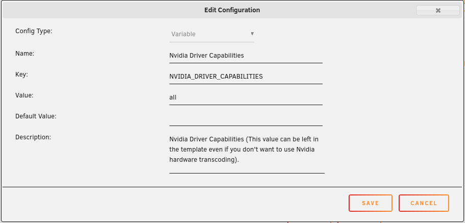

I found that the stock template needs to be modified if you are using NVIDIA transcoding. The additional parameter of NVIDIA_DRIVER_CAPABILITIES with the key of 'all' fixed by transcoding issues. The maintainer needs to fix their template, changing Nvidia Driver Capabilities to NVIDIA_DRIVER_CAPABILITIES.
Now the other thing, is that transcoding does not kick in unless you choose a lower bitrate than what the file is originally encoded at. I've watched my GPU dashboard to verify that.
Edited by PatientXero
Exactly, in templates where these vatiables are missing you have to manually add them, see here (second post):
That's not what I meant. You already have 'Nvidia Driver Capabilities' in your template, which isn't properly formatted. If you formatted it to "NVIDIA_DRIVER_CAPABILITIES", that would fix the issue. Telling someone to add it doesn't help your case, and is is sloppy development.
Reformat
I really don't get what you mean, I think you are talking about the name which is "Nvidia Driver Capabilities" and is filled in because it looks way nicer to the user than not filling it in and showing only the bare key entry "NVIDIA_DRIVER_CAPABILITIES", it is formatted properly from what I see:
Also please keep in mind that the key always has to be the variable, in that case "NVIDIA_DRIVER_CAPABILITIES" and the value always has to be the value from the variable, in this case "all".
BTW Thank you for the roses... :D

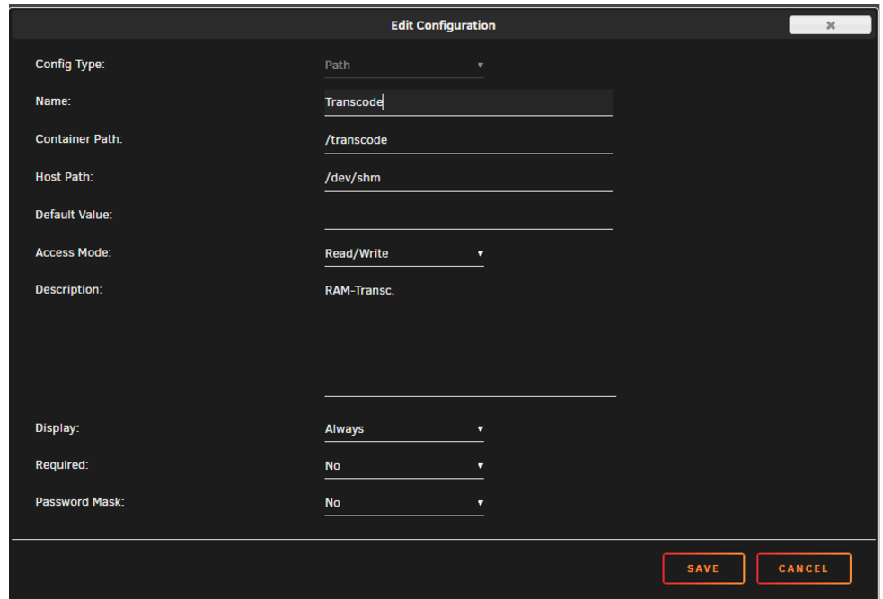

What I noticed when rebuilding with the current unRAID beta is that you still have to use "CA Cleanup Appdata" otherwise you will take old data with you...
I also had the problem with playback with the QSV setting, so make sure that VAAPI device;
/dev/dri/renderD128
...however, there is something I miss and at least "back then" was actively running, RAM transc. I had at that time another container "dee31797's Repository ) container " under it it was as in the picture to recognize possible RAM transcodierung to use 50% was taken, what my NVMe already^^ ...in Jellyfin one had to change then "/config/transcodes" in "/transcode", finished,.
unfortunately... this does not work anymore. I had to reinstall the container because the settings were shot in Jellyfin.
Edited by Reflexion
I don't understand what you mean by that...
If you want to set up a new instance from the container you always have to delete the whole container and the folder for Jellyfin that was created in your appdata directory.
/dev/dri/renderD128
That depends on the model from your iGPU if QSV is working or not, I would recommend to use VA-API if QSV won't work.
The main issue with Jellyfin is that if the transcoding directory runs out of space the playback will stop too, see this Github Issue: Click
However you can use whatever path you want inside the container you only have to set it first:
  1. Open Jellyfin
  2. Go to your Admin Settings
  3. Go to Playback
  4. At the transcoding path enter the path you want to use, in your case I think this will be '/transcode'
Don't forget to map the path in the template as in your screenshot.
@ich777correct, deleting manually or with CA Cleanup Appdata works, but unfortunately not the classic deletion of the container.
Correct, I have adjusted '/transcode', saved and rebooted... but after that there is no more playback and the settings for HW encoding are emptied.
With the omission of RAM transc. and the classic VAAPI, it works well so far, to the sorrow of my NVMe's.
Why should this work?
If you want to start new you have to do this even for any other container too.
This is not normal, please check your settings, also keep in mind with my container you have to set your appdata share to Use Cache "Only" or "Prefer" if you don't customized the path because it searches for it on the Cache.

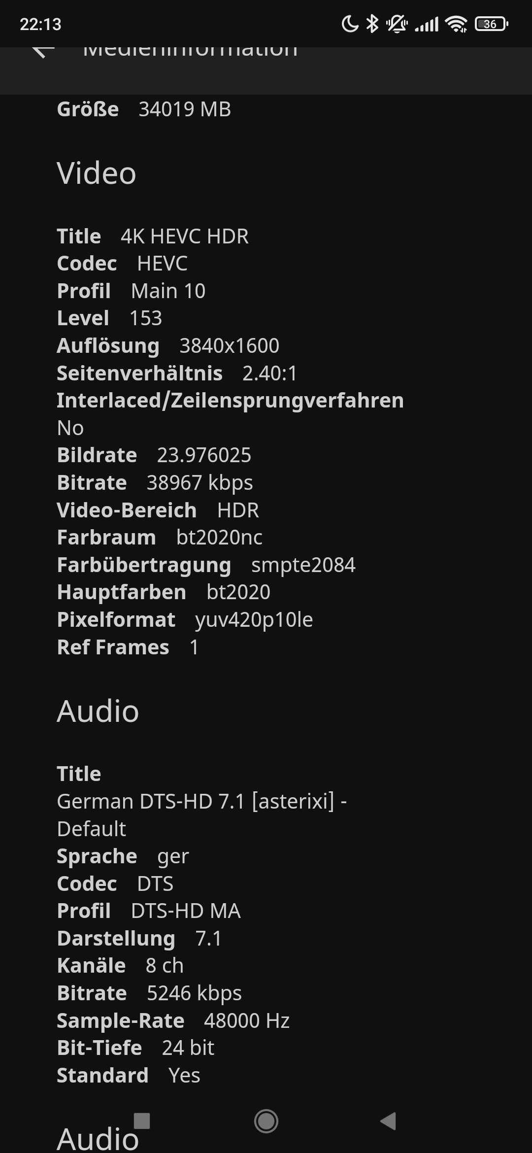

Hey there,
tried to Play a Video via Jellyfin-App in my Smartphone (Xiaomi Mi 9T pro). Working with Pentium G6605. Video works great via Fire Stick 4k on a Samsung 4k TV, but in the Phone it is Just some colors. Attached Screenshot of the colors and the Video information. Intel GPU Top is installed, path /Dev/dri. Amy ideas?Screenshot_2021-12-22-22-12-23-875_org.jellyfin.mobile.thumb.jpg.bc0f3c1318cb8b74a4ed2f8c87ec59eb.jpgScreenshot_2021-12-22-22-13-17-132_org.jellyfin.mobile.thumb.jpg.93b1f7c49afb7f27b7bef1aee485859d.jpg
Edit:
OK, Changed from Quick Sync to VAAPI and now it Is working "OK". Sorry and Ty. :D

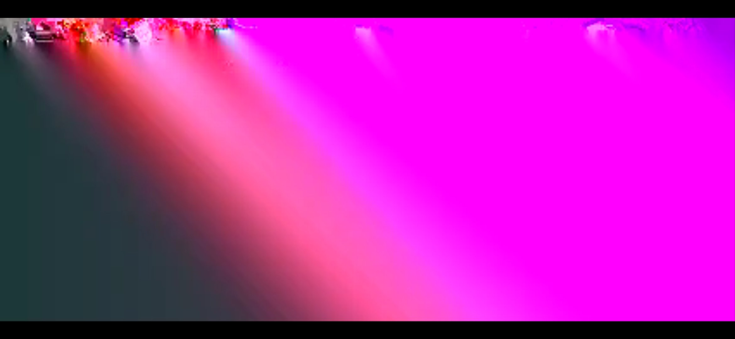

i have a strange problem with jellyfin. Im using an amd ryzen 4650g and configured the hardware acceleration but i'm getting strange colorful flickering on all my media. i found out that the flickering disappears when i disable hardware encoding in settings. Any idea why that happens?
Edited by limital
picture added
