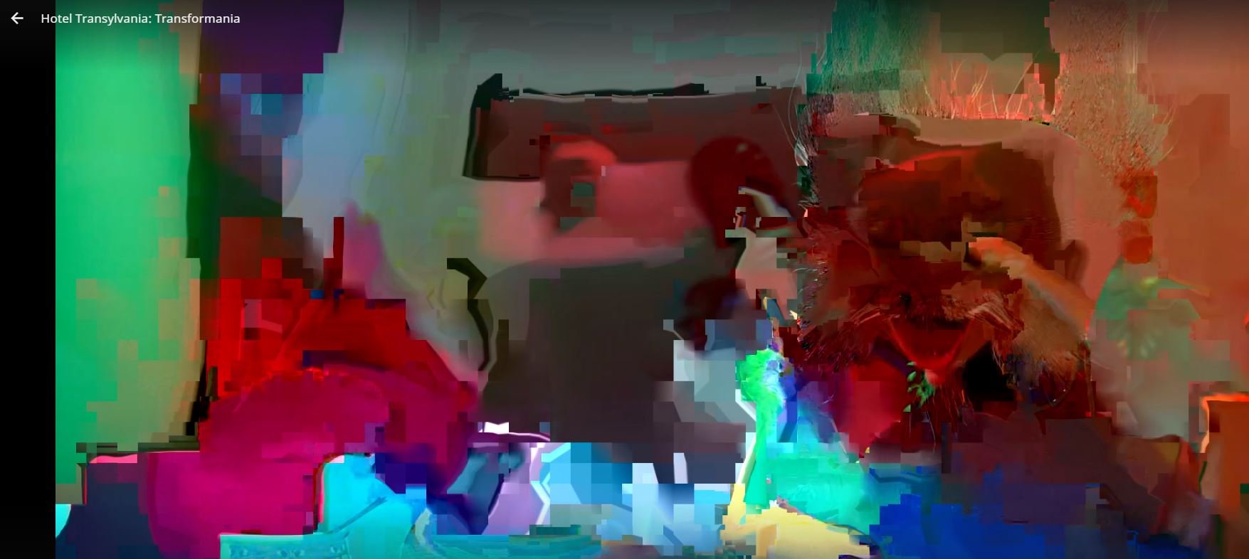

Hey. i'm not able to get my jellyfin encoding working..
Playback Error
This client isn't compatible with the media and the server isn't sending a compatible media format.

Like 98% of my media is H264 / HEVC. Wasnt able to play any media file!
UPDATE
After completly uninstall and manualy removing all config files, I was able to activate decoding. Video Playback seems to be working, but not that right..
Edited by T4s3rF4c3
Is this HDR content?
I'll have to look into this, unfortunately I don't have such a CPU to test this.
Yes HDR content. Encoding is working fine with 1080p H264 SDR but all of my H264 Files have HDR..... :D
I think you are talking about h265?
HDR sometimes won't work correctly on Jellyfin from what I know, anyways I will look into this again and see if maybe something is missing in my container. :)
Thank you very much!
I'm not sure, but video detail display h264..
The source codec is HEVC so to speak h265 ("Originale Medieninformation"), you transcode to h264.
Have you yet tried to play the file on a mobile phone or tablet if the same happens there too?
Nice to know! Thank you!
Same problem on phone and tablet.
I will look into this but can't tell for sure if I can fix it.
EDIT: It's currently not supported on AMD, see here: Click
Damn.. so no chance atm to play these videos, unless encoding is disabled.
Seems like that's the case.

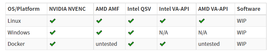

Actually those 1 yrs+ posts are outdated. We have supported HDR10 TM on QSV in the later versions of 10.7.
And with the release of 10.8 (alpha5), both VPP and OpenCL tone-mapping impl got much improved in terms of speed and stability.
Current status of HDR tone-mapping support are as follows:
https://jellyfin.org/docs/general/administration/hardware-acceleration.html#configuring-opencl--cuda--intel-vpp-tone-mapping

Hi @ich777 please can you let me know how to switch from the linuxserver version of Jellyfin to your version? Can I just stop/delete the current one and install yours and point it to the same appdata folder? Will I lose any info?
Edit: I am also getting the choppy video as per @T4s3rF4c3 post above ... it goes away if I disable HEVC transcoding (see attached images)... I am using an Nvidia 1050 TI. Hoping if I switch to your container it will fix this...
Edited by ultimz
