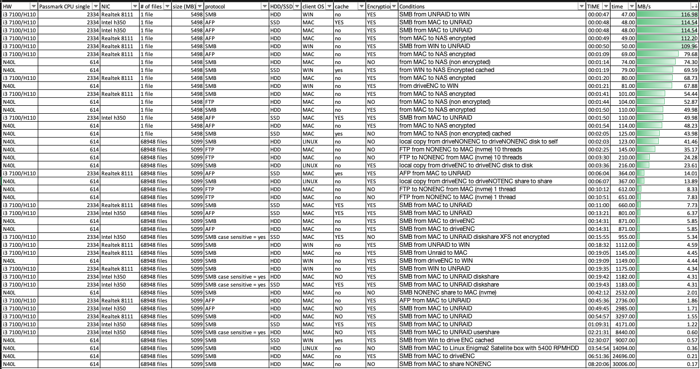

this is my test results table if you want to test something else
my experience is simillar. after few minutes of huray start it chokes to ridiculous speeds with certains protocols or config combinations. still finding the optimal setup.
my setup is way more simple though. i have only 3 SATA drives 2x 4TB ona for parity one for data + 120 GB SSD cache.
the hardware is capable of doing better so the sw is the suspect here.
