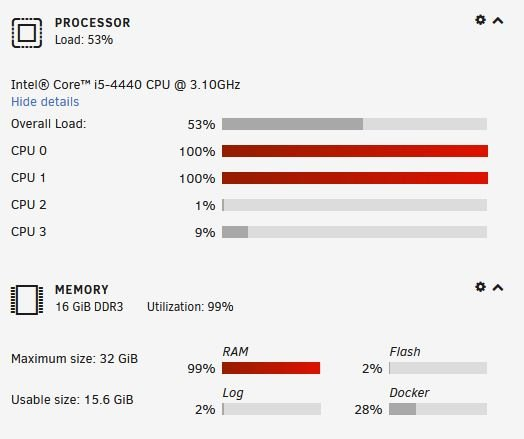

Every so often, maybe once a month my server just seems to get messed up. Looking in the GUI the CPU maxes out (not on all cores), docker containers are unresponsive, memory seems to be all used up.

Diagnostics zip attached. Can anyone help?

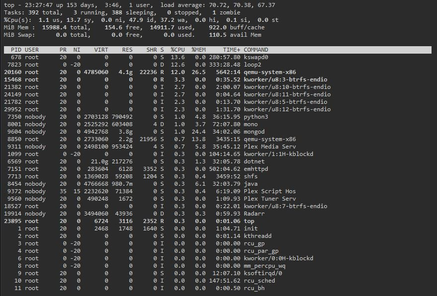

Screenshot of top when its happening:

Sorry to see that no one has replied in here.  One thing that I would ask you to try first is to boot in safe mode, which will disable all plugins.  See if you can recreate the issue there.  If so, stop all VMs and containers and see if you can reproduce the crash.  Then slowly turn services on one at a time until you find the culprit.  Its got to be either a plugin or a container or its very likely a hardware issue.
