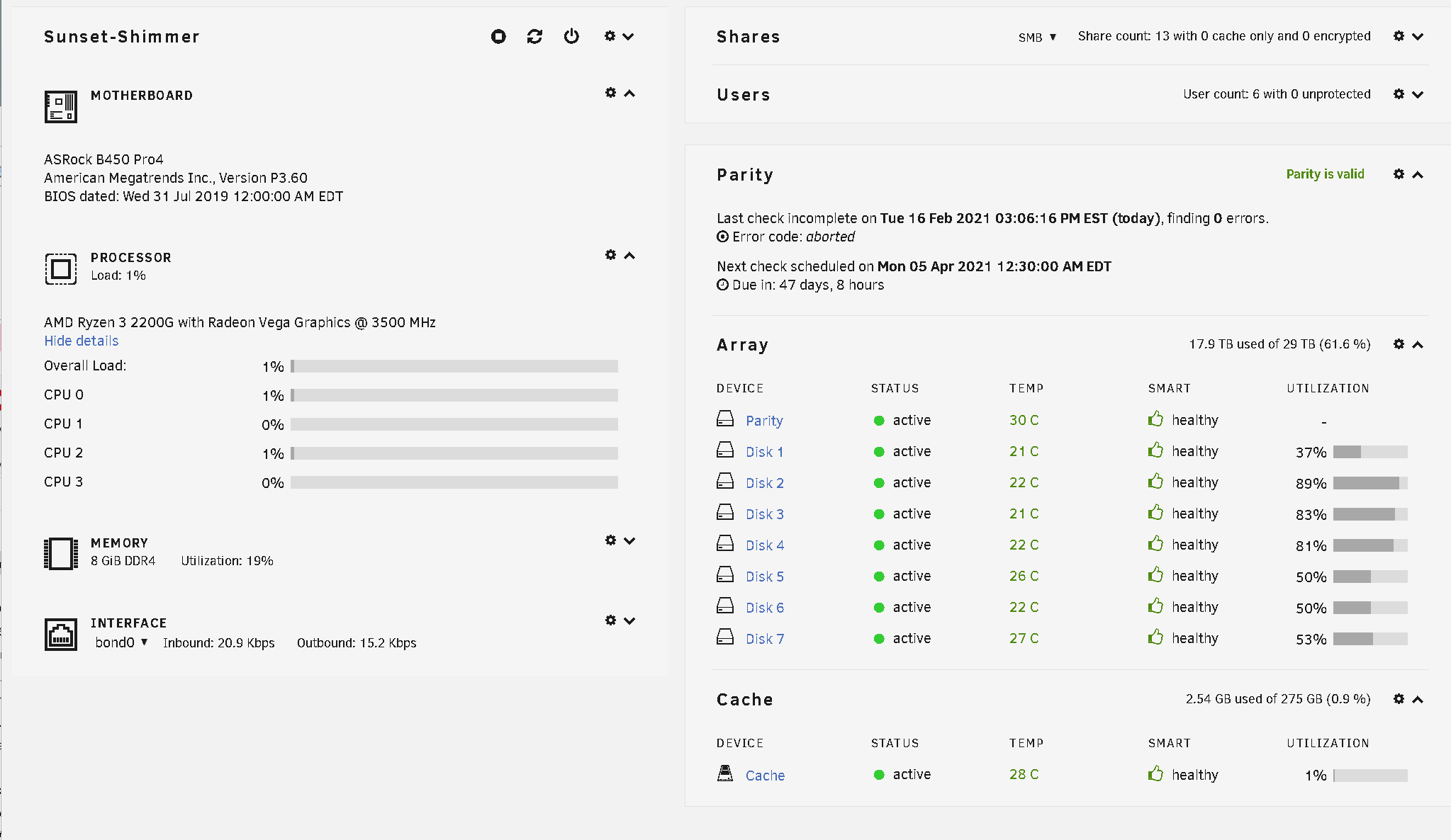

I have 2 unraid servers running similar hardware.
Both run fine but one system becomes unresponsive and requires a reset switch reboot when the scheduled parity check executes.  No obvious hardware errors or "Fix Common Problems" errors.
I've disabled and removed VM and Docker but the hangs persist.
Can anyone suggest a possible fix?
781488796_DashboardScreenshot2021-02-16152936.thumb.png.10d03edf736155b5b90375d297fb7818.png

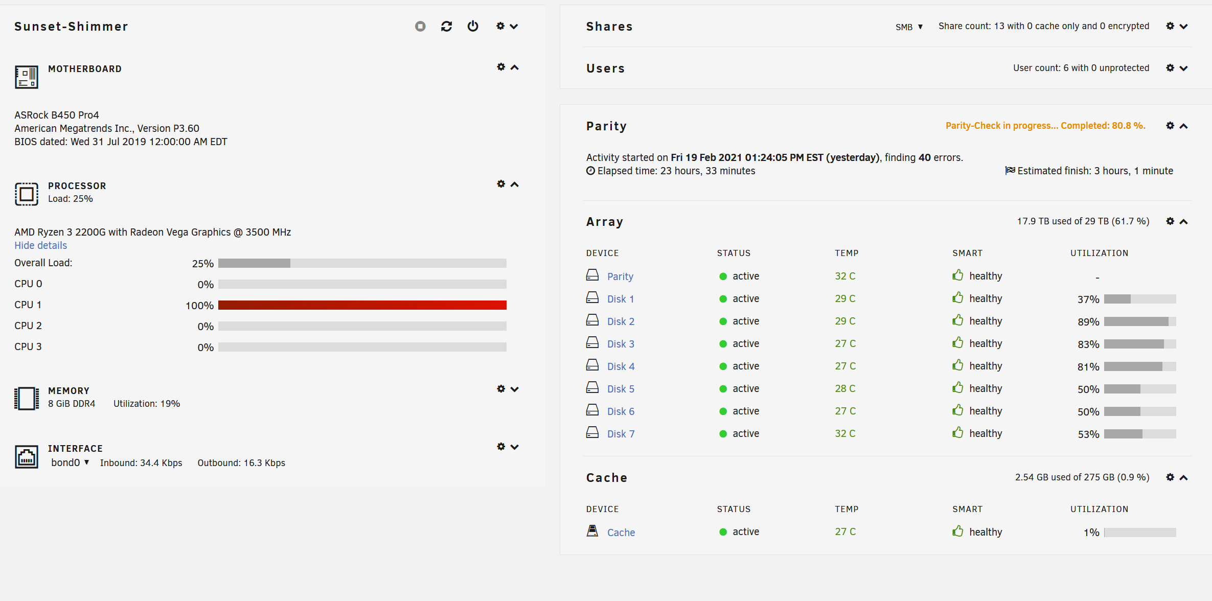

New parity check,
Seems to have hung at 80% this time.
I've attached the tail of the system log.  Is that a SAS controller error?
System Log Tail.txt
