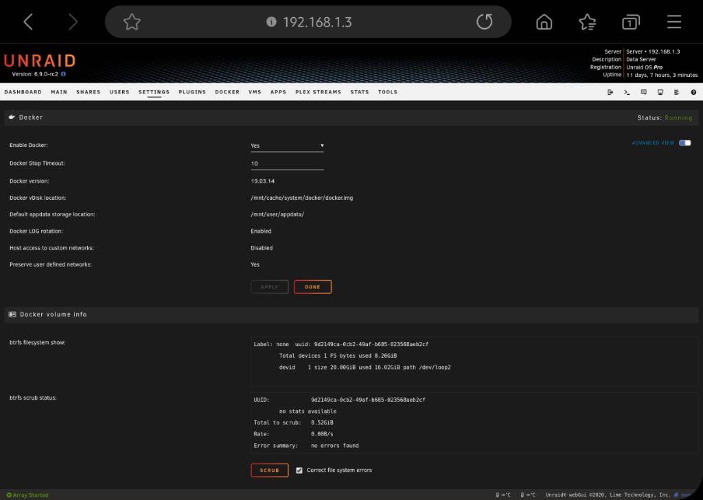

If course would like to get to root cause too. Screenshot_20210216-221357_Samsung Internet.jpg

I think the SSD is dead! But it's showing online but nothing seems to be available in there and appdata share is missing.

Appdata share seems to be missing. If SSD is corrupt surely it should still be visible under shares tab?

Looks like it just dropped offline.  Reseat the cabling.
Shut down, unplugged and replugged SSD.
Unraid showed it as unmounted, after remount I started docker.
All sorter [emoji106]
Cable wise everything looks fine, might just order another SATA cable just in case.
