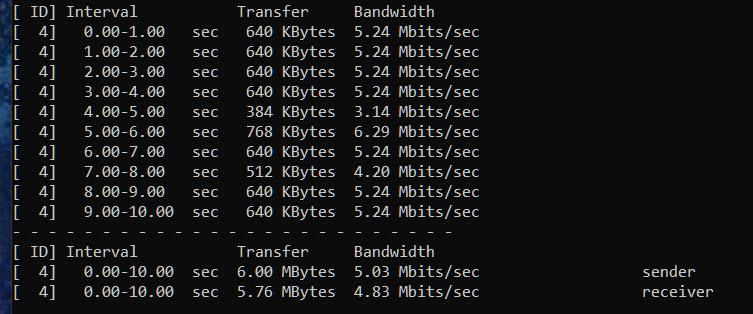

I'm having issue of really slow transfer speed between win10vm with dedicate nvme passthrough and unraid array
tested with iperf and i got around 5Mb/s from vm to array. but got normal speed from other laptop.

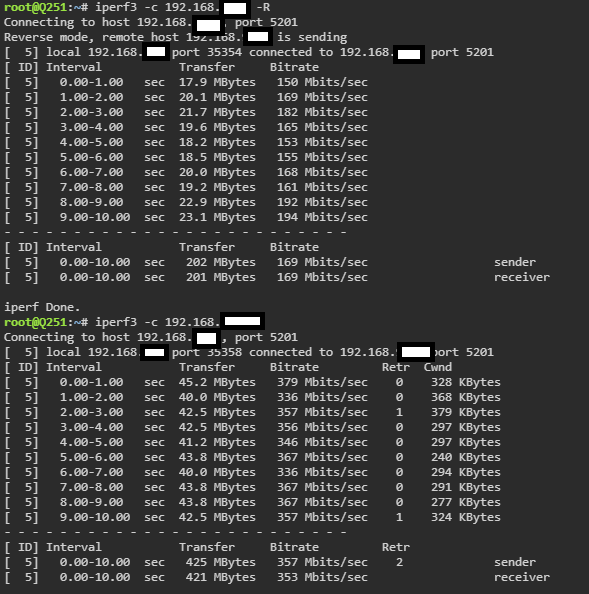

Pls enable Windows firewall ICMP ( default is disable ) and provide the ping response time for ref.
Below is a test on a low-end ATOM J1900 system which host Win10 VM, ping result always less then 1ms, file transfer also reach 1Gbps. But Iperf result show 300Mbps only. ( All test direction was Unraid to VM )
64 bytes from 192.168.9.19: icmp_seq=234 ttl=128 time=0.706 ms
64 bytes from 192.168.9.19: icmp_seq=235 ttl=128 time=0.723 ms
64 bytes from 192.168.9.19: icmp_seq=236 ttl=128 time=0.652 ms
64 bytes from 192.168.9.19: icmp_seq=237 ttl=128 time=0.685 ms
64 bytes from 192.168.9.19: icmp_seq=238 ttl=128 time=0.970 ms
64 bytes from 192.168.9.19: icmp_seq=239 ttl=128 time=0.903 ms
64 bytes from 192.168.9.19: icmp_seq=240 ttl=128 time=0.791 ms
64 bytes from 192.168.9.19: icmp_seq=241 ttl=128 time=0.635 ms
64 bytes from 192.168.9.19: icmp_seq=242 ttl=128 time=0.804 ms
64 bytes from 192.168.9.19: icmp_seq=243 ttl=128 time=0.575 ms
64 bytes from 192.168.9.19: icmp_seq=244 ttl=128 time=0.585 ms
[ ID] Interval           Transfer     Bitrate         Retr  Cwnd
[  5]   0.00-1.00   sec  41.2 MBytes   345 Mbits/sec    0    254 KBytes
[  5]   1.00-2.00   sec  36.2 MBytes   303 Mbits/sec    0    382 KBytes
[  5]   2.00-3.00   sec  41.2 MBytes   345 Mbits/sec    0    342 KBytes
[  5]   3.00-4.00   sec  44.8 MBytes   376 Mbits/sec    0    319 KBytes
[  5]   4.00-5.00   sec  38.6 MBytes   324 Mbits/sec    0    314 KBytes
[  5]   5.00-6.00   sec  44.8 MBytes   376 Mbits/sec    1    311 KBytes
[  5]   6.00-7.00   sec  43.6 MBytes   366 Mbits/sec    0    282 KBytes
[  5]   7.00-8.00   sec  39.9 MBytes   335 Mbits/sec    1    282 KBytes
[  5]   8.00-9.00   sec  39.9 MBytes   335 Mbits/sec    1    342 KBytes
[  5]   9.00-10.00  sec  42.3 MBytes   355 Mbits/sec    0    322 KBytes

Files transfer speed never go above 700KB/s which in line with around 5Mb/s from iperf

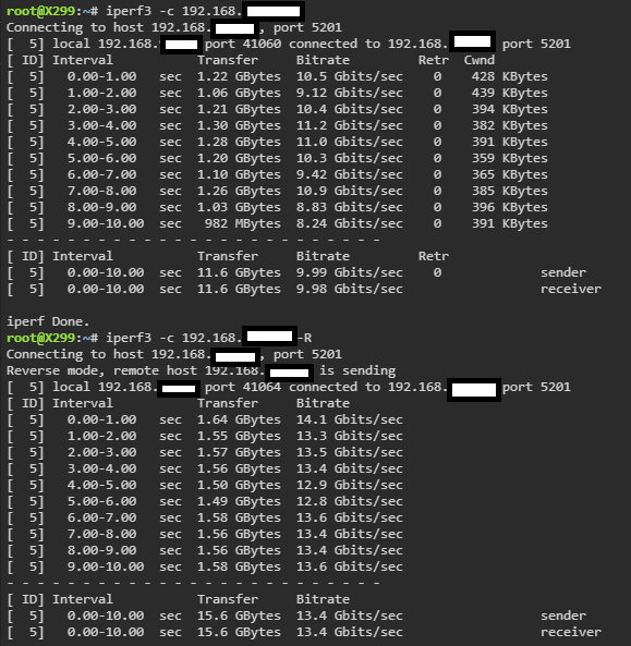

Have similar result if test on low-end system.
But in a high-end system, both direction will be 10Gbps.

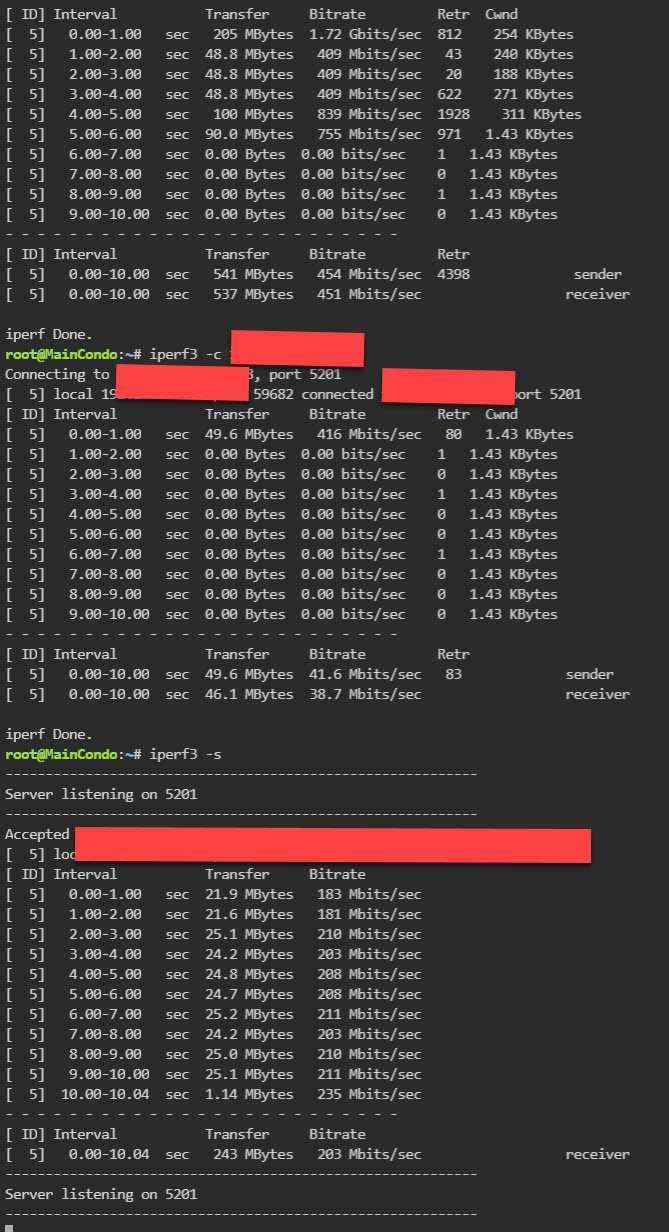

What CPU are you using ?? ( all test was Unraid to self VM )
Edited by Vr2Io
updated unraid to 6.9.0 rc2 and now i got 1-300 Mb/s from vm to unraid.
top 2 are tested from unraid to self VM and bottom one is other way around
My system is 3950x + 64GB ram
