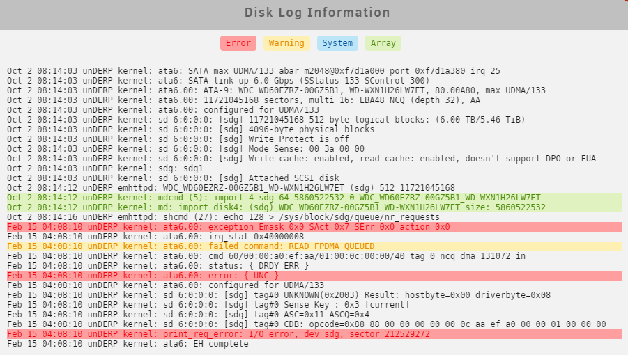

Got this error a couple days ago, should I be worried?
I rebooted the server and got the "back to normal" email. Nothing since. I bought a new drive. Should I replace it, or keep as a spare?

Please post the diagnostics: Tools -> Diagnostics
It's logged as a disk problem, though these can sometimes be intermittent, run an extended test on disk4 and if it passes keep an eye on this attribute:
ID# ATTRIBUTE_NAME          FLAGS    VALUE WORST THRESH FAIL RAW_VALUE
  1 Raw_Read_Error_Rate     POSR-K   200   200   051    -    1
It it continues to increase there will likely be more errors.

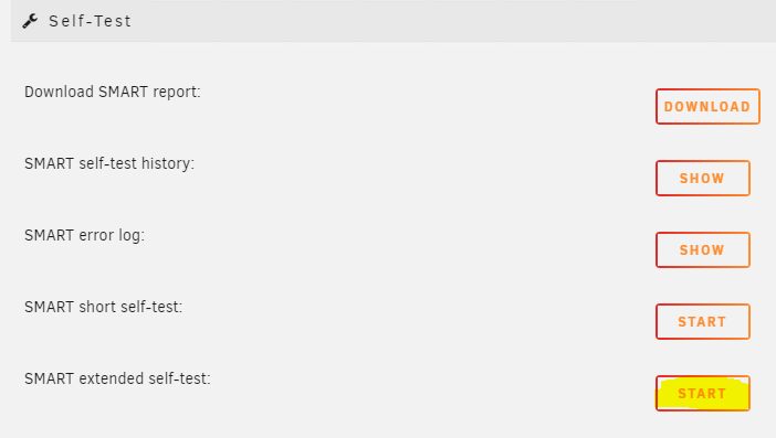

By extended test do you mean like just the WD diagnostics? Or something within unRAID?
You can access that after clicking on the disk on main.
