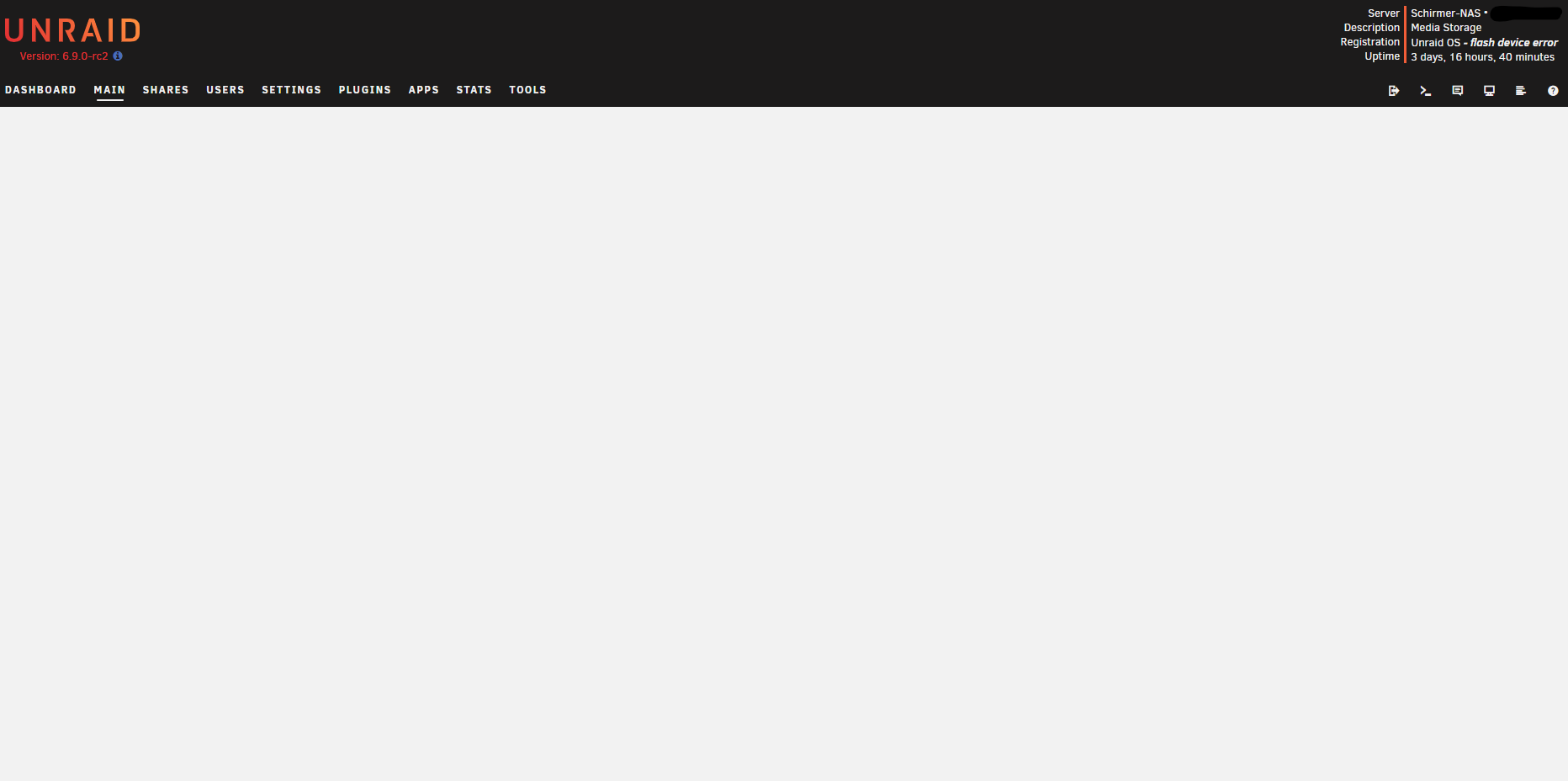

So something weird has happened to my server overnight.
I went to check everything on my server was running well but somehow things have disappeared. First thing I noticed was that my webgui is completely blank, I have the title bar but nothing else. None of the tabs show any info. I could see that next to "Registration" it said "flash device error", so I knew something had obviously gone wrong. The array and all dockers are still online though because I've been able to access Plex, OVPN, etc.

I'm on version 6.9.0-rc2. I've attached my diagnostics and a screen grab of the webgui.

Feb 17 21:02:41 Schirmer-NAS kernel: usb 3-4: USB disconnect, device number 3
Feb 17 21:02:41 Schirmer-NAS emhttpd: error: get_key_info, 542: No such file or directory (2): opendir: /boot/config
Feb 17 21:02:41 Schirmer-NAS emhttpd: Unregistered - missing key file (ENOKEYFILE2)
Feb 17 21:02:41 Schirmer-NAS kernel: usb usb3-port4: couldn't allocate usb_device
Flash drive dropped, if using a USB 3.0 port try a 2.0 instead, could also be a failing drive.
