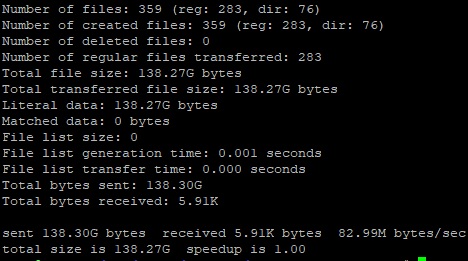

The challenge is that I'm seeing a 2-8 second lag in navigating Unraid menus (that wasn't there at install time).  I'm seeing large transfers between both USB-based drives and between SATA drives more or less maxing at 82M bytes/sec.  My docker images are equally slow.  The only really "unique" setup here is that I'm running most of my docker images through another docker image (VPN), but I'm fairly confident that's setup correctly.  I currently have parity turned off to maximize the transfer of data, and a 1TB SSD as cache.

1 hour ago, sundown said:
USB-based drives
Are you atttempting to use USB drives in the parity array?
No, the parity is a 12TB drive is parity - currently disabled.  Thanks.
I didn't ask if parity disk was USB. I asked if any of the drives in the parity array are USB disks.
Also, parity is not disabled it is invalid because you haven't finished building parity. Of course, parity build is going to impact performance since all data disks in the parity array are being read in order to calculate and write parity.
Nope, that's the extent of the parity, nothing USB.  And you're correct, it's invalid because it's paused due to the fact that I wanted to finish several large copies.
Appreciate the thought, however...
