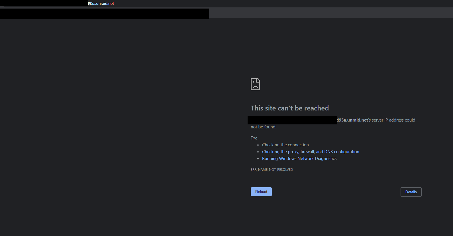

**********.unraid.net not working, showing "ERR_NAME_NOT_RESOLVED"
I am unable to access my server without using its https://"local ip", and using the **********.unraid.net is not working, instead showing "ERR_NAME_NOT_RESOLVED" in chrome.

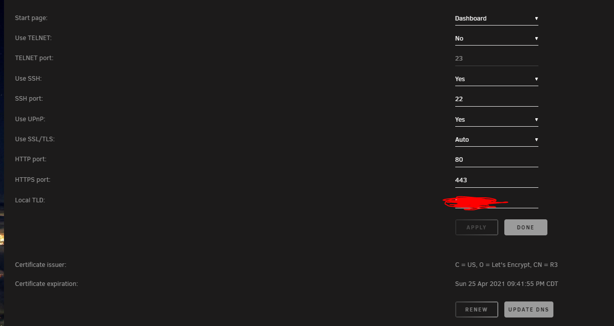

I am unable to hit renew, which I believe would resolve this issue. Any suggestions?
According to the screenshot, the certificate doesn't expire until Apr 2021, so renewing would not help.

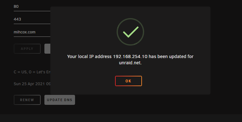

What happens when you press "Update DNS"? Does it show that the correct IP address "has been updated for unraid.net"?
Sorry, IE is not supported by the Unraid webgui. Please use a current version of Chrome or Firefox. Pretty sure a current version of Edge would work too.
No issue, the same is true for chrome/firefox/edge as well. Just wanted to be clear, i can use https://192.168.xxx.xxx fine, but with the .unraid.net it will not load
Chrome:
The Chrome error message shows that your client computer is unable to get an IP address for yourpersonalhash.unraid.net. The most likely cause is DNS Rebinding, although it could be some other local DNS problem.
