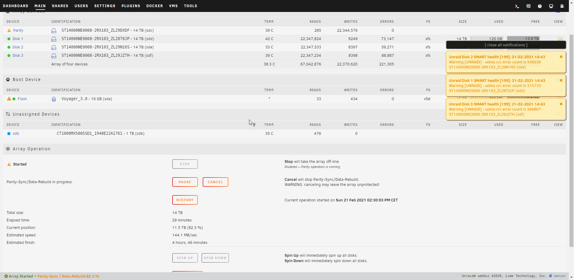

I've added a screen shot of the Main dashboard and devices I have connected. I've also attached the diagnostic zip file as well.

CRC error counts indicate a connection problem - typically the cabling rather than the drive although I must admit I do not think I have ever seen a count that high so I could be wrong.   They are occurring on all 3 drives so that suggests to me that there has to be something that is common to all 3 drives that is causing the problem.
Thank you both for your help! Seems like upgrading the LSI FW and BIOS by follwoing your guide JorgeB fixed the issue. I've now restarted the parity sync and it's about 12% complete without any errors. Thank you again.
