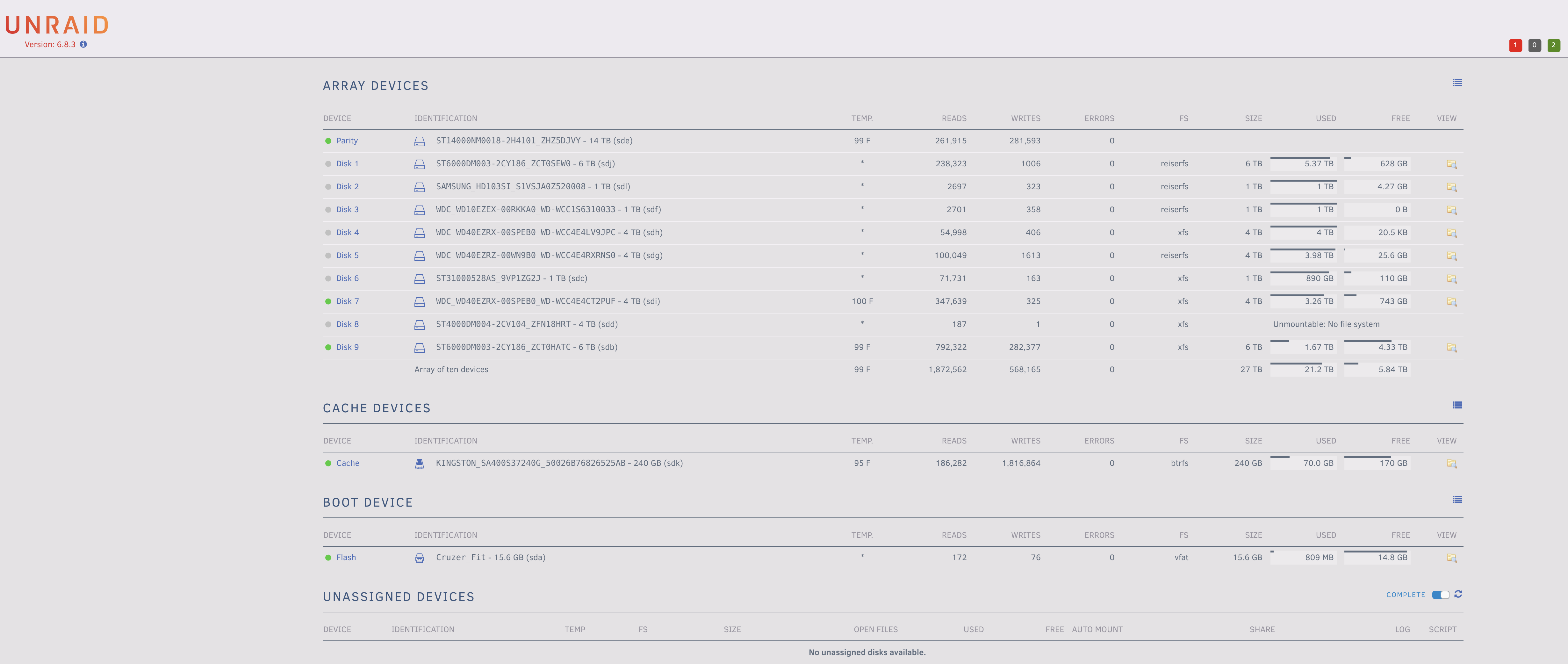

4TB drive suddenly unmountable w/no filesystem (XFS). Was 75% full.
I know there are tons of similar posts, but my log analysis skills are rusty, and the number of red trash can icons in Plex make me not want to screw this up. I'm hoping an expert can give me a set of steps; good or bad news.
I don't recall any unplanned shutdowns. Since I noticed this, parity check with corrections has run.
Thanks in advance,
Chris

Yes - and if it asks for it use -L.  The file system should then be mountable when you restart the array in normal mode.   I would expect all files to then show up.
Well, I've lost it completely. All that was run on a functioning drive #7, not the unmountable #8. Here's what we get when we check the actually problematic one. Anything here that would preclude dropping the -n flag and going for the repair? Something tells me it will be repaired but not without some lost files. Also, if anything stands out to you here as the biggest red flag, letting me know would be educational.
Thanks for stepping in a on a Sunday and walking someone who somehow kept this growing and running for 12 years without feeling the need for this level of handholding. Just a slew of personal disasters lately and I'll ask the dumbest newbie question if it avoids another:

That looks like the drive has a serious level of corruption, and I would expect that many files would not be properly recovered.    Do you have backups of anything important on that drive?
Unraid *is* my backup. (EDIT: Misunderstood the question, but still answered below). I'm guessing there's no way to rebuild this drive from scratch using parity data, because the parity data now reflects this corruption? Is there any way to avoid this in the future? Outside of backing up 14 TB of data to another 14 TB data storage location?
I didn't realize a drive could be so brutally corrupted.
Could a failing system flash drive play a part in this? It's close to 8 years old; that's getting up there for SSD media. The server is plugged into a $400 UPS and we haven't even had a power outage. This is frustrating. But since it's a newer drive It's mostly movies from the past six months. No loss I can't live with hopefully.
Edited by crusho
Addition
You can try running the recovery but no idea how well the recovery will work.   Unfortunately parity never helps with file system corruption as they operate at different levels.    It is a bit worrying if you got corruption without any obvious cause and/or trigger.   It suggests that there may be some underlying problem that could occur again.
problems with the flash drive should never affect the contents of the array drives.
there is no way to guarantee that this will not happen again.  UnRaid should not really be considered a backup for anything important - it is about high availability and protection against drive failure but cannot guarantee that data loss cannot happen - particularly if something goes wrong that means corrupt data gets written to a drive.
All good to know. Also why it's 99% a server for semi-disposable media. If I lose my copy of Iron Man 2, I'm not going to lose any sleep. Client data, photos, etc don't get stored there.
Thanks again.
