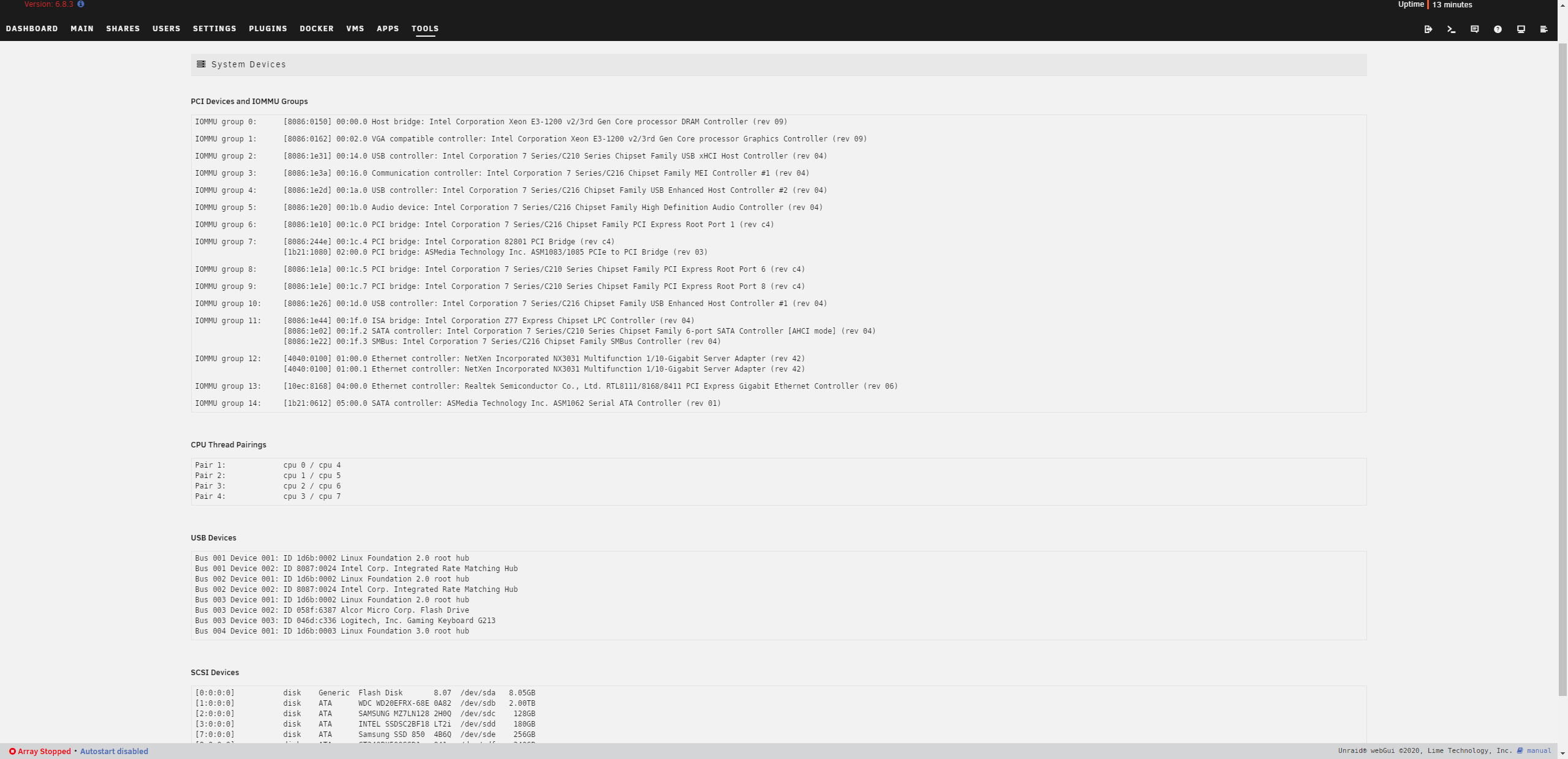

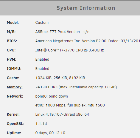

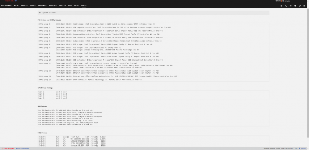

i just installed my "new" Networkcard SFP+ , it´s from an OLD Hp Server. From what i found out, through reading Forum Post´s it seems the Driver for the Device is missing, since i´m unable to Assign IP Adresses or even see the Device as additional ETH Interface.
I will Attach Screenshots and Diagnostics. Maybe we can Find a Solution or this Post is for the Mail to Unraid, but i want to be sure, thats the Issue first.

Driver is there, but NICs are failing to initialize:
Feb 22 11:55:54 Chuncklord kernel: netxen_nic 0000:01:00.0: Error getting board config info. Feb 22 11:55:54
Chuncklord kernel: netxen_nic: probe of 0000:01:00.0 failed with error -5 Feb 22 11:55:54 Chuncklord kernel: netxen_nic 0000:01:00.1: 2MB memory map
Feb 22 11:55:54 Chuncklord kernel: netxen_nic 0000:01:00.1: Error getting board config info.
Feb 22 11:55:54 Chuncklord kernel: netxen_nic: probe of 0000:01:00.1 failed with error -5
