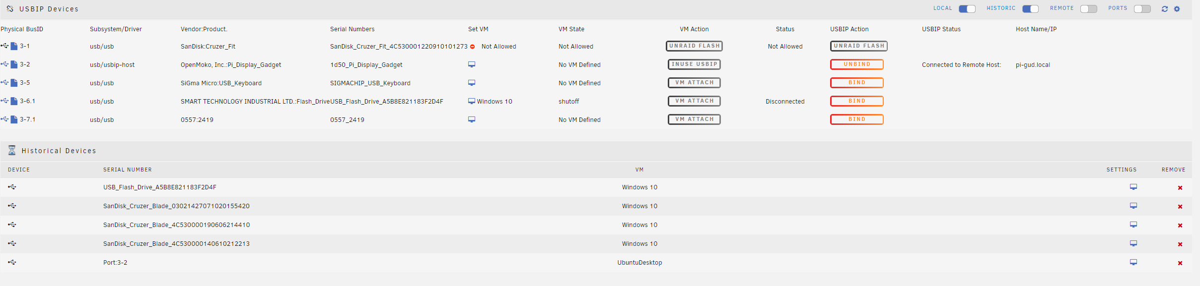

February 22, 20215 yr Nice write up. I am already adding an option to the plugin to set a port to a VM. Specific devices will take precedence if selected over a port. The way I work out device to a port mapping is as follows in the php. #udevadm info -a --name=/dev/bus/usb/003/002 | grep KERNEL== $udevcmd = "udevadm info -a --name=/dev/bus/usb/".$arrMatch['bus']."/".$arrMatch['dev']." | grep KERNEL==" ; exec( $udevcmd , $udev); $physical_busid = trim(substr($udev[0], 13) , '"') ; I have already added icon for the port mapping setting, I just to finish the processing part. Please give my plugin a spin, any feedback is appreciated. The plugin will also add a device into the VM when starts also, which I am planning to do for the port option also.

February 24, 20215 yr 21 hours ago, midgard00 said: I have no experience with php and Unraid plugin development, but I imagine the difficult thing would be to automatically detect ports where currently no device is connected, since there are no folders for those in the directories. I have added support for ports to my plugin. if you connect a device to a port is will should in the GUI then you can add a mapping. Look for unraid usbip gui in Community Apps if you want to try it out.

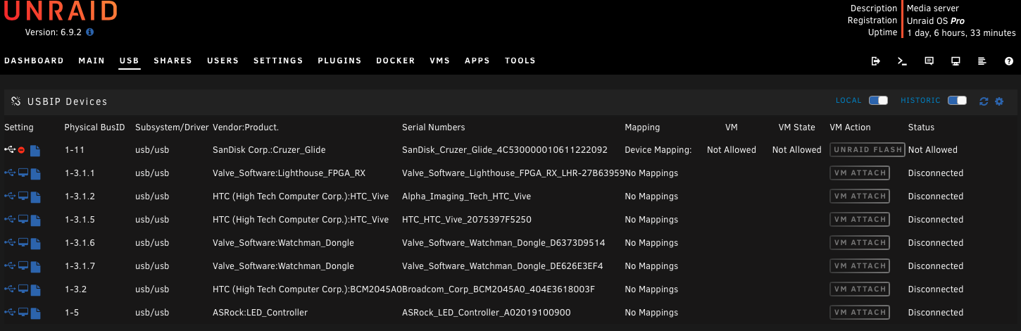

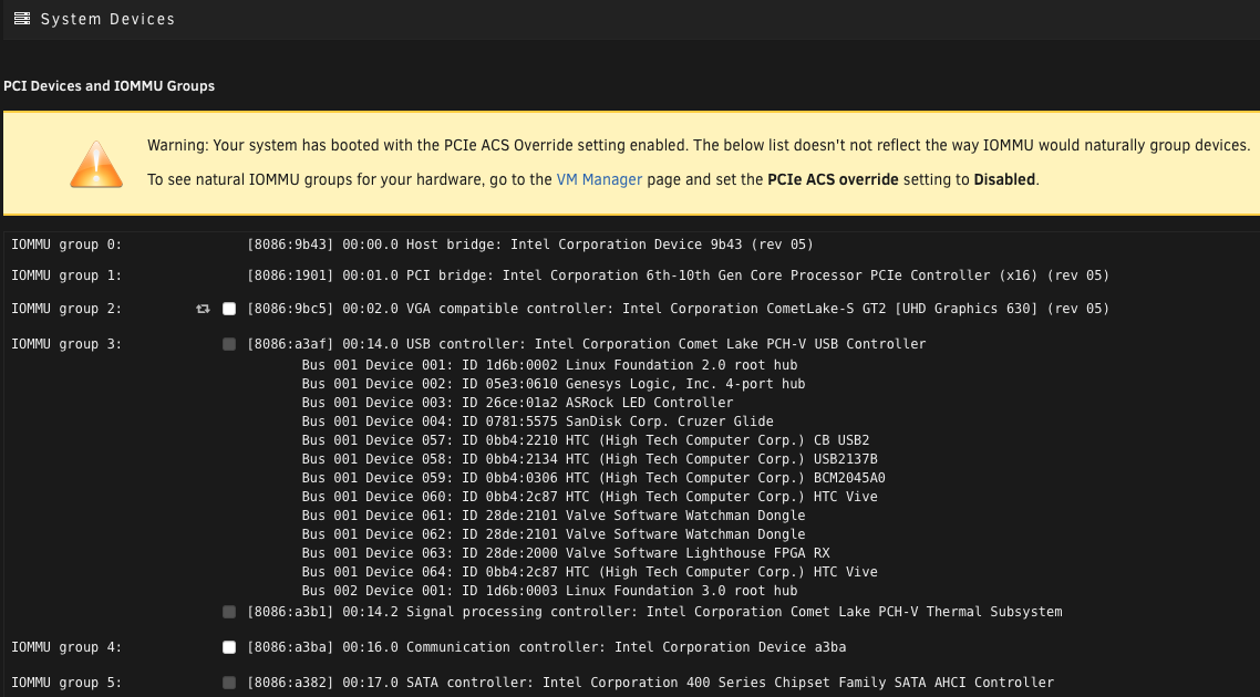

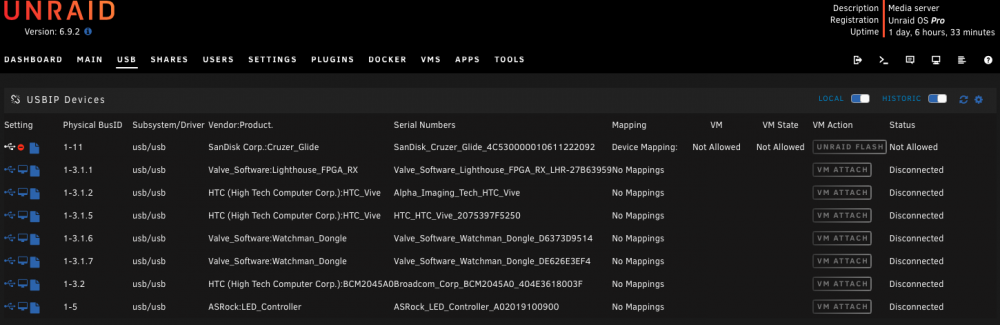

April 17, 20215 yr Hello, first off this plugin is amazing. thank you. I was finally able to passthru my USB devices that came with the htc vive vr headset to my win10 vm however I seem to be missing 2 USB device in the list to map. Unraid sees 8 devices (057 - 064) and plugin only sees 6. probably because of the 2 duplicate devices (061 and 062 have duplicate ID as well as 060 and 064). it's also why steam vr still cannot see the headset. unfortunately I cannot isolate the usb controller into a separate IOMMU group even when adding a 2nd usb pci controller. any suggestion is welcome. thanks again.
April 17, 20215 yr 2 hours ago, Fireblast3r said: any suggestion is welcome. thanks again. Let me have a look at the code, If its classed as a USB HUB it will not show. Will reply on the support thread once I have reviewed and tag you.
