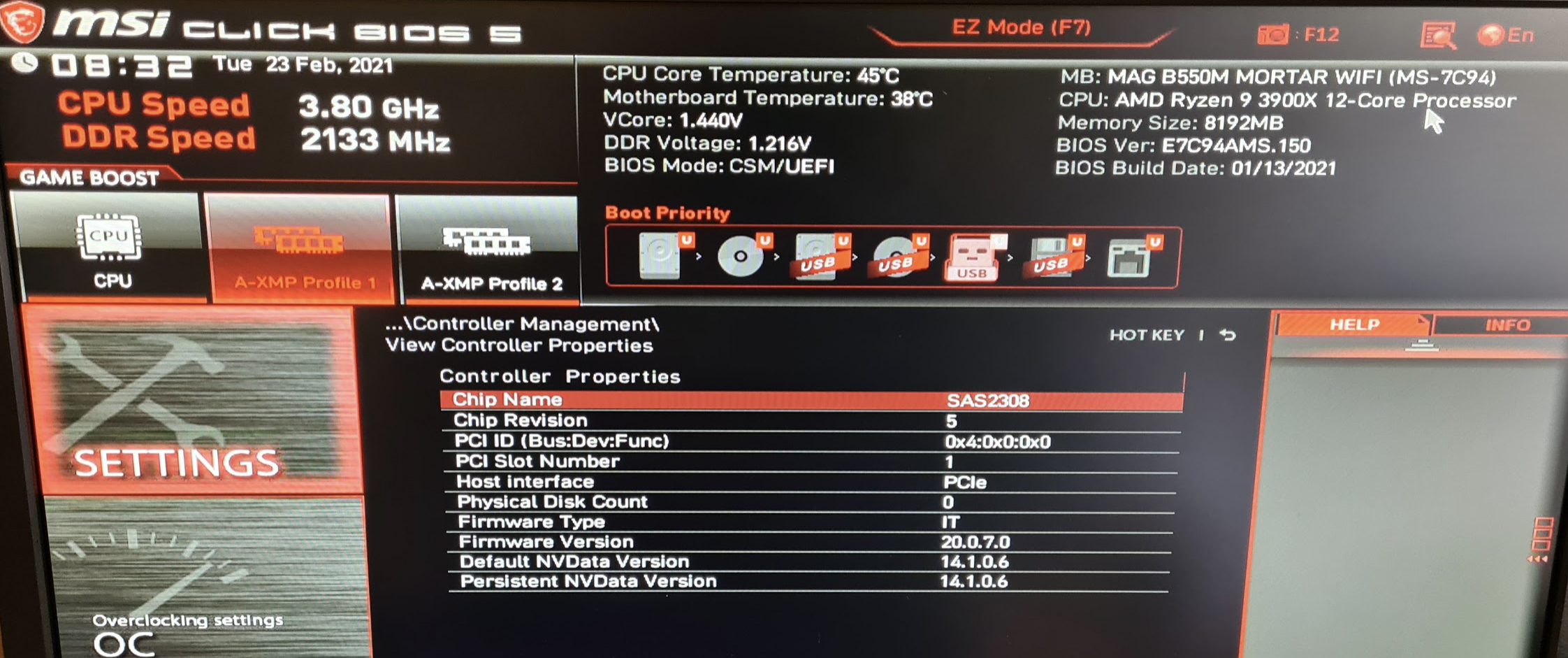

Sorry I am a little confused. When you say HBA do you mean my SAS PCIE card? (Attached SCSI controller: Broadcom / LSI SAS2308 PCI-Express Fusion-MPT SAS-2 (rev 05))
The Ebay listing for it says "FLASHED TO LATEST LSI P20 IT MODE FIRMWARE" so I assumed I do not need to update it, and I am not even sure how I would go about updating it either. I found a forum post on google about my card from May 2020 saying that the latest firmware is 20.0.07.0, and that is what my card says it is running in BIOS.

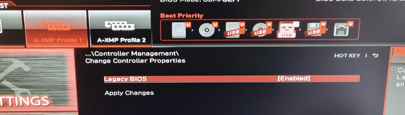

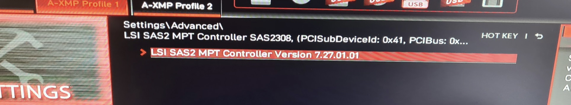

I took a few photos in BIOS of the SAS card, in case any of this information is useful to someone who might know if this is the latest version of the firmware etc.

Looks like the LSI board has the appropriate version of FW :
Feb 22 19:46:19 Tower kernel: mpt2sas_cm0: LSISAS2308: FWVersion(20.00.07.00), ChipRevision(0x05), BiosVersion(07.27.01.01)
My bad, HBA have latest firmware version.
