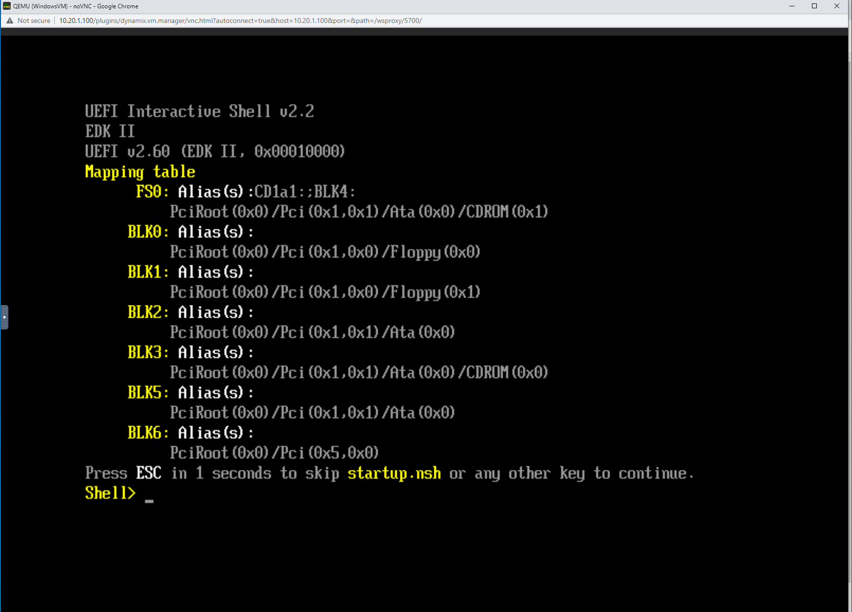

So I disabled the VM settings in order to delete the libvirt.img and once I restarted it libvirt was recreated.  I have done that a few times.  VNC now connects but the attached is what it shows.
Do you see press any key to boot from CD when you start the VM? or have you already re-built it?
type reset to reboot at the shell prompt, and see if the press any key comes up. Maybe VNC didn't come up quick enough for you to see.
Turns out the CD Drive in the template got changed from SATA to IDE and not it seems to work find.  I think it woulnt connect to the VNC because my server was being taxed pretty heaviliy with a parity check and the mover running.
