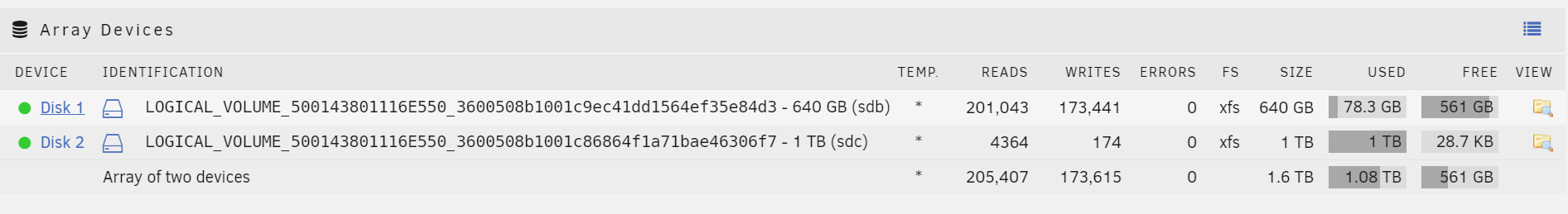

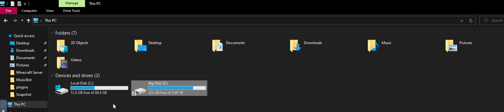

Now the annoying part, I've never had this issue before now, basically what has happened, unraid started pinging me warnings that 2nd disk was full, the one fore media so I cleaned it up a bit, it now stands at 700GB inside the VM.

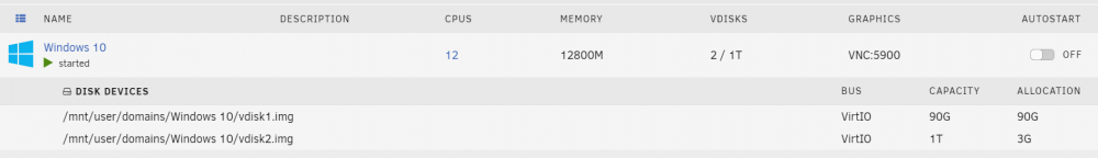

Problem is unRaid is not registering that change and it keeps insisting that the 2nd drive is full to the brim, so when something is being written to the 2nd disk, unRaid pauses the VM and when restarted a bit of progress is gone.
How do I make unRaid understand that the disk is not full?

This should help, but note that vdisks are not in SI units, so it's allocated 1TiB while the disk is only 1TB, and not a good idea to create a vdisk larger than the available space.
