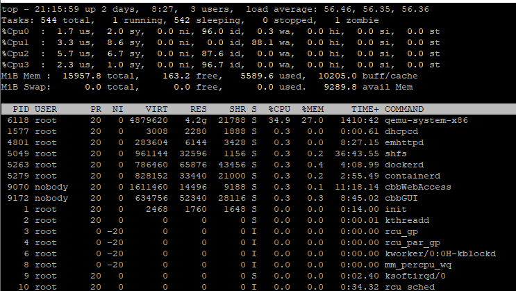

I ran top and then pressed 1 to get the CPUs split out.
Wait time (wa) on CPU1 is sitting at ~95. All other wa numbers for other CPUs is 0.
This is telling me that it has to do with IO somehow. I ran lsof and it never returns either.
