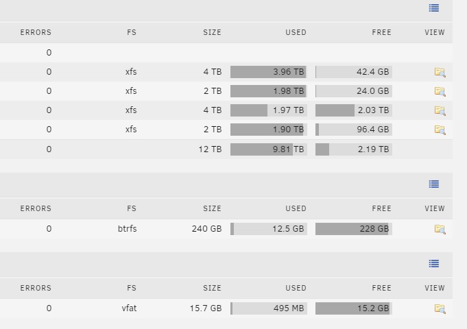

Rebuild completed with no errors. I have attached a screenshot of how the 4 data drives look. The newly rebuilt drive says 3.96TB used but when I click to view what's on the drive there is nothing there.  There are plenty of my files still in the other drives but the shares only show what is stored in the cache drive. I have also attached the latest diagnostic. I never rebooted, this is straight after it has rebuilt disk 1.

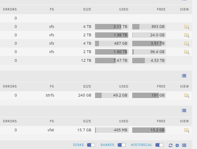

I ran the check on Disk 1 and Disk 3 and everything is working again. Trurl and JorgeB ....and Frank1940,  thank you very much for your guidance with this. I have lost some data but that is to be expected in this situation? I wish there was a way I could buy you guys a beer.
