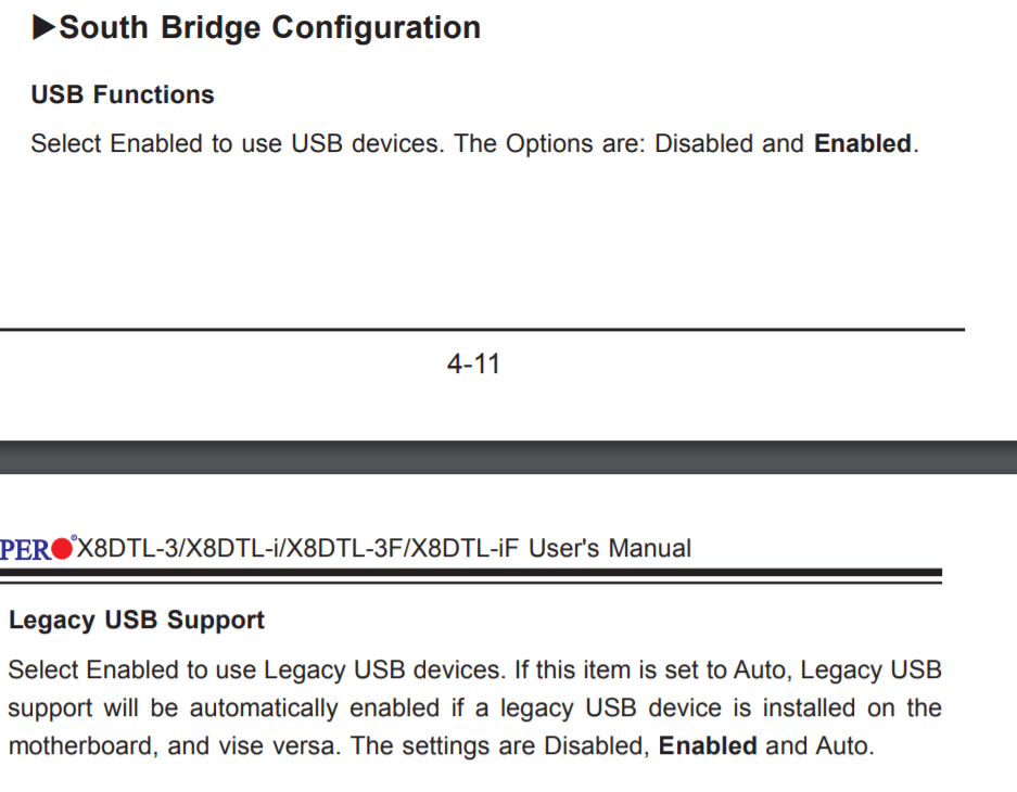

is legacy set to auto in the south bridge conf?
So I messed something up in changing all the BIOS settings and locked myself out of the BIOS because I am using a USB keyboard.  I am going to clear CMOS tonight which should reset all the BIOS settings and hopefully get myself back into the BIOS.  Once that is done I will go through and see if the settings you said to check are correct.
Okay cleared CMOS and set Legacy USB Support to Auto(it was enabled) and still won't boot from any USB.  I feel like this is a complete loss and need to buy a new mobo/cpu/memory.
