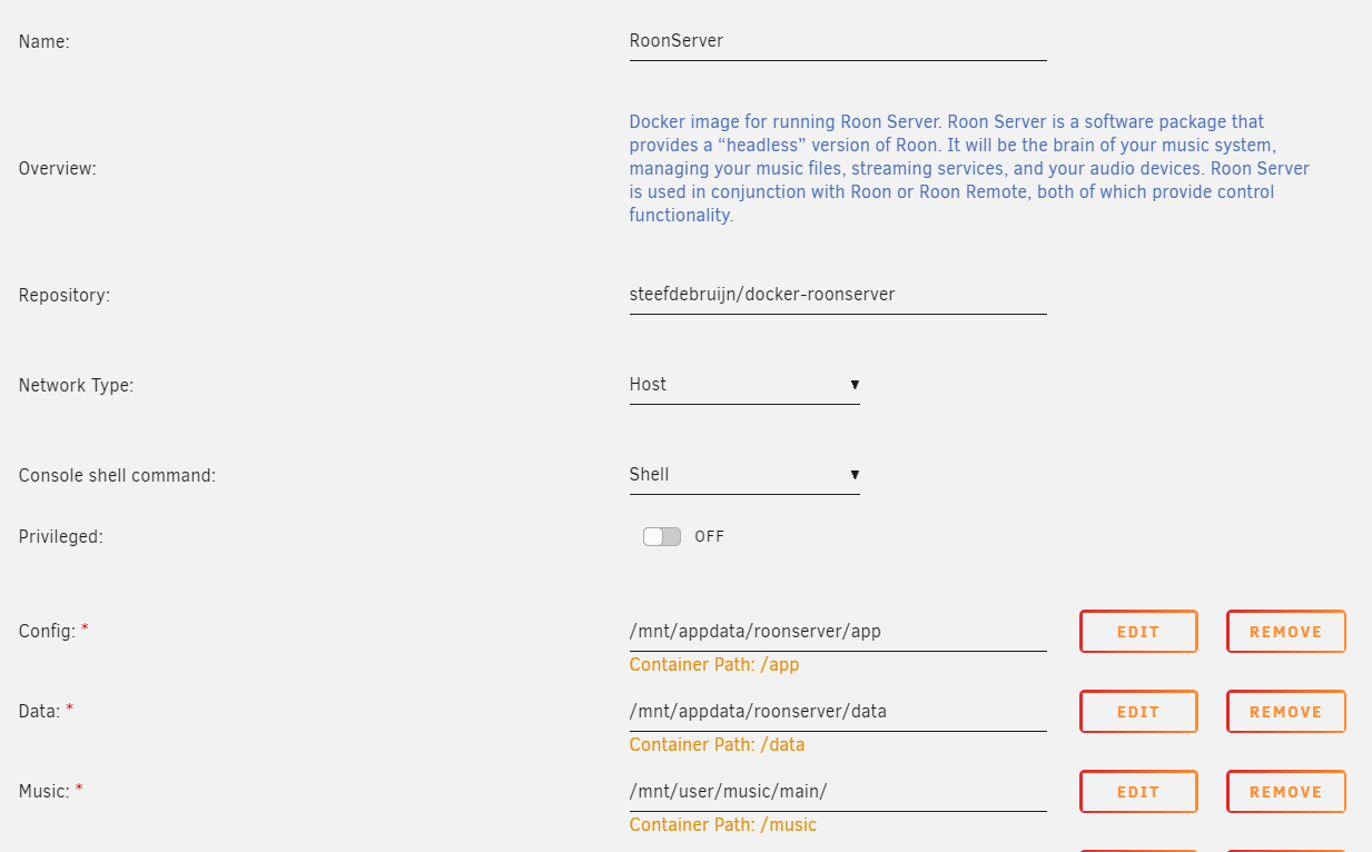

Invalid folder appdata contained within /mnt
Fix Common Problems says:
Generally speaking, most times when other folders get created within /mnt it is a result of an improperly configured application. This error may or may not cause issues for you.
But I thought I was supposed to set my path that way for Roon container as shown in graphic below.
Also I thought
mnt/appdata/roonserver/app    is the same as
mnt/cache/appdata/roonserver/app    since I have my appdata share set to cache only.

In this case it would be /mnt/user/appdata/roonserver/app that is the same as /mnt/cache/appdata/toonserver/app     User Shares always appear under /mnt/user.
Are you recommending it be /mnt/user/appdata/roonserver/app ?  Why?

it should be
/mnt/user/appdata/
or
/mnt/cache/appdata/
not
/mnt/appdata/
/mnt/appdata/ is how your docker is configured as per the screenshot

I think you are all correct.  I look at my other dockers and they are with "user" folder, including appdata.  I will try it.
