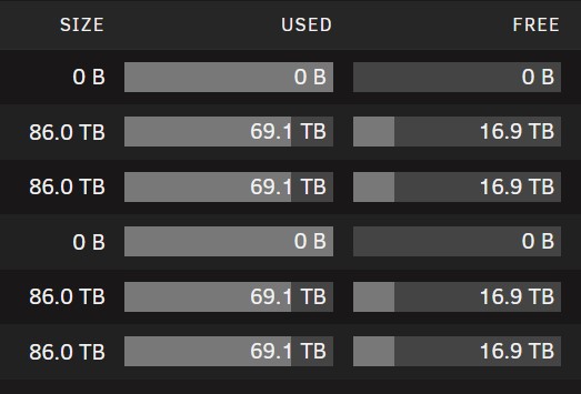

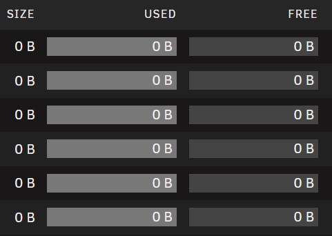

Then I mounted his smb shares via the "add remote smb/nfs share" and they show up, which is good.
I can access all shares and vice versa. Confusingly, some shares show up as USED 0 B FREE 0 B (see screenshots). Sometimes all show up as 0 B, sometimes a few of them, sometimes none. I don't get it, it's completly random.

Diagnostics and screenshots of the remote smb shares is attached!
