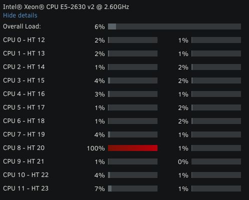

The Dashboard shows one CPU code at 100% all the time. No change. It's been like this for days.

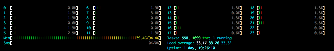

I checked htop and that core is not at 100%. It changes, but is generally low:
I checked my CPU allocations under VMs (/Dashboard/CPUset) and there are only three used VMs and that CPU (8 & 20) is pinned to a Win 10 VM. I paused that VM but it is still stuck at 100% in the WebUI.
Yes, but load average is very high, likely i/o wait and that's what you're seeing in the dash, diags might give more clues.

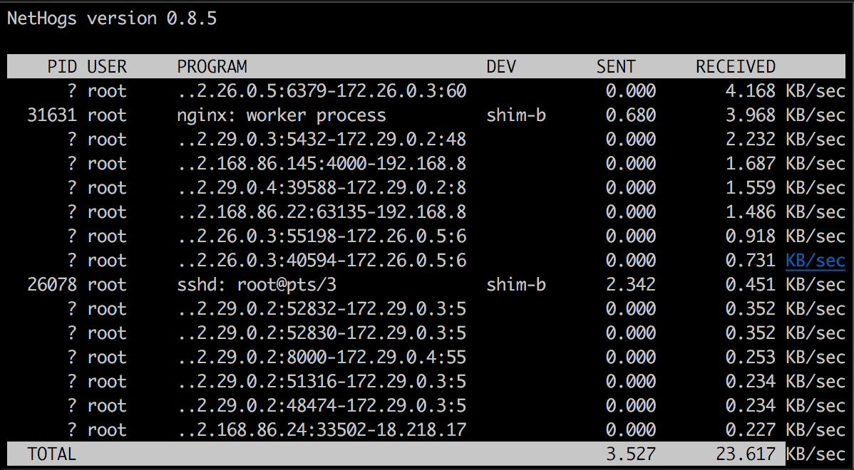

I tried running nethog and it doesn't show a big Network bandwidth usage

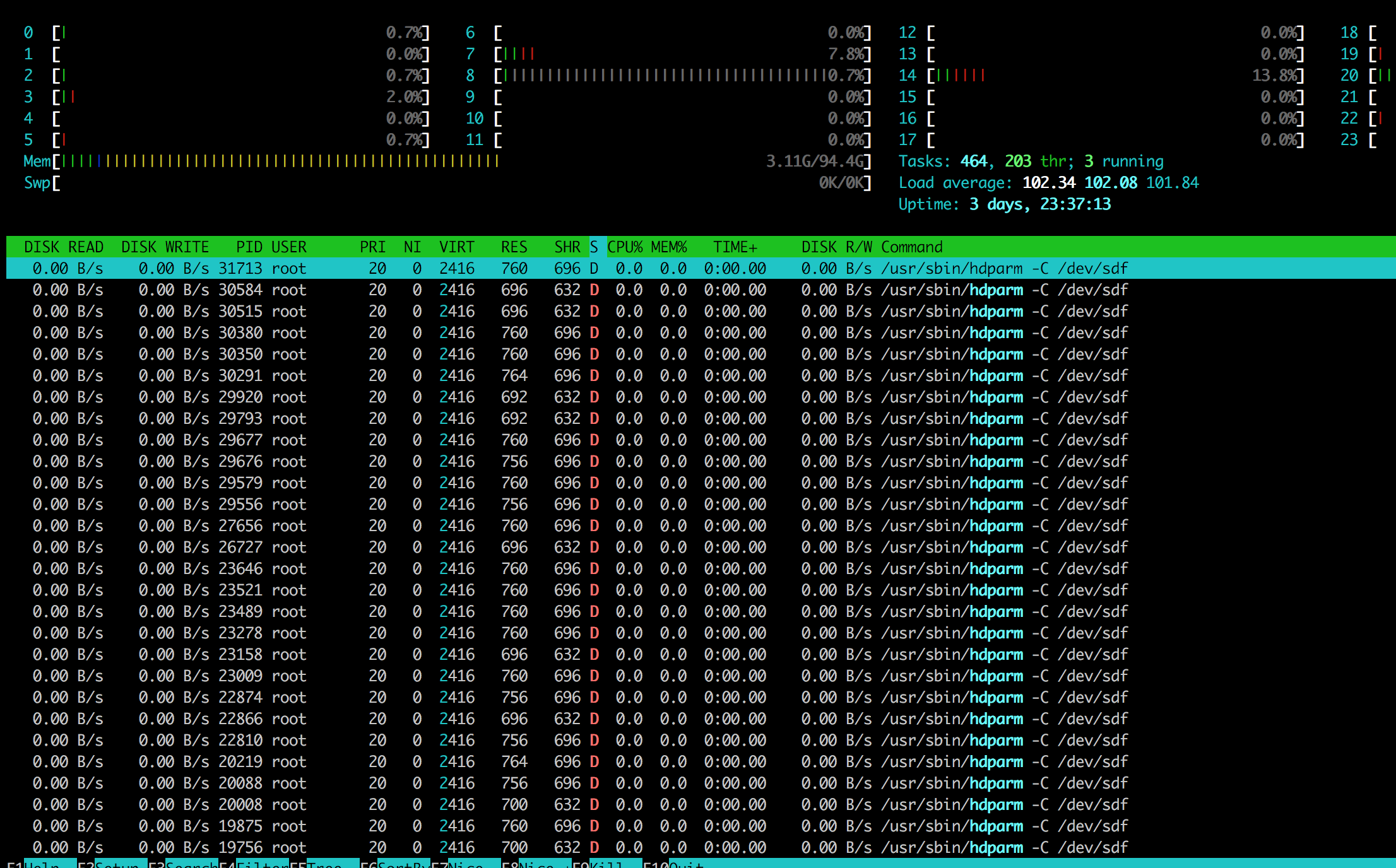

I looked at htop again and it's full of calls to hdparm that are in the D (uninterruptble sleep) state.

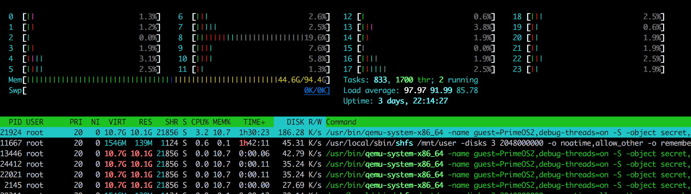

I have one of my threads pegged at 100% usage at all times
Check in top/htop from the CLI and see what process(es) is pegging the CPU.  Is it always the same CPU/thread at 100% or does it move around to a different one?
It is moving around.  It disappeared when i started an experimental VM and when that is stopped, it maxes out a thread again.  I am not running or doing anything on the server atm, just setting things up.

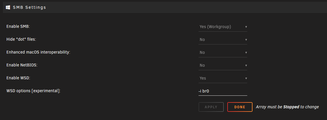

Go to the terminal and type 'top' and see if wsdd is the offending process.  If it is wsdd, go into Settings -->> SMB and either disable WSD if you don't need to use it, or, enter the parameter shown below in WSD Options:
